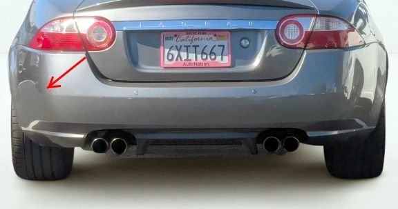

I was (am) also very dubious about the asking price so I searched for the car online … https://www.autonation.com/cars/sajw...xk-series-2009
Aside from the obvious cosmetic problems with the paint and the driver seat leather, I don’t see any glaring issues. Even the Carfax looks good with plenty of regular services listed and only 2 prior owners. If the cosmetics don’t bother you, go for it!

The one I see is a 2009 for $12,495 with 85k.
Yeah, the paint is a bit rough and even several door dings. Other than that though..... who knows? However, it IS VIN identified as a Portfolio with door sills to match. Can't tell about the brakes, photos too dark.

This is one of the first 2009 XKR Portfolios made, as the MFD DATE tag shows 05/08.
It's a base 2009 XKR Portfolio coupe, with no options. It doesn't have Adaptive Cruise or the Alcon Performance Brake package. It has the original Selena wheels, but they've been painted black. The original front grilles (silver painted plastic) appear to have been replaced with chrome mesh but the center emblem is missing. It has the worst paint I've ever seen. Many plastic fasteners are missing from the engine compartment. There are no photos of the spare tire, jack/tools (only Alcon brake cars came from the factory with no spare or jack).
The window sticker says it has "R" logo embossed front headrests, and that the "Selena" wheels have a Shadow finish. Nope, both are wrong. There are no embossed logos and the wheels are now black.
The Jaguar XKR Portfolio coupe is a big cat, but this one's a real dog.

Alight my 2 cents since I know all the shops in the Bay Area. Owner clearly cared about upkeep. Indy shops listed are great (and expensive). Why does a 1 (maybe 2) owner XKR Portfolio (lease, then personal) w a full service history (at expensive Jag Indys) look so dinged up?
Just a guess but maybe inherited and abused, owner's driving skills declined or something. Traded in to Acura dealer for a little cash and washing machine? I'm joking but brand name dealers don't like these cars. Dealer has enough margin that they can sell and make money. Dealer uses the CF value to set the price.
Lots of tire work. At 53 (tires), 61 (tires), 73 (2 tires) and 79 (4 tires).
Water pump was replaced. Does this mean valley hoses were done? SC service? DEF do a PPI. I've owned enough Jags that low price is a flag. Hopefully I'm wrong and it's the deal of the century. Good luck

I’d add, and really surprised Stuart didn’t catch this, both the XK and R logos are missing from the rear.
When a badge is missing on any car, 90% chance the part was replaced / painted and the logos were never put back.
Maybe for $8k this would be a deal, but if the outside looks this bad, can’t imagine they took care of the engine.
And where the chips and missing paint is (mostly lower 1/3rd) would be a good indicator of being amateur tracked. Which also matches up with frequent tire replacement.
Which is fine when one is careful, but when you’re not… this is what you see.

Good point on the badges. Get the impression it was well maintained for years. Someone inherited it and beat on it. My experience is low price Jags end up being the most expensive. Still don't know about valley hoses, SC service, tires, etc, etc. I wouldn't buy it.

It's too bad about the body shape as according to the car fax it had regular services. Maybe the owner lent it out to a rogue nephew.
Looks like someone attempted to cover up the photo with an editor with the gray "brush" stroke on the bottom left of the rear - lmao.
