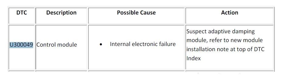

Originally Posted by Ronan1329
Code was U3000-49. ......
Are you sure about that code?
Taken from the DTC decodes in the Workshop Manual.
Ha. I am sure that that's the code written on my dealer paperwork. Seems that that code is for my adaptive headlights....
