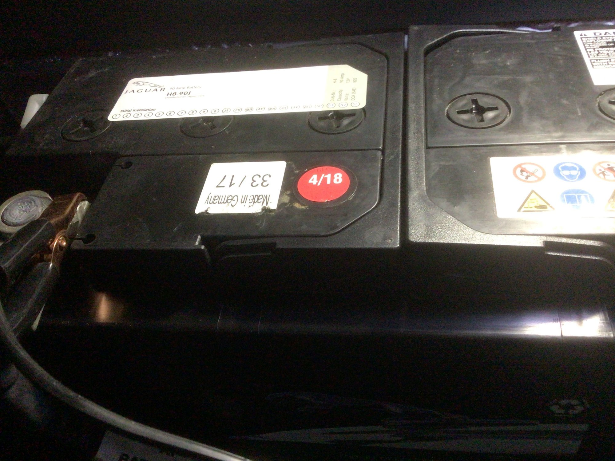

this is the Jaguar battery that is currently installed.

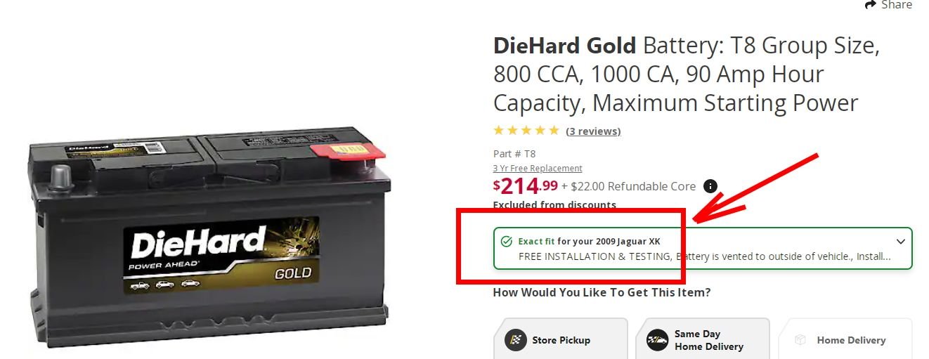

NOTE IT SAYS EXACT FIT:
Its an exact fit because it is the T8 size. It also has the right specs.
