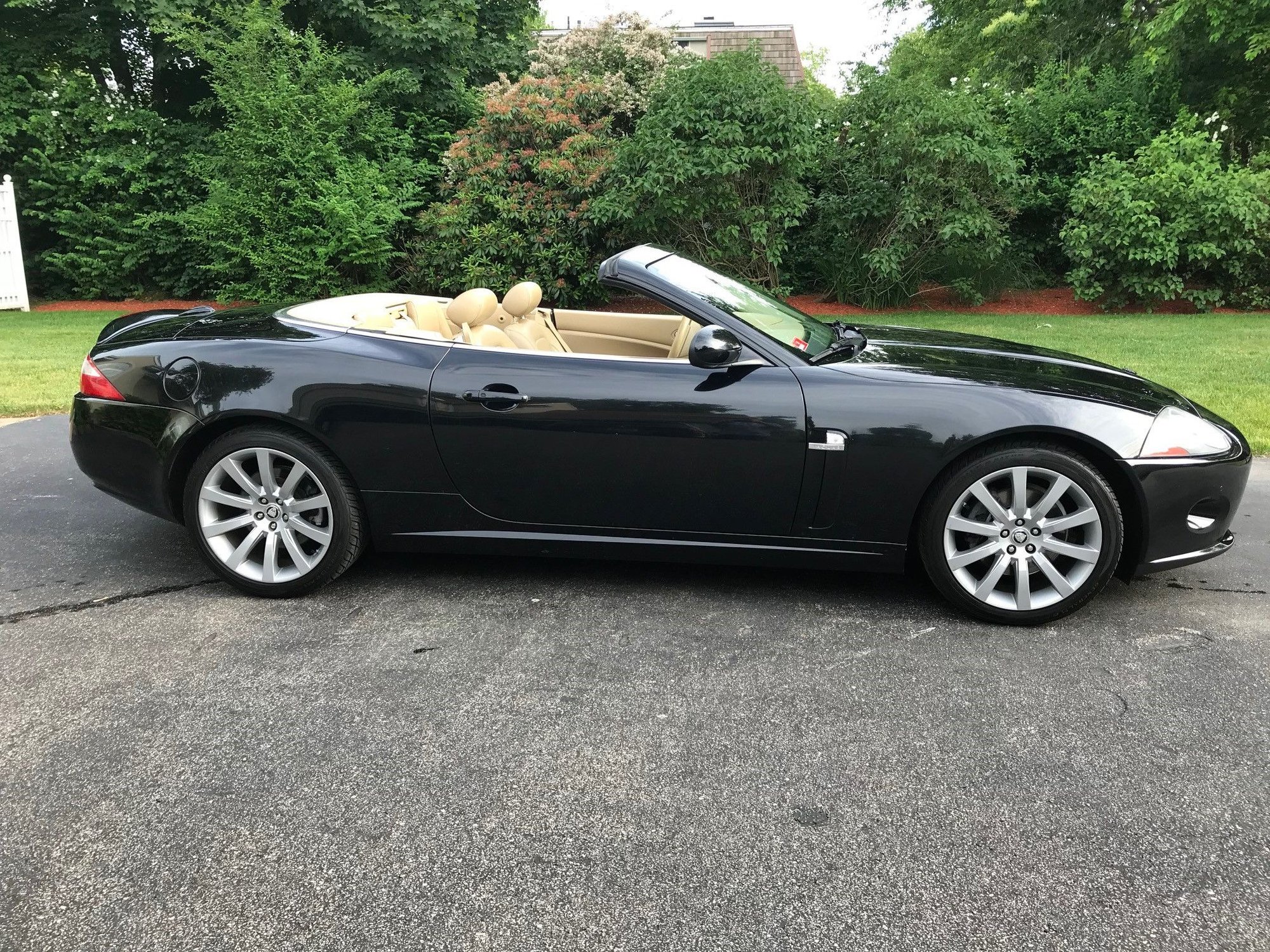

Hello all and thanks for your input. I have a 2009 XK black with tan interior and the steering wheel (all leather) is looking tired. I've cleaned it and cleaned it but it still gets sticky quite easily and it has developed some areas of wear that appear to be the high contact zones. A few questions: ideas on making it look and feel as good as possible? How difficult is it to replace and where's the best place to get a replacement? Is there a wood/leather combination that incorporates the heated steering wheel feature? (Here in Rhode Island we think that is indispensable, especially in the fall and early spring!). Thanks again!
