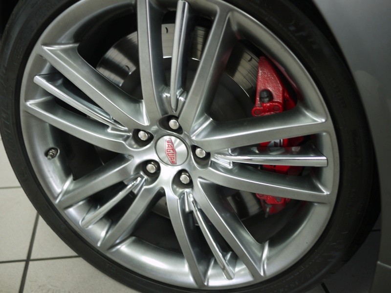

My 2009 XKR Portfolio convertible has the following options: adaptive cruise ($2,300), Alcon brakes ($5,000), black soft top, rich oak veneer, ivory/slate upholstery ($1,000). Here's a close-up of the wheel/rotor/caliper:
Unfortunately, a spare wheel/tire was not available with the Alcon brake option due to the oversized front 6-piston caliper. Instead, you get a can of "fix-a-flat" and a 12v tire pump. The 20" Selena wheels are not compatible with run-flat tires. I keep a bible in the trunk and pray that I don't get a flat. So far, so good!
Correction: Depending on the run-flat tire, Selena wheels may be compatible. Unfortunately, at the present time, TireRack.com does not list any run-flats in OEM sizes. So you may have to increase/decrease tire width slightly to find a run-flat that might work.
Update: Compact Spare is available - see this link: https://www.jaguarforums.com/forum/x...-brakes-67260/
