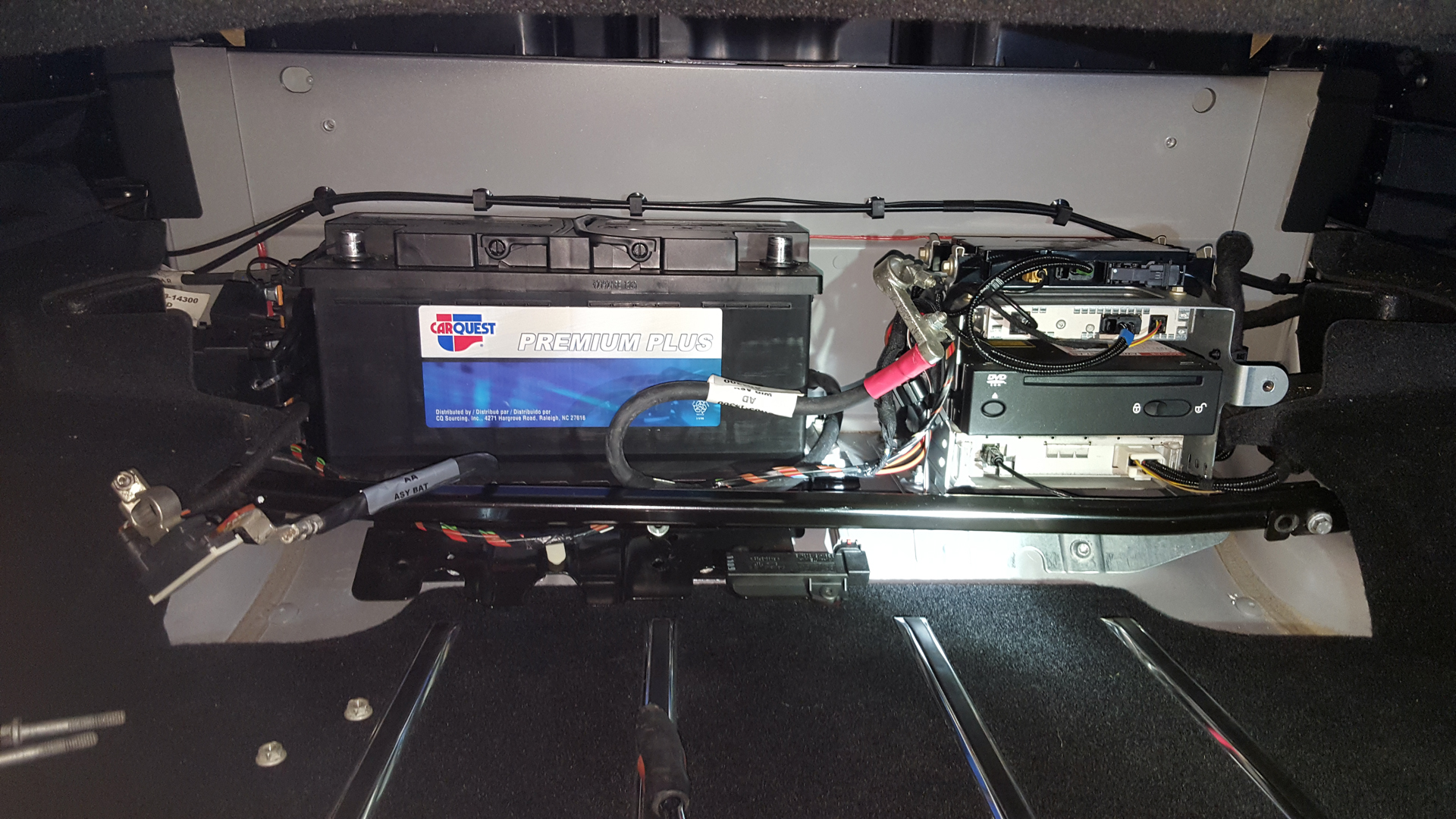

I had the car taken back to the dealer. They agreed to replace the battery with a new one if the one that came with the car was dead. It did read something over 11 volts, but they considered that sufficient to call for a replacement.
. . . it didn't solve the problem. Upon firing up the car with the new battery, at least one error code returned, indicating a problem with the throttle body sensor. They are going to have that looked at by a competent fix agent and have promised to return me a perfectly running car.
The picture shows the guts behind the rear panel in the trunk, where the battery, navigation disc player, and a bunch of other goodies are stored. Suprisingly, the battery that was there was not the original that came with the car.
It shouldn't be surprising; in any car, anything beyond six or seven years on the same battery is both a gift and borrowed time. Considering that our cars chew through batteries like they do tires, it wouldn't be a surprise if you're putting in the 3rd or 4th battery that car has had.
Food for thought: these cars are very, very particular electrically, and there's a good chance that your fault code may have been caused by the low battery and simply needs to be cleared with a scan tool. In the future, try clearing the codes or simply disconnecting the battery for a few seconds to reboot the computers to see if the problem goes away before you pay someone $100/hr to do that.
The dealer replaced the battery at no charge to me, cleared the codes, etc.. After replacing the throttle body, they found that the ECU was still throwing codes. So now the car is at the Jaguar dealer in Scottsdale for further investigation and repair. It would be nice if it was just a matter of reprogramming the ECU and not having to replace it entirely, but either way, I was thinking ahead and purchased a full service warranty for the car. At worst, I will be out the deductible, and I think the original dealer will be picking that up since the problems began so soon after I bought the car.
As for being surprised about the battery having been changed? I guess it would be no surprise if a previous owner paid to have it done. When I saw what was required just to remove the battery, I was quite pleased that I didn't try to do it myself. Not quite like the old days when changing a battery in a US-made car was barely a 1/2 beer job.
