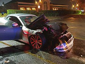

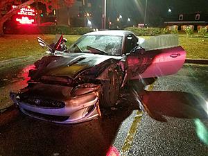

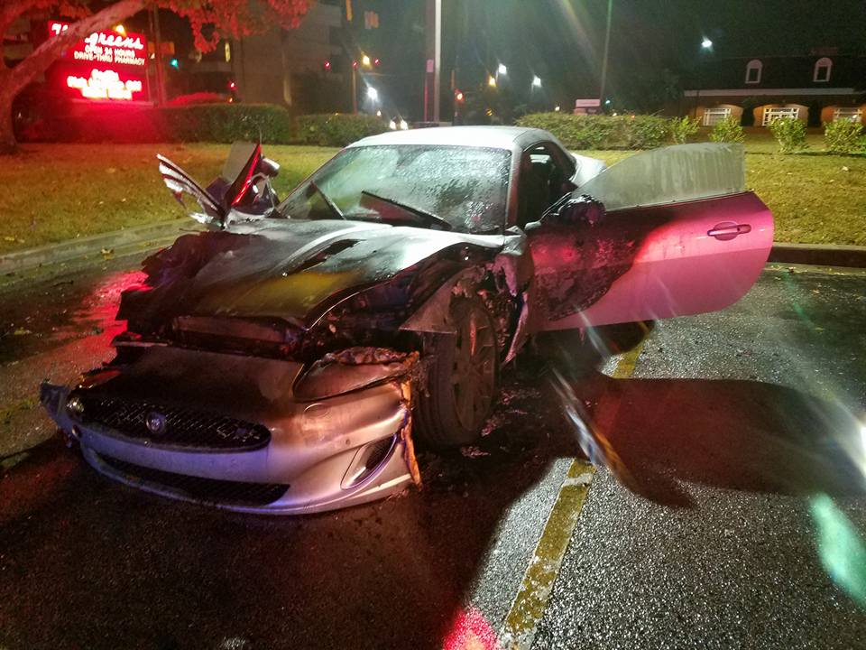

On Friday night a week ago (11/03/17) my 2012 XKR Convertible, 28,200 miles on the clock, suffered an engine fire. I had not driven the car for 5 days and when I got in the car the battery was dead. You guys know that the battery is very hard to access in the trunk area. Per the manual instructions, I used the positive connector provided and grounded to the bolt in the spare tire area in order to jump start with my battery booster / charger. It was a bit difficult to get a good ground, I had to play with the clamp a bit. I jump started the car, let it idle for about 10 minutes, and drove to the local Walgreens about 4 miles away. While parked and running I turned around to get a bag out of the "rear seats". I heard a noise, turned around and the entire engine compartment was in flames. By the time I got unbuckled and tried to get out, flames were shooting up the windshield and drivers side window. Superheated smoke hit my eyes and burned them. I was virtually blind by the time someone in the parking lot helped me away from the car. Ambulance, ER and daily visits to the Ophthalmologist have gotten me back to about 80% vision with blurred vision and some double vision. I have included a couple of pictures of the car. Any ideas as to what happened? the fire may have started while I was driving and raged when I got parked... I don't know.

Looking at the pictures it appears the source of the fire is somewhere behind and above the front driver wheel. It would be interesting to get someone to see if they can find the cause but most likely the insurance company will just total the car Also it would be interesting to see if the jump starter you used melted the starter circuit wires starting the fire and that melted a fuel line causing the rapid growth of the fire. Also does anyone know if JLR approves of using a jump type starter . Good luck
