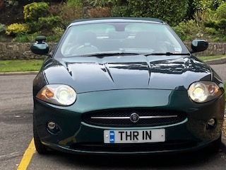

Jaunty's Avatar
Joined: Jun 2020
Posts: 111
Likes: 37
From: Poole
Originally Posted by kj07xk
Got a set of those still in a box in the basement. Had them for quite a few years, just doesn’t get up there on my todo list. Only for the 4.2L XK, not the XKR or later years.
Post some pictures, might motivate me.
[img alt="DRLs turned on in full sunlight; they are BRIGHT! No other lights on.
"]https://cimg6.ibsrv.net/gimg/www.jaguarforums.com-vbulletin/320x240/img_0198_39452e82a7e81125c0b225f1283812cbaef6c11a. jpg[/img]
Fog lights on, with side lights
Headlights and sidelights on
I now leave my headlights on auto, so I always have them on in tunnels, under trees and in the gloaming; when they come on the DRLs (the outer LEDs of the new lamps, in a circle) go off. Whenever the engine is on and the auto headlights are not, then the DRLs come on. And when I want fog lights, as usual I must turn the sidelights on, then turn on the fog light switch and the inner LEDs (in a block) are lit. Gives a lot of peace of mind, including that I won't park and leave my lights on to flatten my battery.
I rate them as excellent, and good value for money.
