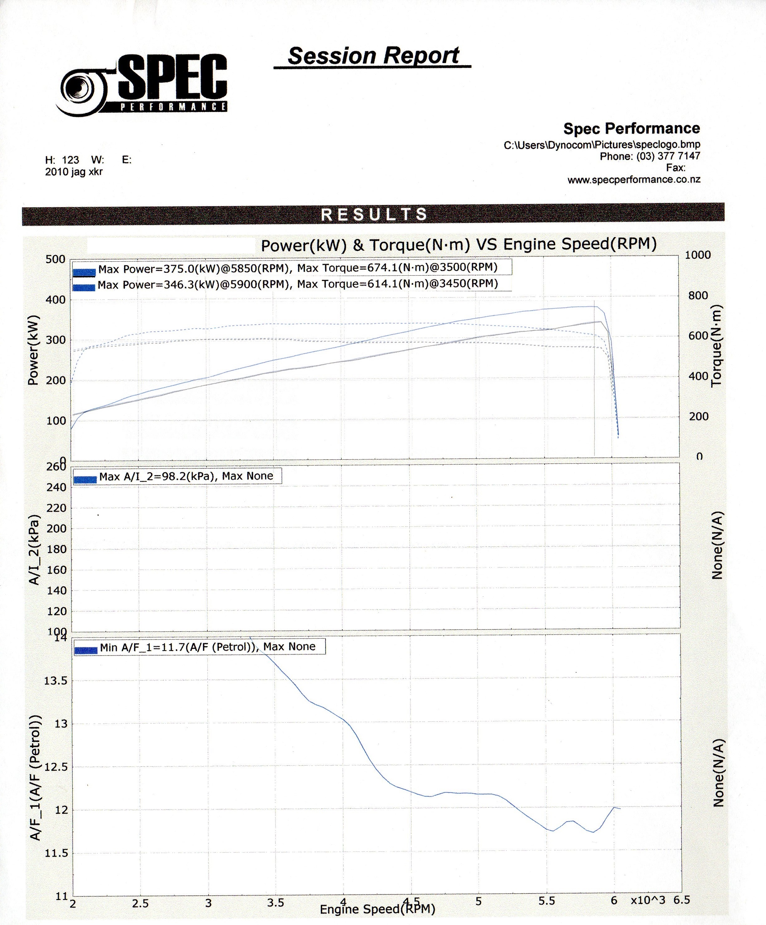

I did another dyno run today. Unfortunately they haven't combined this run with my previous one so I have had a quick play with a graphics package to superimpose them.
There is a decent improvement in power. Torque has gone from 614Nm to 674Nm and power has gone from 463rwhp to 502rwhp. If you assume a 10% drivetrain loss that puts it bang on the power of the XKR-S.
Not bad for just adding an x-pipe and 20 minutes with SDD applying the XKR-S tune!
Next step is a smaller supercharger pulley.

Good stuff, it's on the right path.

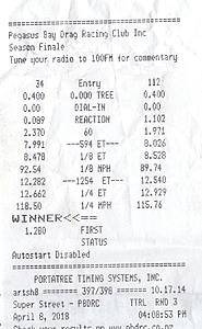

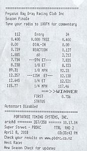

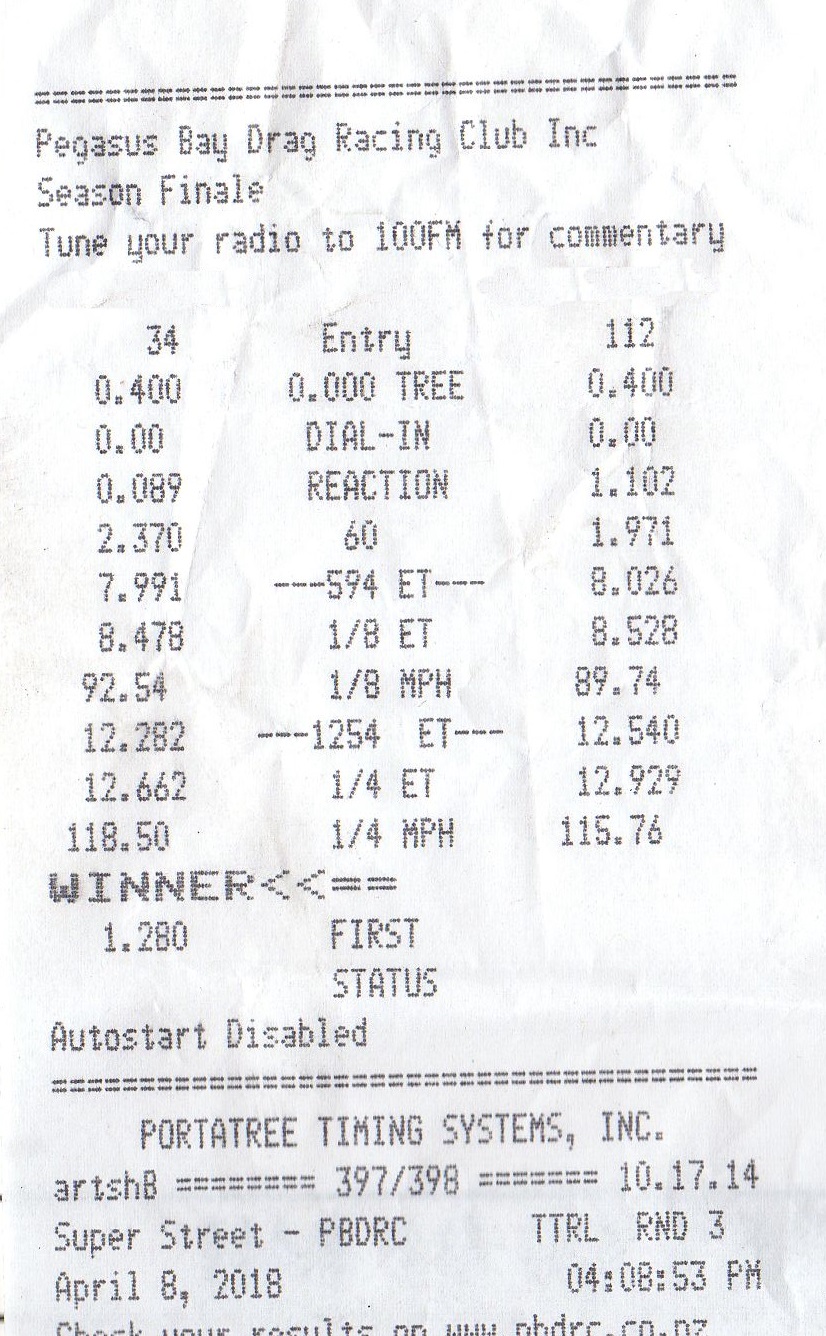

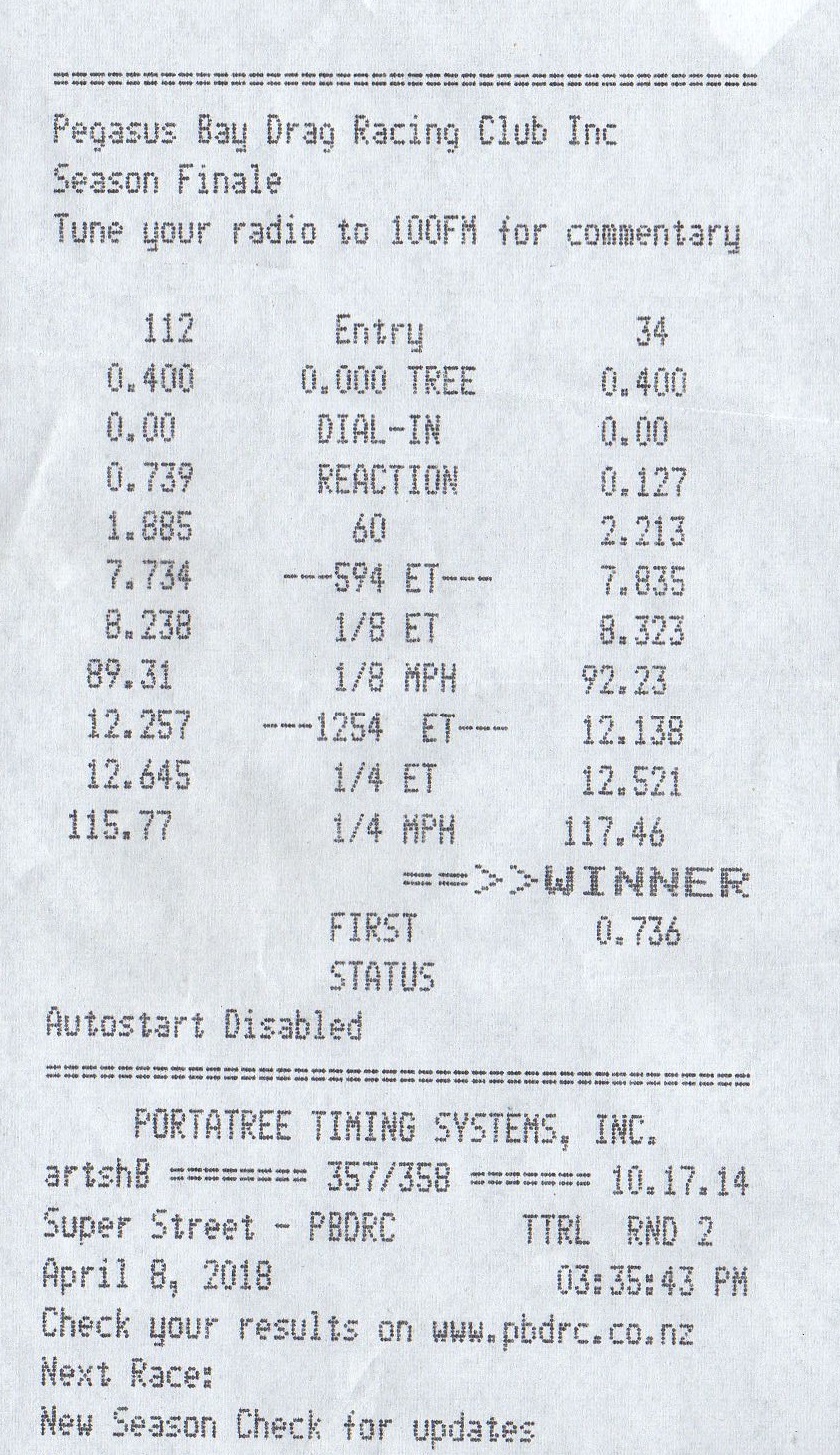

We had the last drag meeting of the year today so I did some runs with my new, improved 2010 XKR. The standing quarter times haven't shown great improvement with the XKR-S tune but that is probably down to my traction issues (12.521 v 12.533).
The terminal speed however has jumped from 115.73 to 118.50.

The mph is smack on 117-118mph however that 60ft is very nasty
Drop the 60ft and low 12s are achievable out of interest what tyres as you running on the rear
