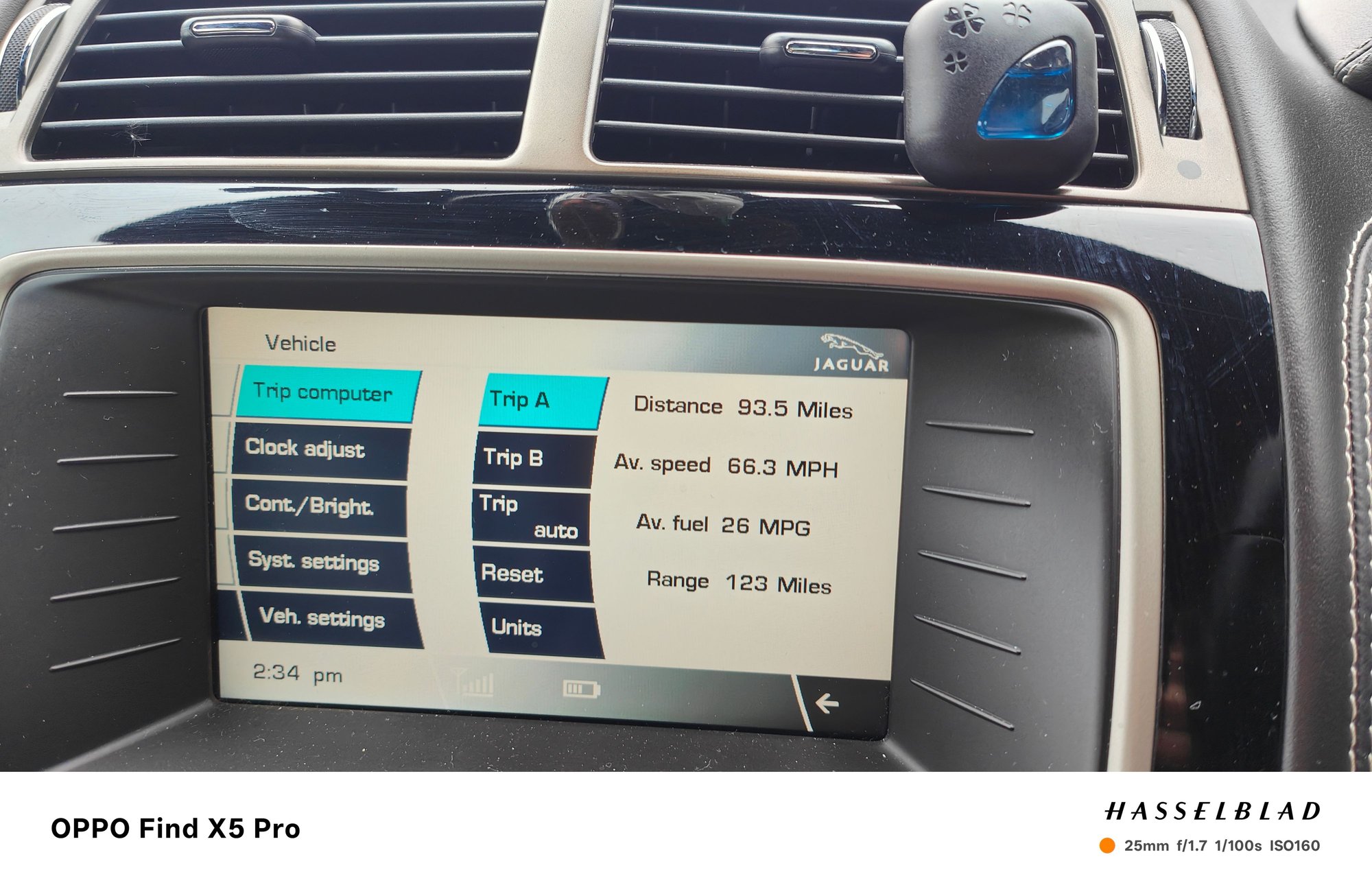

Something seriously wrong, check fuel trims
I'm getting around 18mpg and I'm driving my XKR-S for over a year and a half
18 is mixed driving in traffic - urban driving on a motorway photo attached for that
