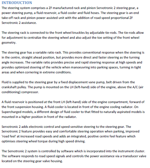

Read the flippin service manual and mind my original post... The steering has electronics controlling the hydraulic valving. The valve isn't allowing full pressure to the ram. Your jump starting a low battery has the system at the very least confused. Unhook the battery and charge it fully before moving forward.
X150 service manual, page 639
Attached Thumbnails After jump start no power steering-new-bitmap-image-2-.bmp
