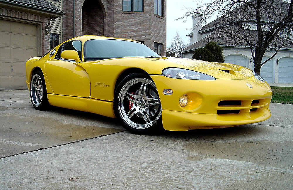

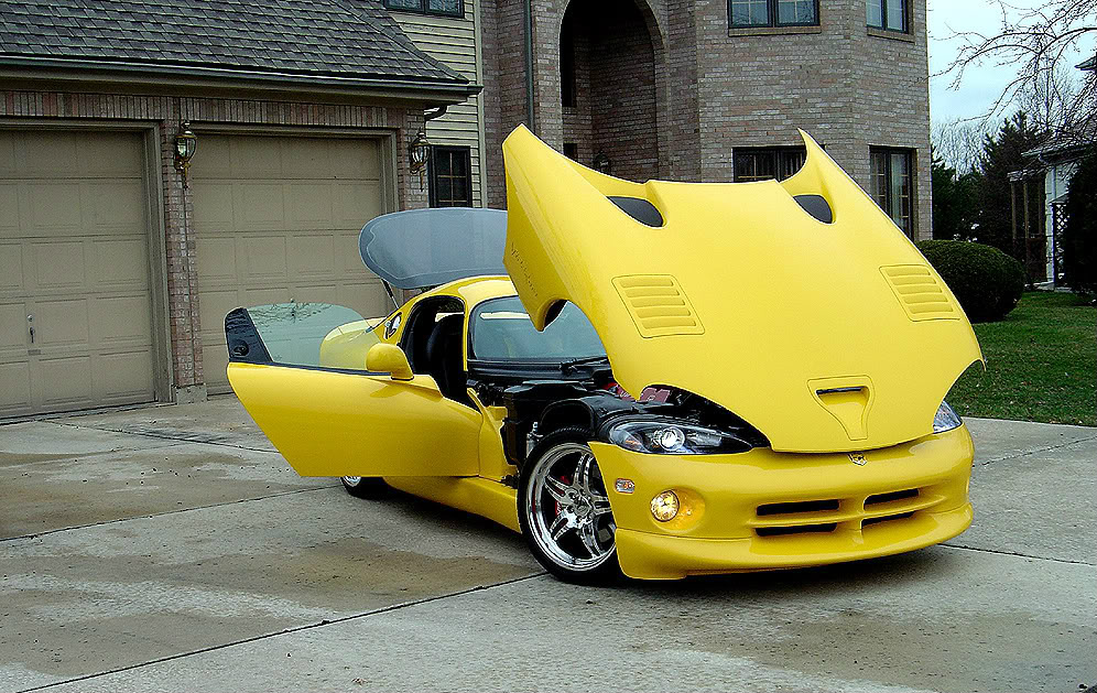

Was CCWs once called Perner Wheels? They are pretty nice wheels for the money. I remember thinking of getting the 505a when I had my corvette but my buddy with the Viper got them and so I decided to go with Mallett wheels instead. Here was my buddy's Viper with the CCWs 505a before he sold it awhile back. They are nice wheels:
