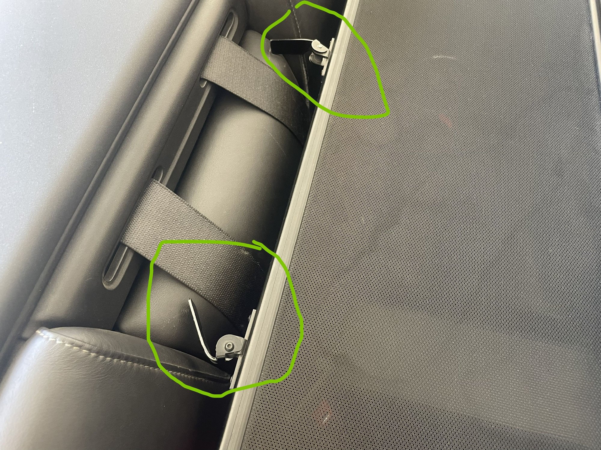

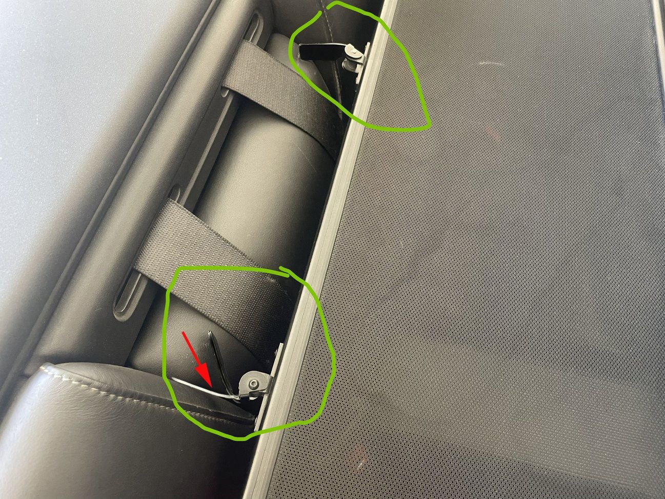

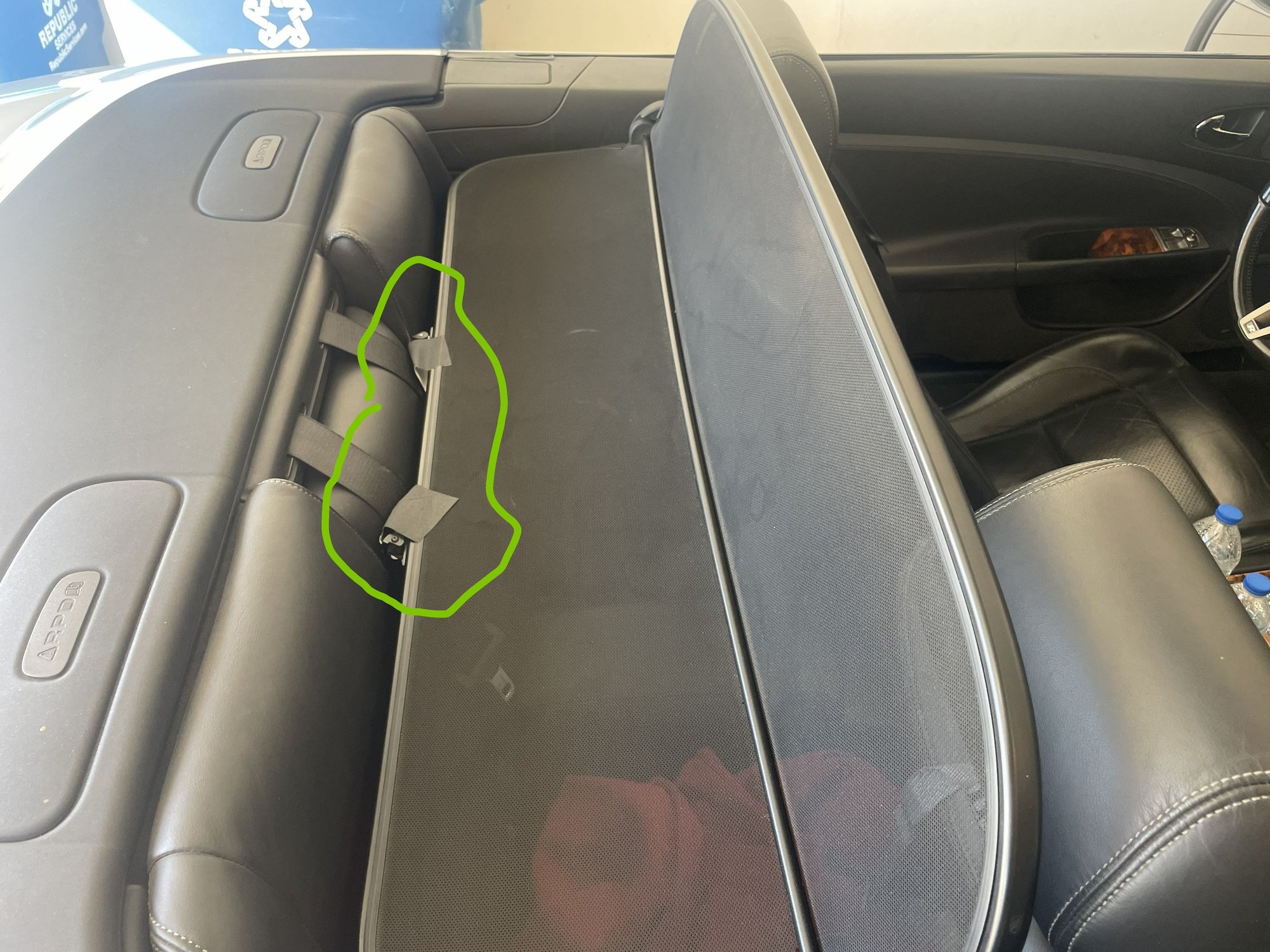

Can someone explain to me what the purpose of these two "clips" are on my air deflector for my 2008 XKR convertible? To me, they look to be good for poking holes in the rear seat back leather! Third photo. I have wrapped black tape around them to prevent that. First photo. They are held onto air deflector support bar with small rivets. I am tempted to remove them but would like to what the intended purpose was before I do that.

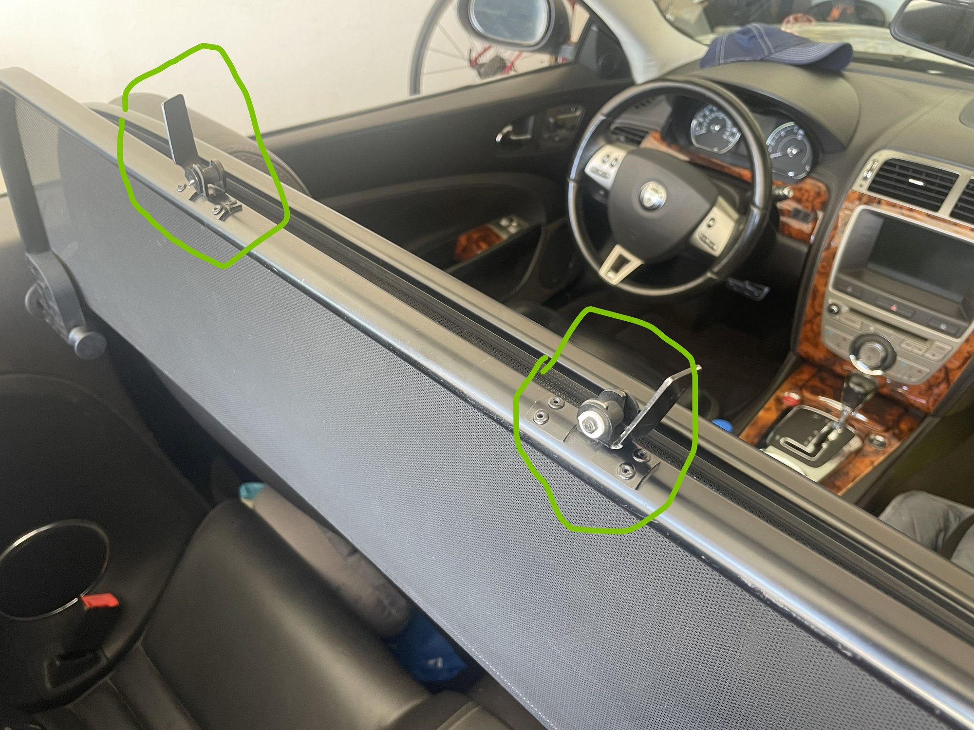

My deflector is quite different. My flat hoop is longer than yours and it has two fixed metal rods that go into the seat belt slots.
You should probably remove those entire brackets.

My deflector for my XK8 looks similar to yours but has nothing on that rear edge. If they are not doing anything useful, I would drill out the rivets.

Mine is like ceejay's but I think that the flat portion is meant to fit between the seat back and the upper center section.

Those tabs are designed to fit into slots in brackets that are mounted between the seat cushions. If your car was ordered with the wind deflector from the factory, the brackets would have been installed. I’ll find a picture of mine and post it.
