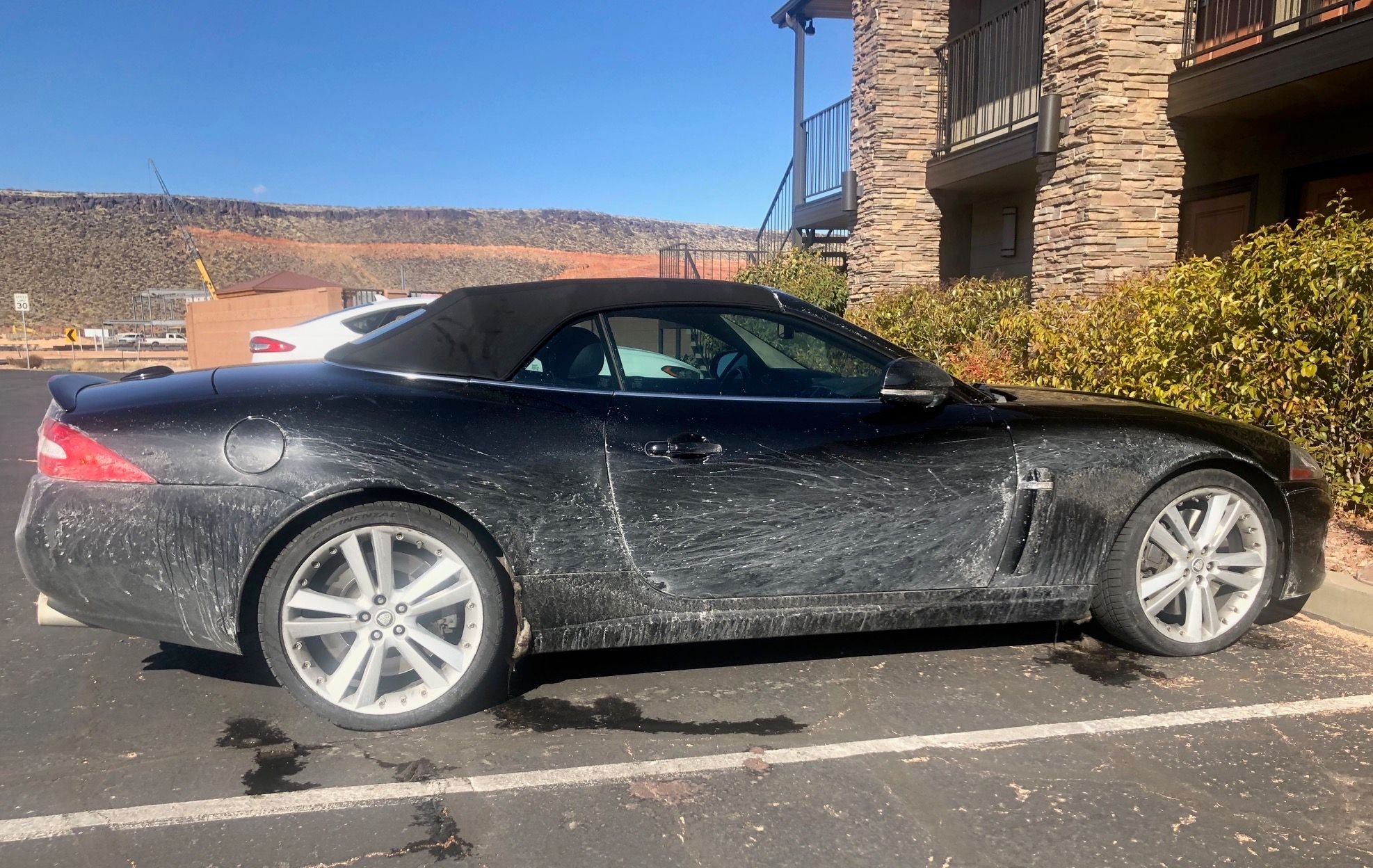

Hello! It is that time of year, and being the madman I am I daily drive my Jag no matter the weather. I've only had it since March so this is my first winter with it. Does anyone have experience putting chains on their car/recommendations for chains to buy? I am looking to take a 1200 mile road trip soon that goes through some chain up areas.

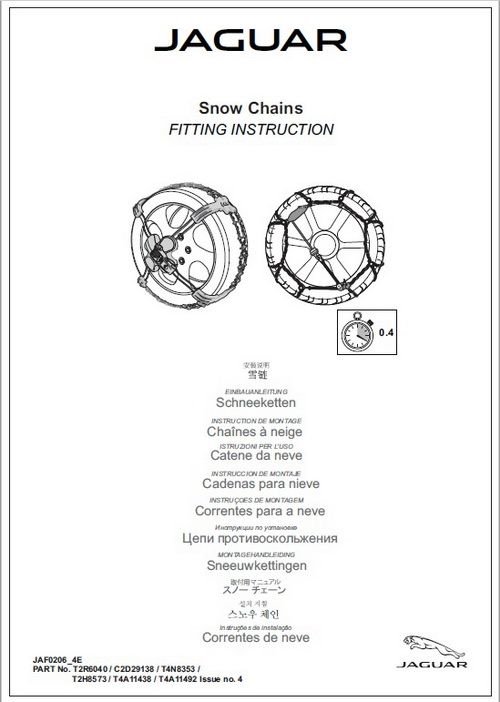

Jaguar understand that owners who take their vehicles to the European ski resorts are required to carry/fit snow chains and provide three solutions for the XK:
1. SNOW CHAINS
The full PDF exceeds forum filesize limits so I can't attach it.

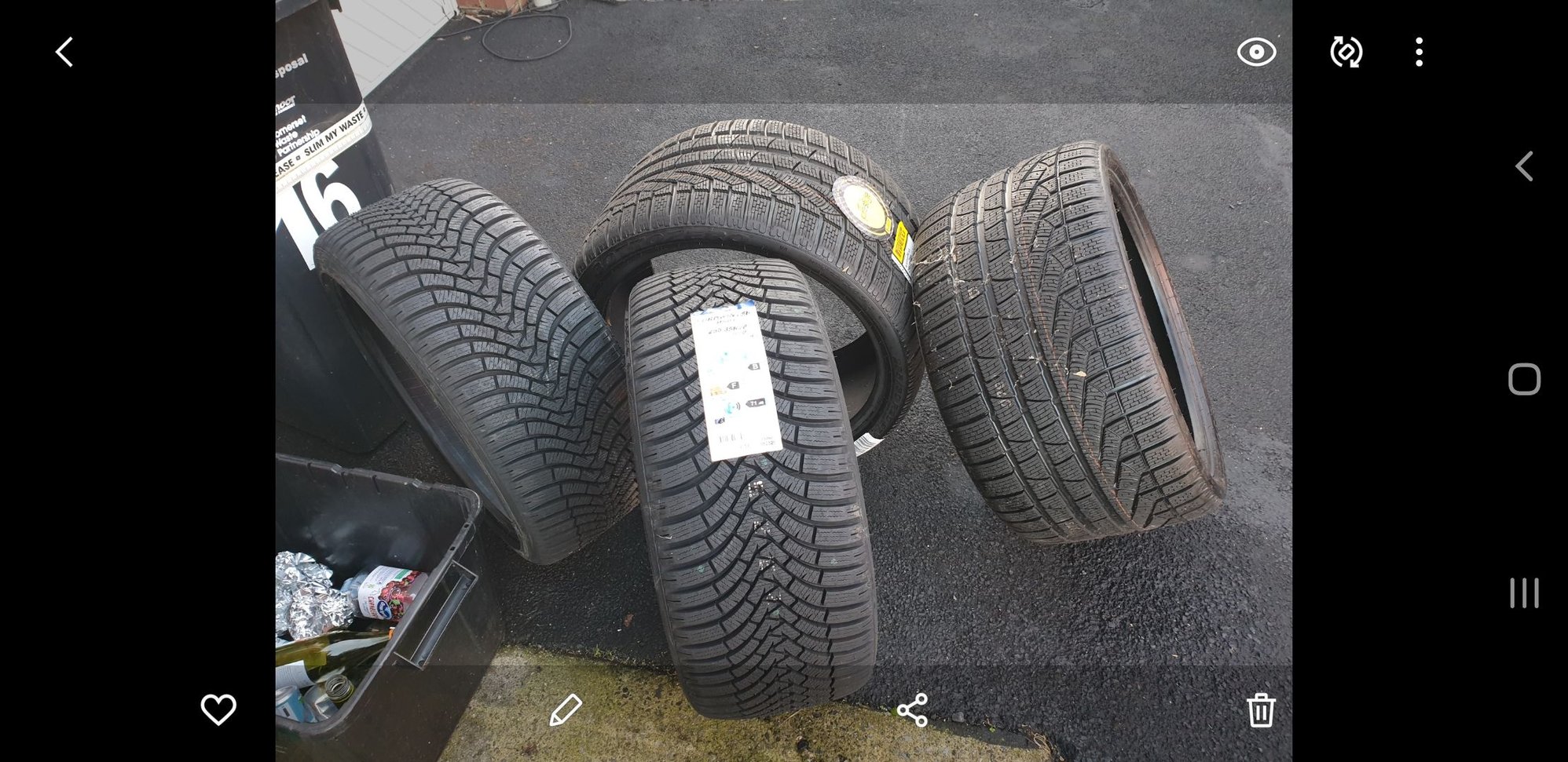

In my part of the UK we rarely get temps drop to below minus 4, in my driving times in coldest months it's between zero and 6 degrees. Have held off fitting winter tyres for a couple of years although have a set of spare vulcan's and rear set of sotzero's in the garage.
This year I've purchased a set of Falken HS01's for the front and am going for it, since I've only seen snow here 3 times in 20yrs. Appreciate that when the air temp is at 10c the road temp is 6-7c so mine are going on next week, which will mean my MPSP4S's will last that much longer.

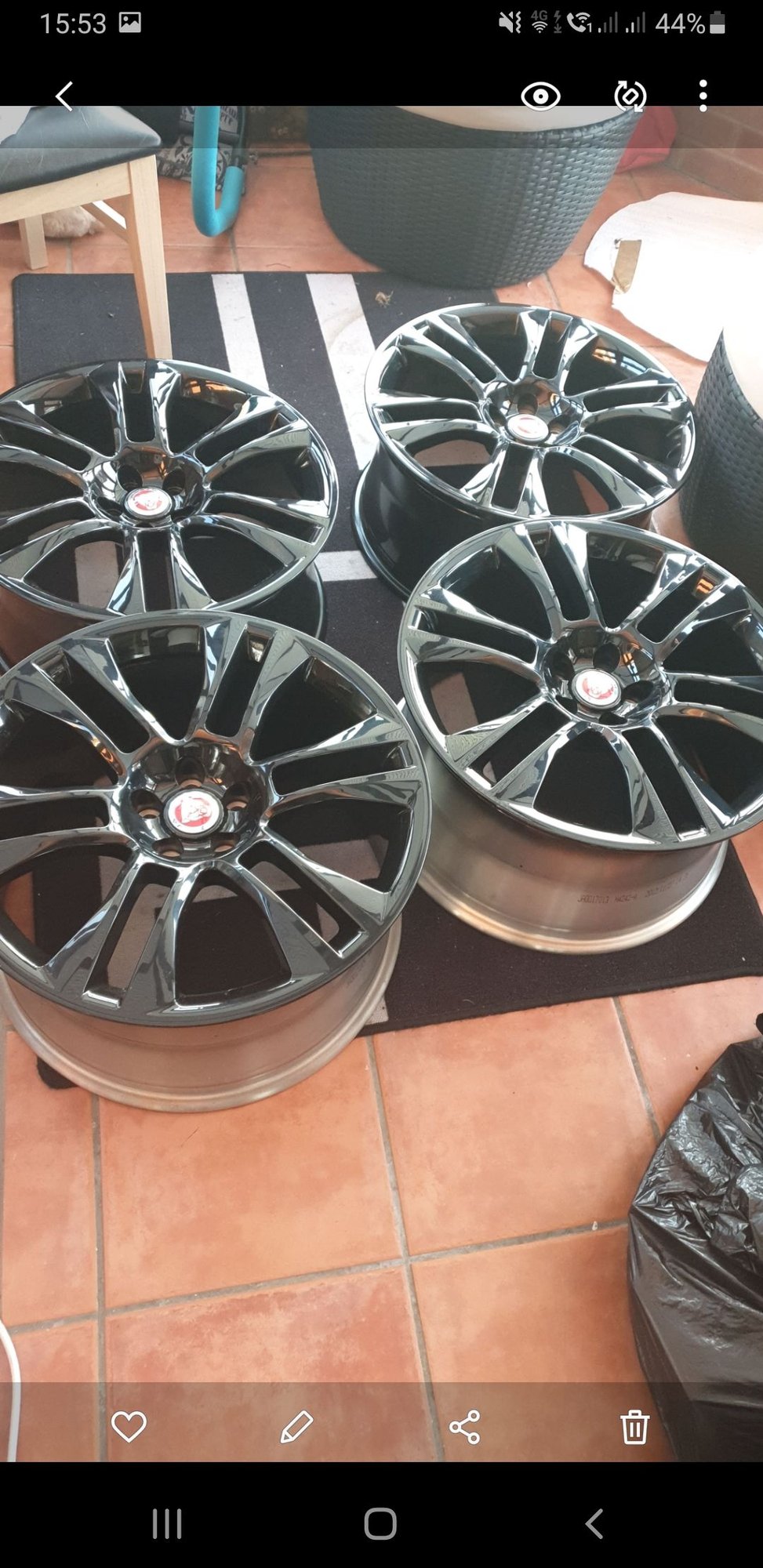

Rims have just been C5 wheel armoured, and will be finished with some 'reload' for extra water repellence.

I like the rims in the pic btw.
