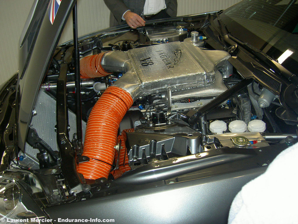

Here you go

Wow, now that is an intake. Looks like they used dryer duct.
What in the world are those things on the left and right of the intake tubes in the front of the strut towers? Some type of boost?

They are ,remote gas canisters for adjustable coil over suspention .

Originally Posted by jahummer
Here you go
is this photoshop?
no way the hood would even close

Originally Posted by AlexJag
is this photoshop?
Well, there is no hood on this car. I wonder if they are making a new one for this car, looks like it has some type of sponsor on the front so who knows what is being done.
is this photoshop?
No it is the real deal and the hood fits fine.
Here is another and again the hood fits fine, I think the profile is lower than it appears:

That blue car is one of the Apex GT3's... https://www.jaguarforums.com/forum/m...ing-car-95277/
There was another intake design for the GT3 as well...
Anyone upgraded to larger intake tubes on dual  setup of XKR?-00_focus_xkr_4.jpg
There was another version of this with the box section made in carbon fibre.
Google images for Jaguar XKR GT3 you might find it.
EDIT ah yeah, it's in the link I posted above LOL
EDIT AGAIN, beaten by jahummer hahaha
There you go , knock off wheels. Don't necessarily like the design but all the same they are knock off's. I'll have to see if I can track down the mfg.
