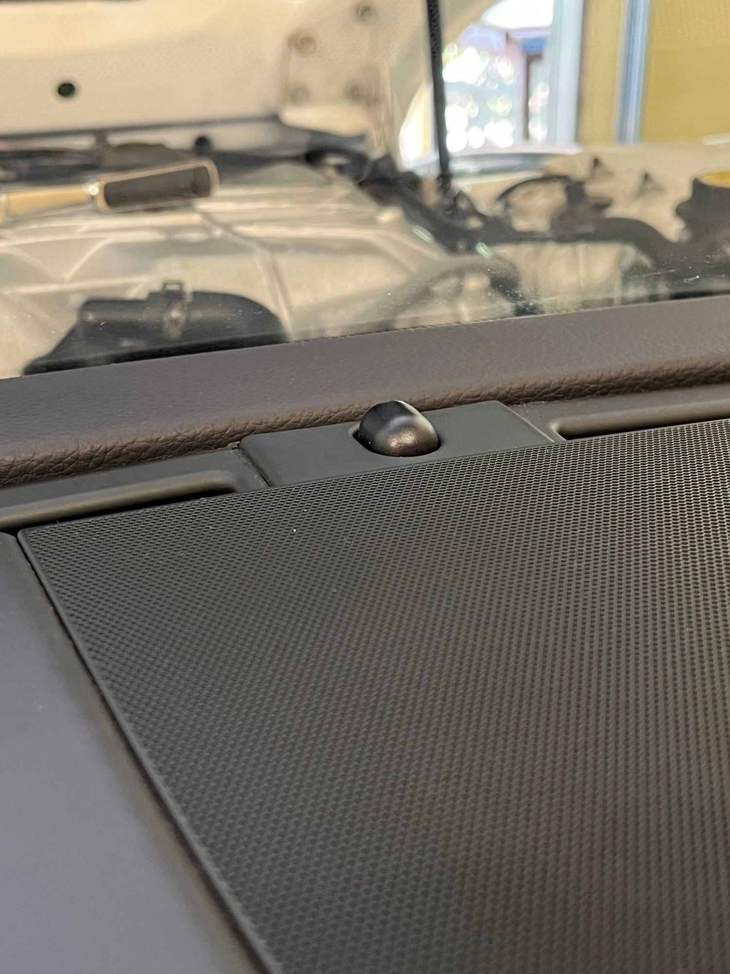

So I have a Singapore market XKR that now lives in NZ. I've noticed that the dip beams are always on when I turn on the auto headlight function. The car seems to know when it's in the dark, for instance if the lights are in the off position and I pull into my dark garage the info screen says 'headlights off' as kind of a reminder that you're in the dark without lights.

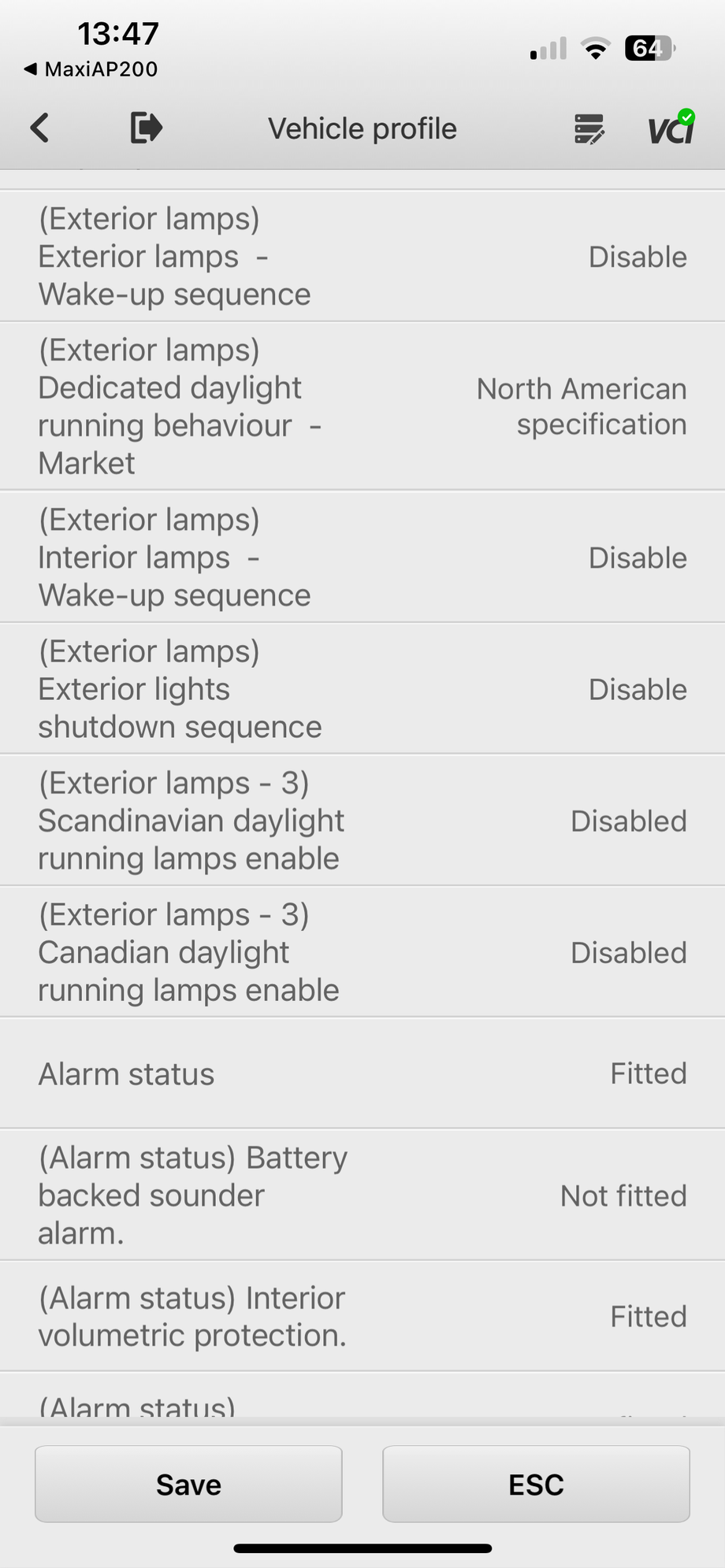

I've done a scan with my autel ap200 and I can see my dedicated daylight running behaviour is set to 'North American Specification.
I'm aware that the small black sensor at the front of the dash is for the auto lights and isn't blocked. What I have noticed is someone before me has damaged the rain sensor under the rearview mirror - but as far as I know this doesn't have any effect on the auto lights, does it? Wondering where to go from here and if anyone might have encountered the same situation before.

Small update here, I've fixed the rain sensor for now, but can confirm that that definitely doesn't do the light sensing for the auto headlights. I can do a test as follows in my dark garage:
1) Hold a flashlight over the sensor on the dash, with the headlights ON
2) Switch the headlights OFF, take away the flashlight
3) wait about 6 seconds
4) I see a message on the dash saying 'Lights off'
If I repeat that procedure without taking away the flashlight I never get the 'lights off' message, as the car senses that it's still in a well lit area. I did the same with the rain sensor itself and that made no difference.
So, that leaves a few possibilities: either the light sensor in the dash is practically dead and not functioning correctly (I doubt), something upstream (CJB/instrument cluster) isn't working, or there's perhaps some setting that can be changed to enable this (this feels most likely to me). Here's an excerpt of my light settings.
Some other notes - the auto lights turn on/off with the car, and I get the green icon on the dash telling me the headlights are on.
