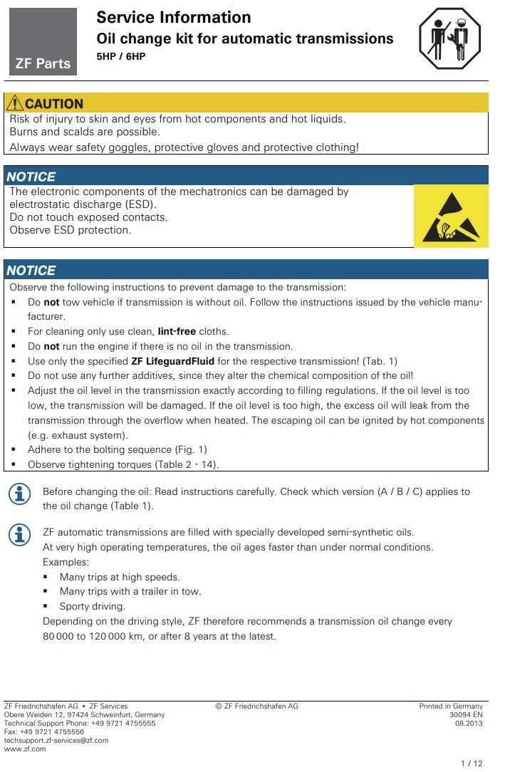

I don't know if this may help in / confirm your decision. It comes from the ZF publication, "Manual transmissions, double-clutch transmissions and automatic transmissions for cars".5. Maintenance recommendations ZF automatic transmissions
3/4-speed automatic transmissions:
ZF 3 and 4-speed automatic transmissions must be filled with approved ATF oils according to ZF list of lubricants TE-ML 11, lubricant class 11A / 11B or with mineral ATF oils according to the former Specification Dexron II / Dexron III by General Motors. For oil-change intervals consult the vehicle manufacturer's specifications.
5-, 6-, 8- and 9-speed as well as 4HP20 automatic transmissions:
ZF 5-, 6-, 8- and 9-speed as well as the ZF 4HP20 automatic transmissions are filled maintenance-free with specially developed semi-synthetic ATF oils. However, due to the many factors influencing the service life of transmissions in individual operation, ZF recommends an oil change after 150,000 km for its transmissions. In operating conditions with high temperatures and loads, or with unknown vehicle use in the past, it can make sense to change the transmission oil at shorter intervals.
In each case, only released ATF oil may be used for oil changes. And oil changes must be performed in accordance with the relevant specifications. The exception is the ZF 5HP18 automatic transmission which must be filled differently depending on the version.
The released ATF oils in each case are specified in the ZF Lubricants List TE-ML 11. Please consider also the service specification of the vehicle manufacturer.

So, in contrast to the documents quoted above, no time-based change interval specified by ZF?

I'll go with this recommendation any day!!
"In operating conditions with high temperatures and loads, or with unknown vehicle use in the past, it can make sense to change the transmission oil at shorter intervals."

May this will help. Last sentence.

From the ZF documentation "Depending on the driving style, ZF therefore recommends a transmission oil change every 80,000 to 120,000km or after 8 years at the latest."
Pretty straight forward to me.
