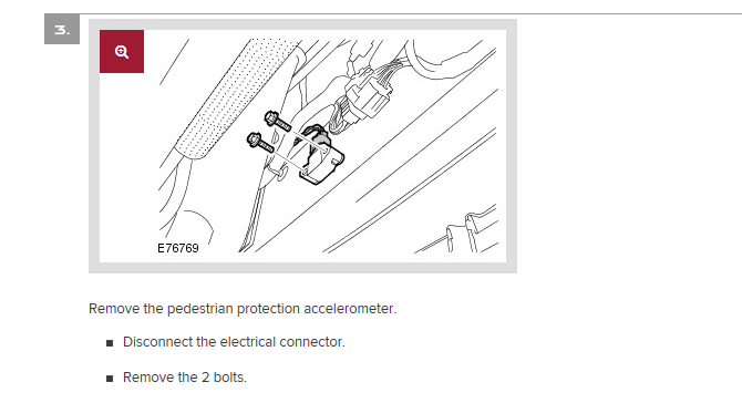

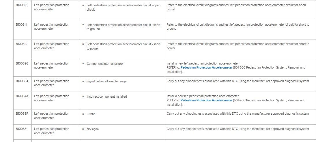

If you're looking for the Pedestrian Protection Accelerometer, as your code states, see attachments.
If this is the part you're looking for, part number I have written is C2P17132, this could have been superseded since the last one I replaced.
Attached Thumbnails B1005 Left frontal impact classification sensor-xkpedestrianimpactsensor.png   B1005 Left frontal impact classification sensor-xkpedestrianprotect.png
i have the newer single bolt type.
Thank you for confirming.
Got the part Numbers mixed up (i need to change my fan unit aswell)
