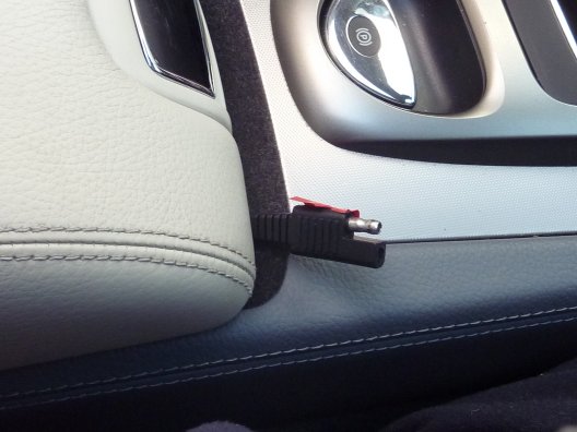

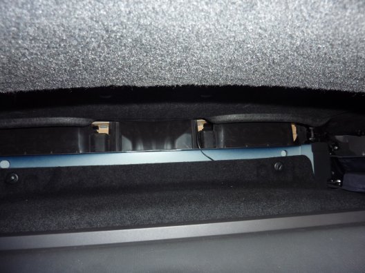

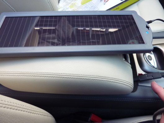

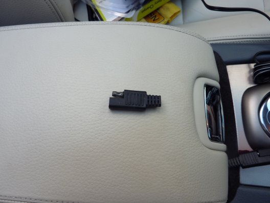

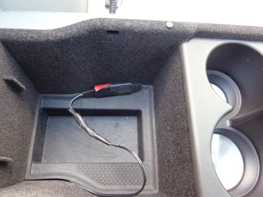

Guys,
I had a similar problem, when my 2007 XK had an electrical fault and the battery drained completly over a 2 week period. I was unable to lock the car in the garage as the fault prevented it being locked. - that's a long story, so to the fix.
Having previously owning a canal boat I had used a solar powered charger to keep the batteries on that up to full charge, and could leave them for a couple of months,(the winters are cold here!).
I bought a solar charger for about £10, that's about $16 today, plus postage. I ran a wire from the battery terminals in the boot,(trunk USA), through to the rear internal fuse box, and forward the the centre console. I zip-tied the new cable to the existing ones, you might be able to see it if you blow the pic up. Removing the rubber liner gives access to the centre tunnel wiring. My solar panel connects to that plug and rests on the centre console or dash, and I have left it for 3 weeks with full charge being held for that time. I also clean cut another plug off one of the other leads to use as a blanking plug when not in use, so as to make no short circuits to the battery. I didn't use the cigar lighter socket because as you all know some cigar lighters are not live when the car is left locked and the key not nearby. I have since found the one in the glove box, is that always live? I don't know, but if it is then all my wiring was in vain, I was new to the car at the time. I have attached some pics of the installation, the red insulating tape just identifies the +ve terminal for my own satisfaction. By the way the rear panels come off easily, the one on the back seat needs pulling out at the top, before pushing in an upwards direction to remove it. The one behind the centre console is a straight pull upwards. Access to the battery is via the rear panel in the boot/trunk, and is accessed by removing 4 plastic locking bolts. Turn them anti-clockwise.
Hope this helps, try ebay for the solar charger.

Scousegeezer,
Great option if you don't have access to AC, with an excellent write-up and pix!
My only concern is to make sure that the solar charger has circuitry similar to my Battery Minder Plus that prevents overcharging, as one that I saw on eBay for US$25 didn't mention that feature. However, another more expensive one for US$48 claimed to have that circuitry.
Stuart

Stuart S,
thanks for your comments. Yes the Solar Charger I bought cannot overcharge. Forgot to mention that, and its always in the car behind the front seats. Let's face it even my small grandkids have troube fitting in the back so it's not in the way, and takes 2 minutes to fit. I was away in the highlands of Scotland a month ago and left the car parked up, whilst using the daughters BMW. (I know - no taste). Anyway I left the charger on just in case - no probs.
By the way driving up there in the XK is great!!
