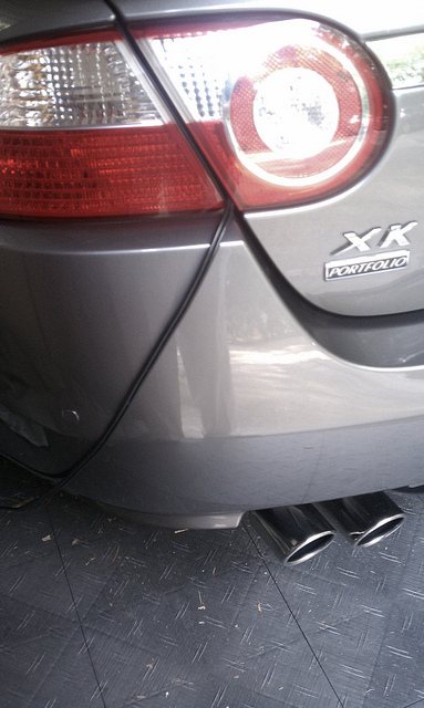

I did a similar thing with my solar charger. However, I was a little confused which "post" under the spare tire was the actual "negative" remote battery terminal post. Does it matter? Are they all essentially grounding points?
Also, it is not necessary to have the cable exposed and coming out of that plastic cover on the left side. That cable can be easily fed underneath the carpet!

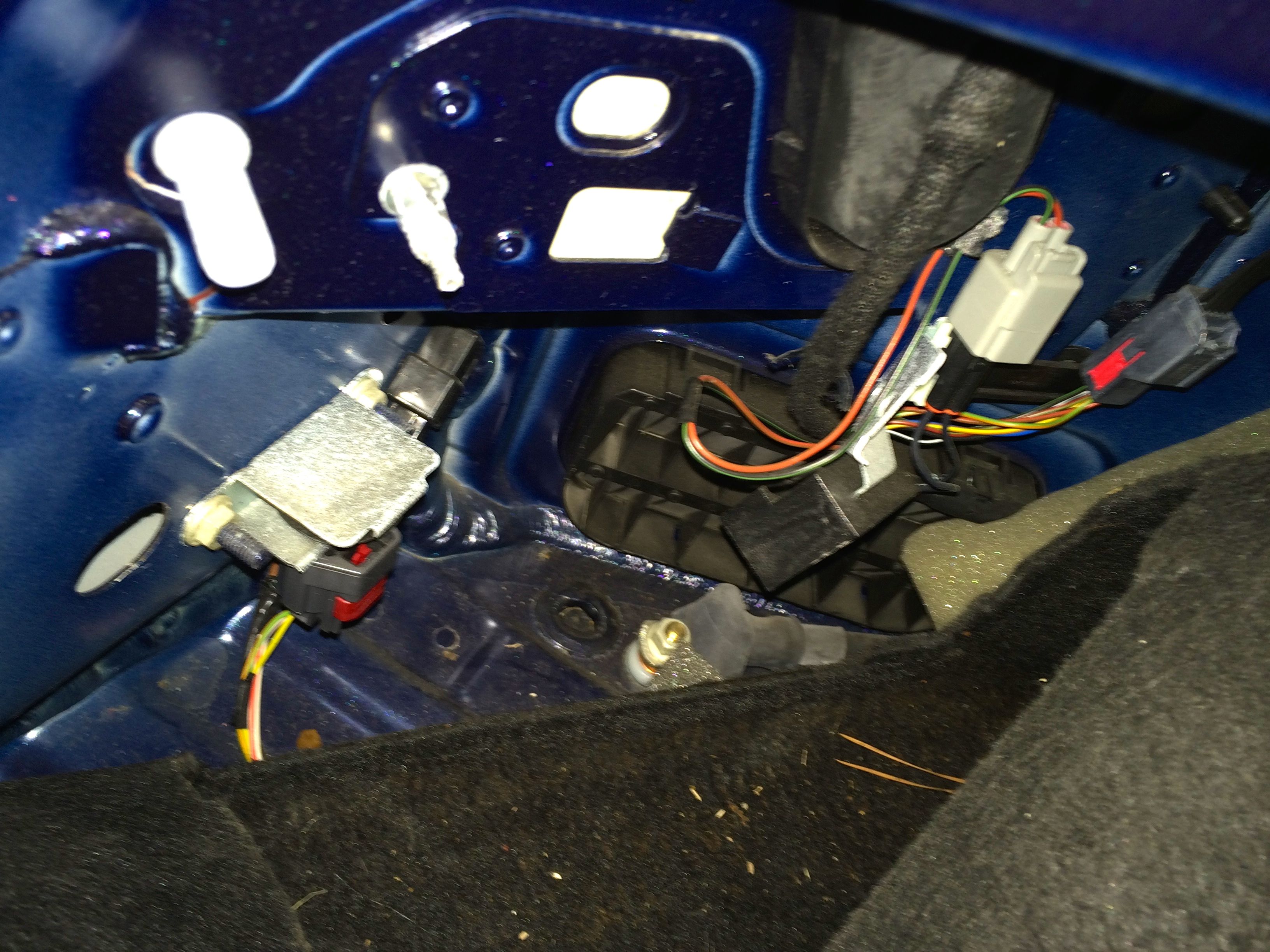

Clearly your pictures show a panel on the left side of the trunk [viewed from the rear]. However my 2009 Xk convertible has no panel on the left. It does however have one on the right. And there is no battery behind it. Has anyone an answer to this mystery?

oldcedar,
The remote battery positive (+) terminal is behind the black plastic access cover inside the trunk at the left fender. The battery is not there; just the remote + terminal. The battery is in another compartment in the center rear of the trunk.
Our cars are both 2009s and I'm surprised that there's any difference in our trunks. What is in the panel on the right side in your car? Do you have the Owners Handbook? What does it say about how to hook up jumper cables? Any body work to the left rear fender?

Angry Related problem
I went out to take pictures of my anomalies when a new development has arisen...
Apparently a dead battery also keeps one out of the trunk as well. Yesterday I could get into the trunk; today I cannot.:icon_hunter
Is there another way to open the trunk? I have tried the key bobs [both] and the internal panel button as well as the simple trunk button. No joy!
BTW, my manual shows a access panel on the left rear behind the left rear signal light, not on the fender. Something one would not see unless stooped over looking backward into the trunk recess.

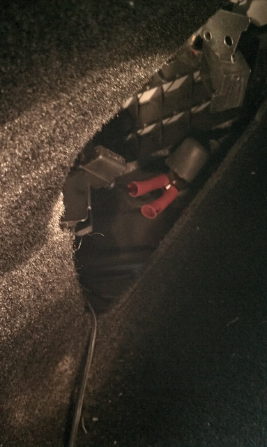

So that little key has an important function [or 2] after all. Took some pictures with and without the flash and found the panel!
Now out to charge the battery. Thanks for the help. And the patience for a newbie.

Your 3rd picture shows the remote positive terminal, with the rubber boot pulled back. That's an excellent spot for attaching the positive terminal for a battery tender. (I attached the negative to a post in the spare wheel well, adding my own nut and washer to secure it.)
