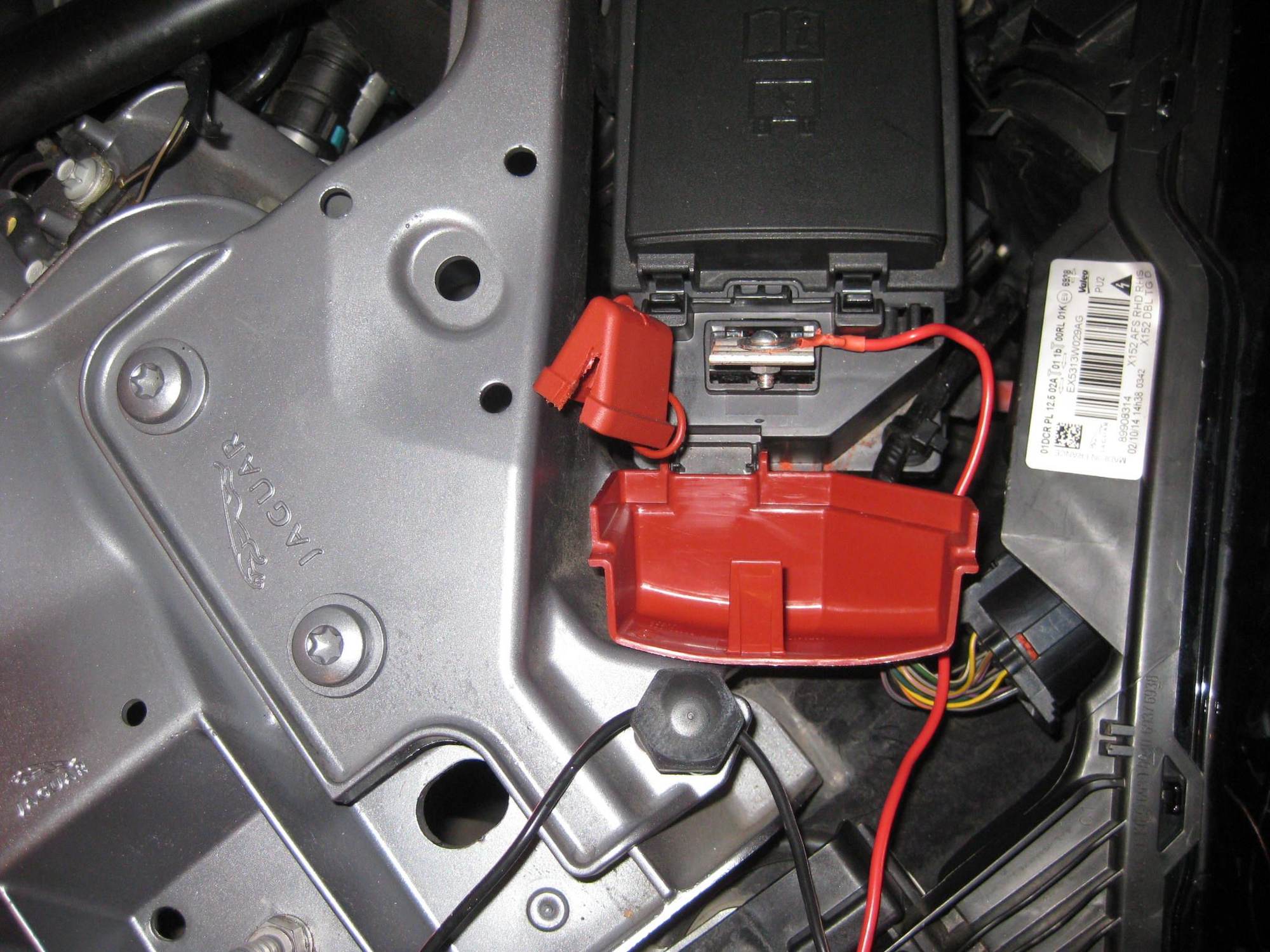

I found a way to connect/disconnect the maintainer in 10 seconds flat without having to even unlock the car let alone open the hood, trunk or a door - I hard wired the maintainer connector pigtail to the under-hood charging posts, see this pic:
Just on the edge of the frame at the bottom of the pic you can see the negative/earth lead bolted under the car's earthing post, I simply unscrewed it, slipped the eyelet under and screwed it back down again. For the positive connection I drilled a small hole in the centre of the positive post and bolted the eyelet to the post with a short 10 mm nut, washer and bolt. When not in use the plug end of the connector tucks up under the edge of the hood, between the hood and the plastic lining piece underneath, then when I want to connect it up I simply flip it out using a finger. Dunno if you could do the same on an XK but as it has the same reverse opening clamshell style hood as an F-Type there is a good chance you can. The only hard part was cutting a slot in the small plastic cap (you can see it in the pic) so it clears the pigtail wire and closes over the charging post, that plastic is hard as a rock and it took a good 20 minutes of sawing away with a hacksaw blade! Of course you will need the same type of pigtail connector if you don't already have one.
