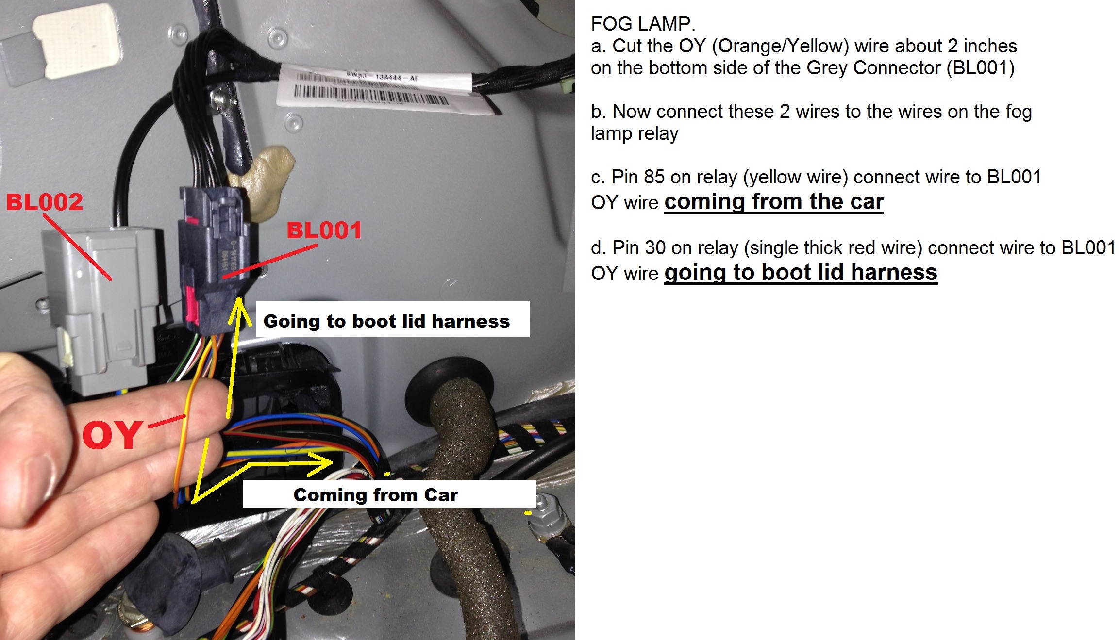

I bought the adamesh kit a couple months ago and installed it with no issues yet. You will need to cut 2 wires on your stock wiring harness and splice in a couple power relays that he includes with the kit. ....not that big of a deal, but just a heads up in case you were unaware, they are not 100% "plug & play"

Yes, I installed them myself. While I want to say anyone could do it, realistically I should say that many probably would not, or rather perhaps not want to do so. In my opinion, it was relatively simple. However, some may not be so comfortable cutting wires in the back of their car and soldering pieces in etc.. This is the only pic I have on me right now from the installation process. Essentially, pull this black plug from the rear panel, there are 2 wires you need to work with. an Orange/Yellow and an Orange/Green wire. You have to cut these two wires in half below the black plug. For the Orange/Yellow Wire, the side of the wire nearest the black plug goes to pin 30 on the relay (red wire). The side of the wire you just cut coming from the car gets connected to pin 85 on the relay (the yellow wire). Repeat process for Orange/Green wire using the other yellow and red wires (kit comes with these 2 relays).
Also, I would avoid using crimped connections if possible, and absolutely do not do the whole "twisted wires and electrical tape" do the job correct and solder the wire joints, or be damn sure you have a good crimp on your wires.
Good luck,
Feel free to ask if you need any help with the conversion
