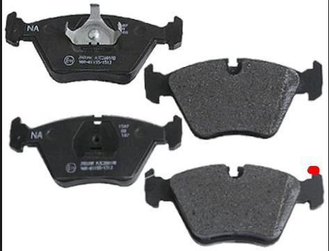

The mechanic (shop #2) just called me. He said they identified the source of the problem as excessive clearance (1mm) between the brake caliper and the pad on the inside pad. He said as a test and remedy, they welded some metal to back (or edge?) of the pad and the noise went away completely.
He suggested I just leave it like this and see how it does. I will pick up the car today to verify that the noise is indeed gone, and if so, I'll probably make this a weekend project at some point (replacing the brake caliper/pads and/or slider pins/bolts).

I guess I don't understand what they found. Why would you need to modify a brake pad to correct the problem. Something doesn't sound right here.

I think for a permanent "ideal" repair, the caliper would have to be replaced along with possibly the bracket and bolts. I don't know if there is a good way to check for exactly which component is damaged. I can hopefully do this myself, in the near future so that I can just redo the pads on the LF side without having to do the RF.
Now that I think about it, it does seem like there is some brake dragging but I have measured using a heat gun and both front wheels seemed like they were the same temperature after driving. If there was excessive dragging on the outside pad, then I would be concerned about rotor warping and uneven brake wear.
This is all assuming the noise is actually gone. At this point, I am still skeptical. But if it is true that the noise is gone, at least I know the noise is related to the brake components, specifically the caliper, caliper bracket, caliper slider pins, or caliper mounting bolts.
Something does not compute. So, was the pad under thickness? Was it the same on the other side? It's the nature of a disc brake for the calipers to breath and create a little gap when you let off the brakes so they don't rub all the time. It depends on the type of caliper as to where the gap is allowed. Floating calipers with the pucks on one side that have excessive gap are stuck but usually show up as running hot. Most pads have some gizmo that holds them to the caliper puck, usually a spring loaded arm for this issue. If the gap is more than the other side then do you have a sticking caliper or an ABS proportioning valve problem?
Welding the pad creates more questions than answers. The most obvious being why not fix the problem instead of the symptom? As a troubleshooting step was does it resolve? If the prop valve then it'll just pull back again once it get's a couple cycles. If the caliper will it now wear in a new 'rest' spot?

I just got back from the shop. Your skepticism is warranted--the problem was not fixed. He showed me photos of what they did, basically where the pad is sort of keyed into the slots on the caliper, they added just a very minuscule dab of welding material to eliminate any clearance. This has had no impact at all on the sound. Since it doesn't change the pad thickness or its function, I'm not too concerned about this needing to be undone.
The mechanic went on a test ride with me and heard the noise and now understands what noise I was talking about (seems like the last mechanic had the same problem). He thinks that there is no way the noise could be related to brake pad play based on the heaviness of the sound (as opposed to light chattering/clicking). He put the car on the lift and he, another technician and I went over all the components of the front suspension, using a prybar to check for play. According to this shop, everything checked out OK (this is the same thing Shop #1 told me).
Both shops now suspect that the problem is indeed an internally damaged strut. This shop suggested that they remove the strut, and play around with it when it's off to see if there's any unusual noises. If so, then they will replace the strut. If not, at least they will have an opportunity to investigate other components while the strut is out, including the upper strut mount and the lower shock mount bolt/joint/bushing.
Again, these are two highly regarded shops, albeit without alignment racks, and they are both in agreement with their findings at this point.
