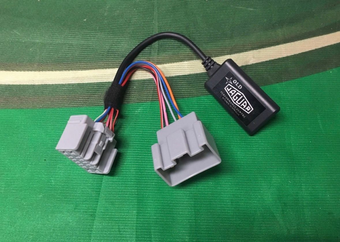

Once you had aux enabled, what did you physically plug the Bluetooth module into?
Plugs into the back of the infotainment stack. Unplug the big connector from the stack, plug that connector into a mating connector on the Bluetooth unit, and plug the Bluetooth’s replacement connector into the infotainment stack. So the addon module is inline with existing harness that plugged into the infotainment stack.
This is Cambo’s “Old Jaguar” version:
