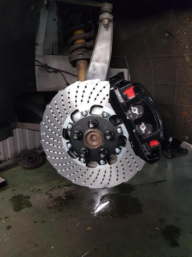

I went for the EBC redstuff pads purely as have black diamond cut vortex alloys and previous good experience with them, 2yrs later and the minimal brake dust still rinses off with a garden hose.
Also as I have a three cars I only do 5k miles per year in my XKR
At the same time I went for upgraded discs from Wortec which saved me 44lbs of unsprung weight over stock, perhaps overkill but they look mighty purdy!
2nd UK MOT done this month and the inspector advised there was no discernible wear on either pads or discs and asked me if I'd just had them fitted, he was surprised when I shared they were 10k miles old. That said I do you use atom-mac on my discs, which does tend to keep them sparkly

Guy, don't worry no ones are! In fact when I had them done at my busy Indy other customers were coming up to admire them with favourable comments (that I can't repeat on this forum)
I do understand that early drilled/slotted rotors were plagued with issues, but never had issues with my EBC's on my old X100, they lasted for over 8yrs. Wortec were so confident these would last they gave me a written 10yr guarantee and that included track use (which I won't do). To my knowledge mine is the only X150 with them fitted, although they are popular on F-Types and the odd XFR.
