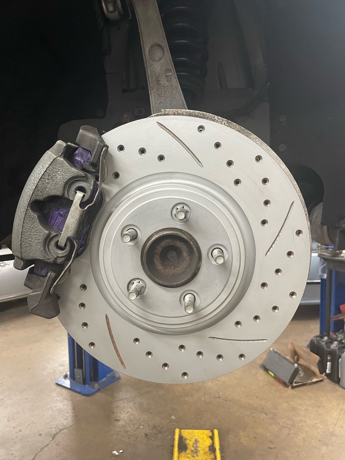

Lots of options for aftermarket rotors/pads. I went with Cquence rotors and Akebono Euro premium carbon ceramic pads. Very pleased with both. For street driving the carbon ceramic pads stop just as well as OEM pads. They don't really need much heat to bite. A little less brake dust as well.
I went with Cquence as they machine the slotted/drilled rotors themselves (rotors come from Aisa as do most rotors these days). They machine the rotos for the left and right side unlike some you find.
Performance Brake Rotors | Brake Pads & More Brake Parts | Cquence.net
Here's one of my fronts installed:

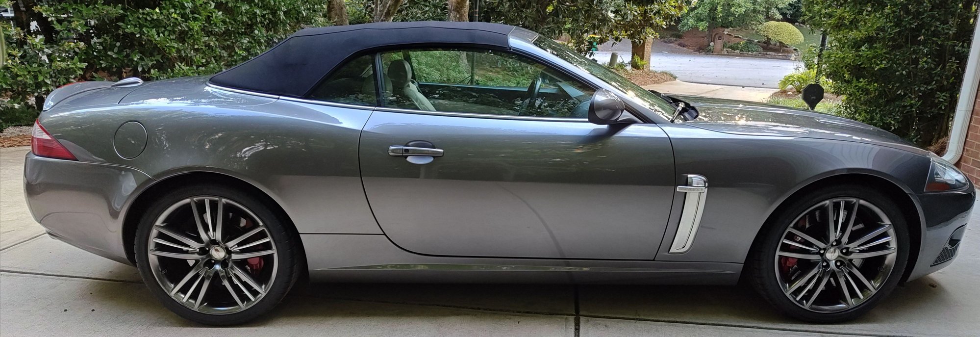

I bought these Brembo ceramic pads in 2019 and had them installed in October 2024 when I replaced all 4 original rotors. My 2009 XKR Portfolio convertible has the Alcon Performance Brake Package, which was a $5,000 option. I don't know if these pads are still available.
The OEM pads left massive amounts of black brake dust. The Brembo pads leave much less dust and it's tan, not black, so it's much less noticeable. I ceramic coated the Selena wheels so the dust comes off easily with a garden hose.
Stuart

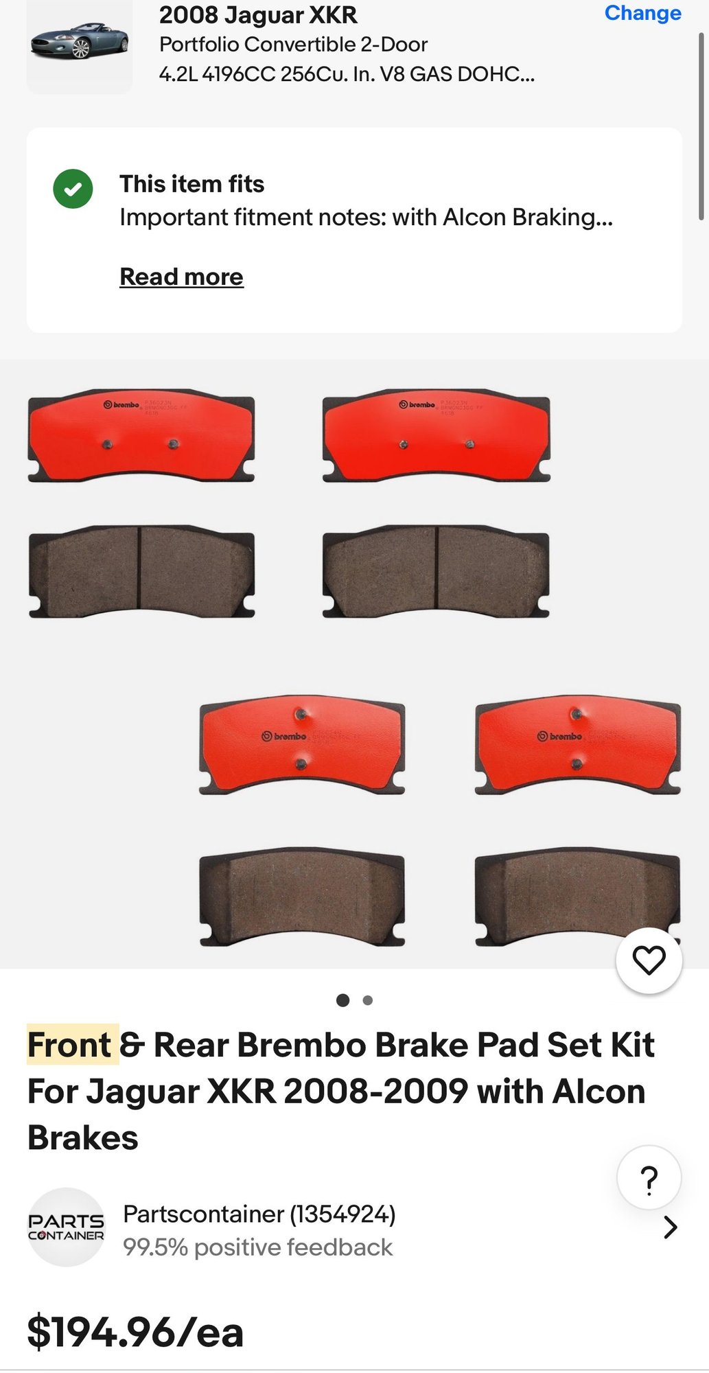

Poked around. Found these, but noticed your photo has a notch on top. These say it fits but do not.
