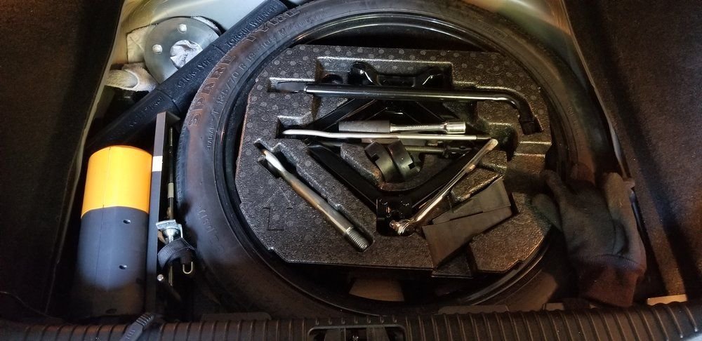

You can add a spare tire, just like I did:
https://www.jaguarforums.com/forum/x...-brakes-67260/
My 2009 XKR Portfolio convertible came from the factory with the Alcon Performance Brake Package and no spare tire. Instead, it came with an emergency inflator kit and a molded carpet liner in the rear spare tire well. That carpet liner must be removed for the spare to fit - and it's a tight fit. Here's how everything fits in the trunk. The long black plastic case in the top left corner is my torque wrench, and the spacer is above it. That's the 12v inflator with the orange band. The spare fits the front without any mods, but I needed a spacer for the spare to clear the rear Alcon caliper. If you don't have Alcon brakes you might not need a spacer to clear the rear caliper. Everything is explained in the above link.
Hope this helps!
