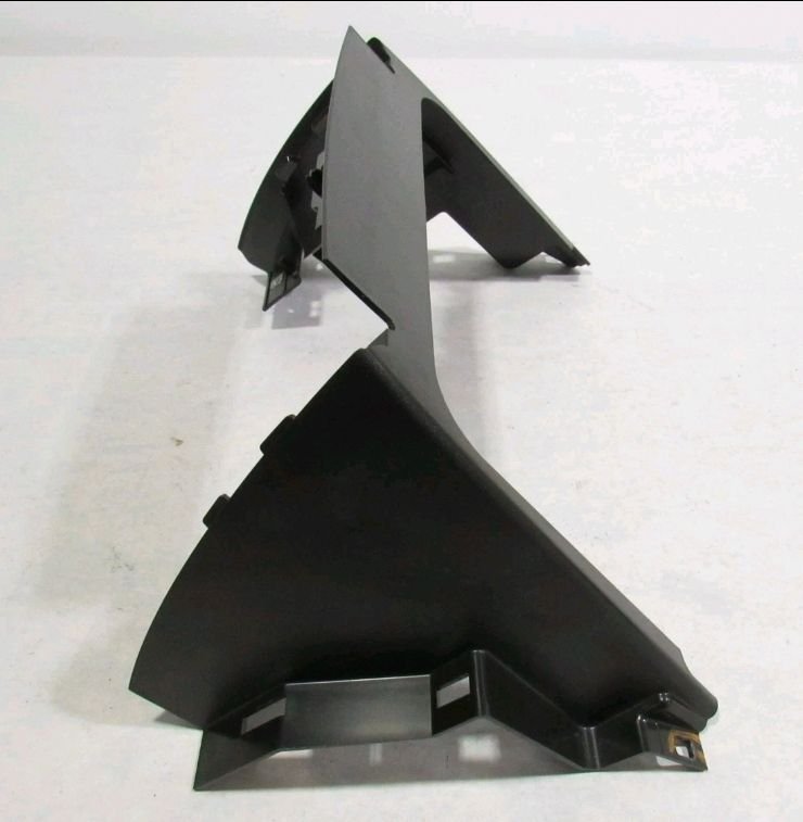

It wraps around behind the centre console and neatly covers the spaces between the carpet and side of the glove box. Mine was really stuck when I was removing the glove box and broke it on one side. Found out it’s bolted in and you need to take apart a lot of the fascia. So it’s on my eventual to-do list.
PS I’m pretty sure it fits in top of the dashboard rather than behind the dash.

LJRXKR is correct. It's a beauty panel that hides openings on both sides of the dash console.
It sits behind the infotainment system, and also behind the dash. It almost seems like it needs to be mounted while the dash is out of the car, but I'm hoping not.

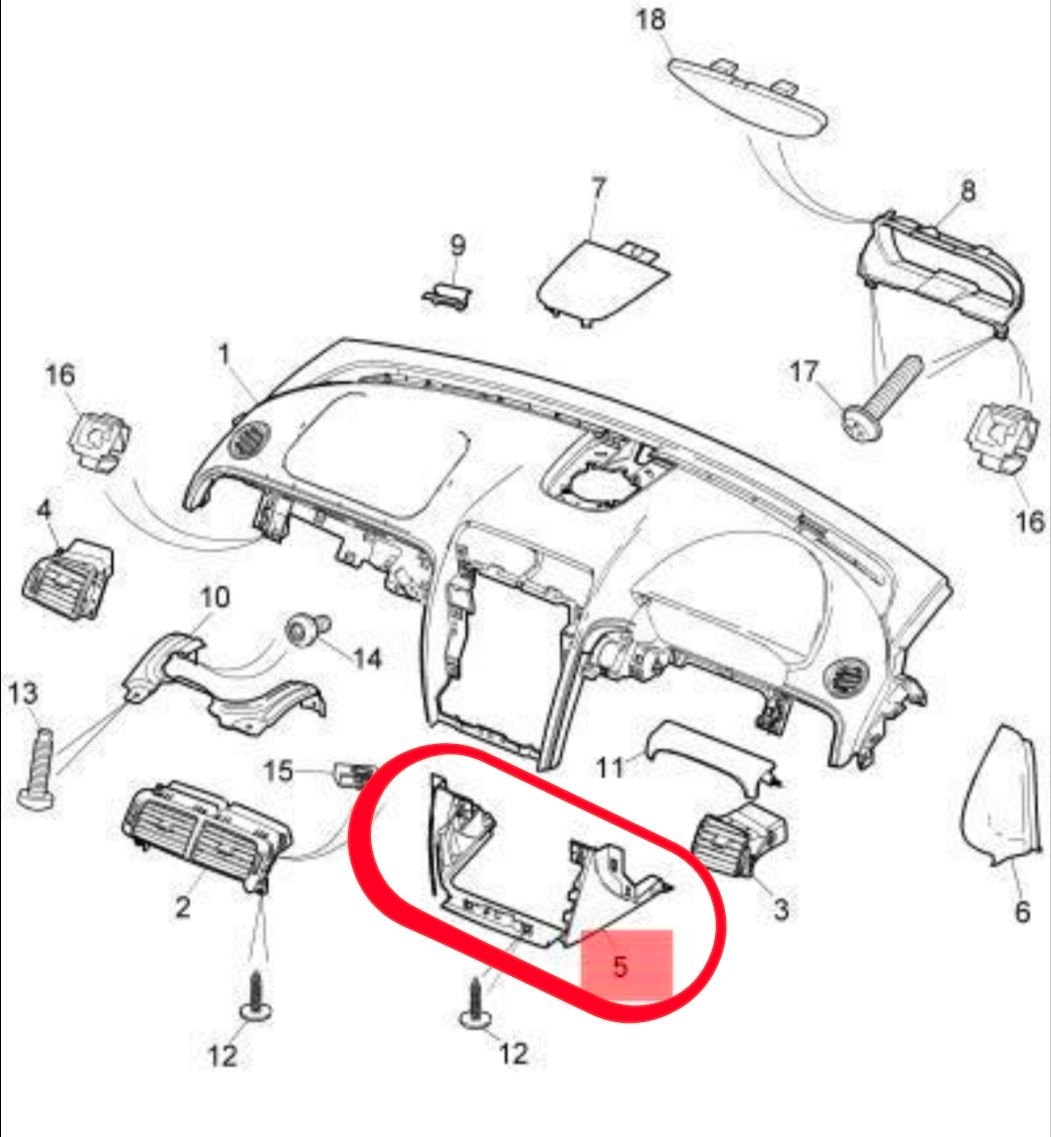

Topix shows it coming out as one piece with the dash. The actual dash removal doesn't look too bad, once the console is out. That's still a bear of a job for a broken tab though.

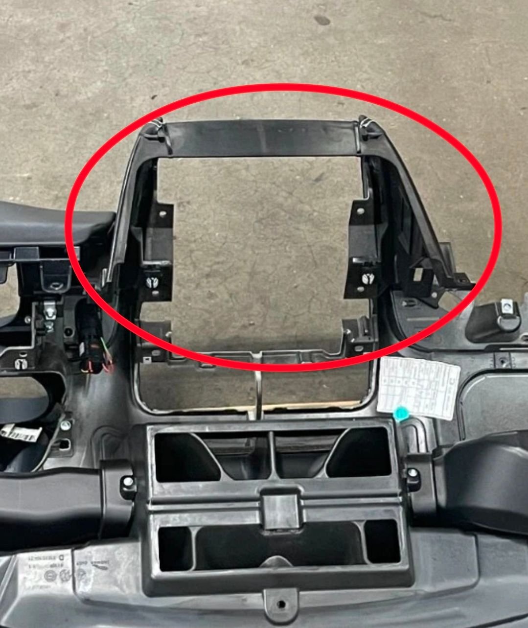

Another photo of this piece still attached to the dash. Shown from the underside.
Looks like this is impossible to remove without pulling the entire dashboard out of the vehicle.

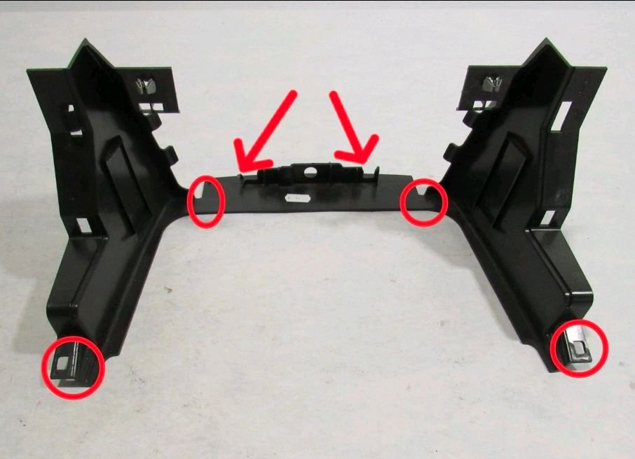

Mine broke at the mounting point by the glovebox. It crumbled in my hands.
Here are the common failure points. I don't think it's a common source of rattles, though. The glovebox might be the culprit, since there's a mechanism for soft close that commonly fails (also because of brittle plastic).
