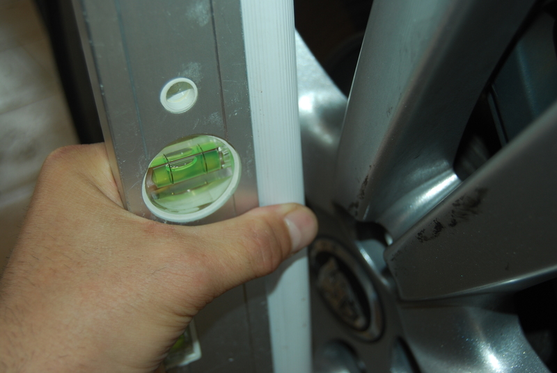

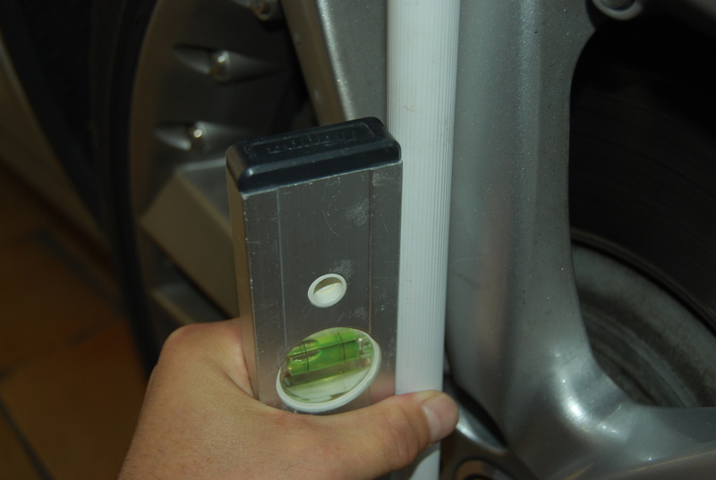

tomorrow I will have the throttle body cleaned. re the pulling issue:
I took measurements today again and there is 5 mm of height difference (today depending where i park on my flat parking) between top right arch wheel and top left arch wheel. 5 mm lower on the left where the car is pulling, what do you think, should we look for air shocks replacement or front control arms? yesterday while parking at approx. the same spot there was only 1 mm of difference. I hope it is not a constructor warranty issue that could be covered cause I talked about it since 4 months now...and i had my constructor warranty at that time. I bet you this should have been fixed under constructor warranty, i never seen a 14000 miles car pulling.

The rear wheels will only cause a change in direction when the geometry is not correct. With the front wheels, since the car is drifting to the left when not braking or accelerating (or when you are accelerating) that sounds like a suspension issue or a geometry issue. Also, if the geometry was set correctly, but some part in the suspension is not correct, this will make the geometry incorrect again very quickly. I will bet you have a bad suspension part in the left front.

yes I think the left shocks is to be changed and we rather changed both then.

Here is 2 images I wanted to show, let me know what you think,
first image is right front wheel, second image is left front wheel, (left wheel seems more straight)
in Santa rosa I knew an independent jag that won't use a computer but a rope to check the geometrie and correct it, or correct any driving issues, but it is good for the xj not the xk, as the front are smaller than rear, but with a xj if you attached a rope in the front and run your rope all along the car you can have a good view on the angles you have set.
here the camber angles are different.
right front wheel (if I want bring back the bubble at the level of the left front wheel, it is almost 2 cm of inclinaison needed on a 20 inches wheel!
Left front wheel
also left rear wheel is more straight than right rear wheel. so both left wheel are almost straight, and the right ones have some camber.
Can we still be in the green during the alignment with settings like this, it is surprising? Or does this hide an accident or a bad triangle or anything else?
Any ideas?
Left front wheel
Any ideas?
