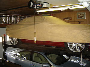

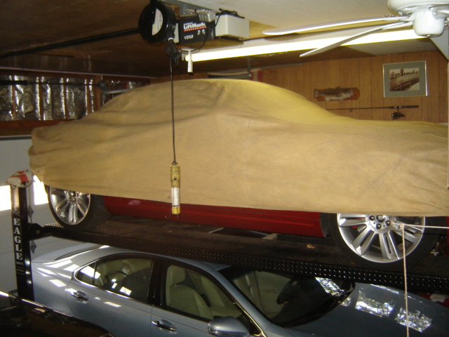

Wow I gotta admit you are going the extra mile. I'm a 3 - 3 1/2 season driver meaning I'll drive any time unless there is snow on the roads. I wait until the salt/calcium mix is either dry or washed off of the road and it's out I go. If we get a few days or a week of snow I put the cover on and wait until the roads get driveable. At my age there may not be a next year so enjoy the ride while you can.

You're setup is stellar - never occurred to me to put the XKR ABOVE my current car - I measured and think I have the height in my garage to pull that off, but for my garage door opener mechanism/motor that's mounted and suspended about 4/5 feet above my current car's roof - looks like yours opener motor is moved to the side and attached up at the ceiling level rather than suspended above the ground level car - was that a mod you had done to accommodate the car storage lift? It pulls the garage door up from the side rather than the middle?

It's still in the middle and mounted about 2" below the ceiling. Door tracks are also about 8" below the ceiling . Ceiling is 11' and the door is 8' x 16' . It's a typical set up for high ceiling . Liftmaster wifi opener that is belt driven. The lift is great for storage as well as working on my cars. Works for me as it turns my 2 car garage into a 3 car and if I wanted to put in another lift it would be a 4 car garage.

Jagtoes - disregard the question about the garage door opener motor (is there a way to edit a post on this forum?) - I see yours is a 2 car garage door so the motor IS in the middle I assume - mine is a single separate bay/door of a 3 car garage (wife and kids toys/shelves take up all of the 2 car bay) so my garage door opener is smack in the middle above my car/bay. I'm still going to poke around the internet for a solution to make space for a lift and somehow still have a motorized garage door opener...

where did you vuy this cover! i want one, looks
easy to take off and put on..please tell me the model and type of cover

It was given to me from my BIL after he sold his 2nd Corvette. It is a Cover Craft model called Sunbrella.

Get a Liftmaster 3800 side drive. Awesome and nothing above car

Yes, perfect! I've spec'd out the whole process - just need to extend the vertical tracks for the door so it goes up almost to the ceiling and then move the curved tracks up so they starts curving inward just before the ceiling... this BendPak lift would fit in my garage - although when I consider all the cost and hassle, I'm thinking I just need to get a shed instead and move out a bunch of the crap in the 2 car bay - only problem is I have a work bench in the garage I'm loathe to get rid of or move to a shed, and 2 cars won't fit in that bay unless I do... got to keep the wife happy whatever the case... I wonder what will make her happier: not spending $3k on a lift or moving all her and the kids stuff to a shed... or, me just putting this whole idea out of my head and leaving the car in winter storage till March like I planned... whenever several days go by and there's no snow or salt on the road all I can do is pine for driving that sweet machine...
