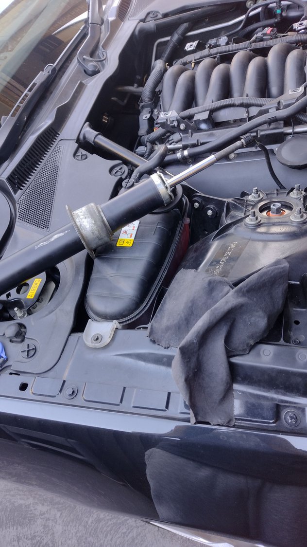

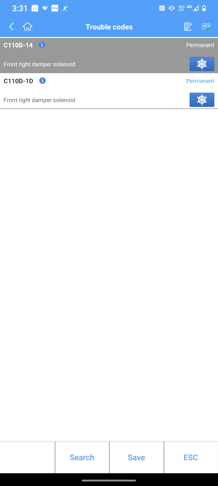

Brilliant little unit .
so upon registration you are entitled to one free manufacturer download obviously I went jaguar & every other manufacturer after that has a fee of roughly $20aud.
Straight away I was able to diagnose the issue
Down to my last spare shock argh
