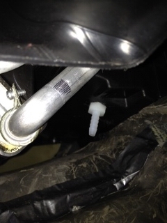

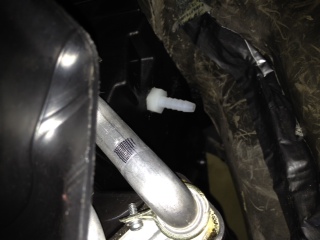

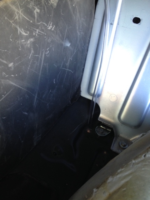

I'm to cheap to pull the dash or drop the tranny to fix a $2.00 part, so I tried the close the vents and blow like hell trick but it did not work for me. Then tried the bent tool to try to reach the duck bill from above the Tranny, but that didn't work either, so I decided to add my own drain...and that worked!
Here's how you do it:
1) remove kick panel on the forward edge of the door jam so the rug can be pulled back out of the way. Just snaps off easily.
2) Drill a 1/2" hole(double ck that) into the evaporator plastic box.**Go very-very slowly and stop immediately when you punch through so you don't drill into the evaporator fins that's on the other side. *important*

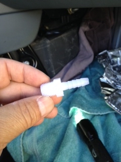

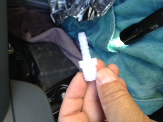

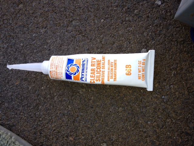

3) Buy a 1/4" nylon hose barb from Ace Hardware part#PL216 and screw it into the hole by hand to start it. Put alittle clear RTV on the threads. Screw it in with a wrench or socket until it's snug. Don't over tighten it and strip the threads. It doesn't need to be screwed all the way in. It's actually better to be shallow in the evaporator. It will drain easier.
4) Put 3ft of clear plastic tubing on the end of the barb (also from Ace Hardware) and run it to the floor board.
5) Drill a hole through the aluminum floor board just big enough for the tube and secure it with a tie wrap on the bottom of the car on the nearby bracket. Also, put some RTV silicon around the tube at the floorboard.
*Check the pictures for areas to drill on Evaporator box and floor. You won't hit anything on the floorboard.
5) Leave enough length so you can easily reach under the car and occasionally blow on the hose with your air compressor to keep debris off the hole, and you are done!
Cheap Hillbilly fix for under $10.
I hope this helps somebody on the forum that is as cheap as I am!

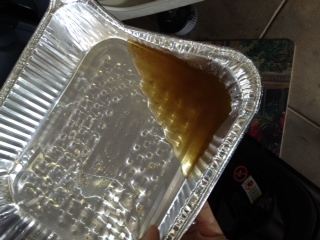

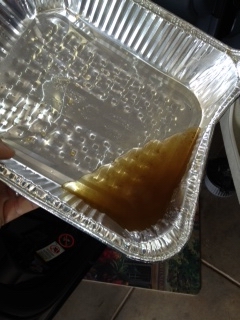

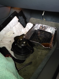

Awe Crap...my pictures never load right..sorry. If someone knows how, just rotate the pics to the right once.
The blower motor seen in one of the pictures comes off very easily with three screws, just incase you have to replace that, one day from being submerged in water to long. All that dirty water came off the blower motor.

It does fix the problem for me. I ran it around a few weeks before buttoning it up checking for interior leaking etc. I see water coming out of the hose so it's working. Try to put it low on the box to catch the most water.
You don't see anything different because it's all under the rug. The nice thing is there is a nice hose you can get to easily now to blow some air into the box. Your old duck bill might start working again.
The previous owner had the duck bill replaced under warranty, but back then they put the same one back on, so the problem returned for me.
Again sorry about the pictures. They need to be rotated a quarter turn to the right. Not techie enough to figure it out.

I have to ask Graham, that liquid looks like an oily mix? Did that come from the evap tray? It's a strange color for condensate.
That dirty water came out of the blower fan area, which came from evaporator . I guess when you see it on the ground it hides the color. That's the water that drips onto your passengers legs!
To Hawaii....sorry to say but the water I caught in a bucket (lots) was perfectly clear...not sure where your water came from.
Well if yours was clear I probably will have to replace my blower motor sometime in the near future. Probably rust from the windings being submerged in water for too long. The good news is the motor is easily changed with only three bolts! Not sure on the cost of one of those puppies though!
