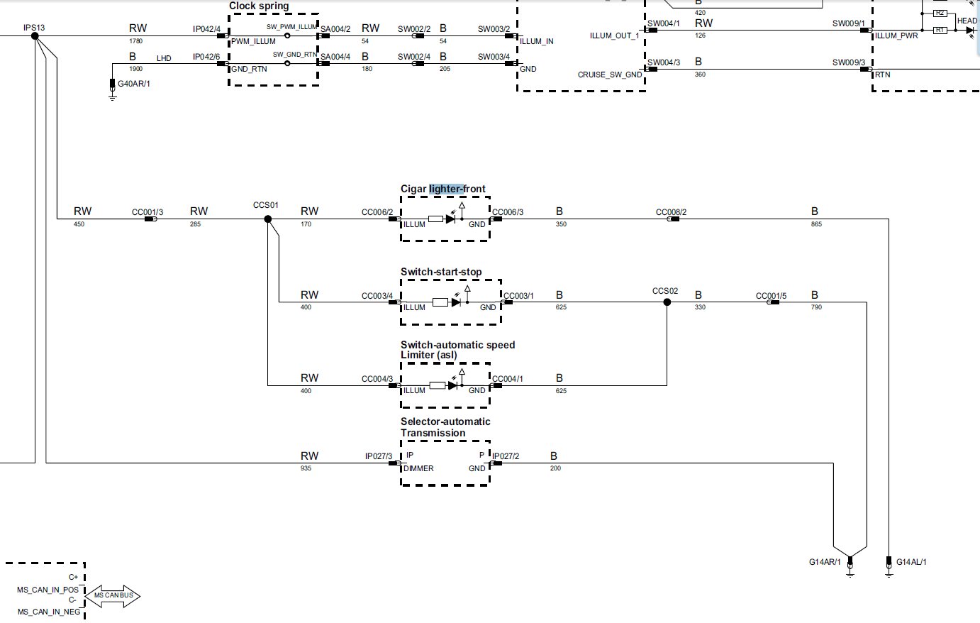

Looks to me like the cig lighter illumination is run off the same buss as the start button, ASL, and transmission selector illuminations. Are they out too?
V

Nothing else is out...

Diagram shows it as a LED, not a bulb.
