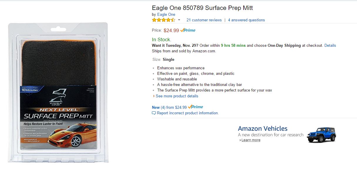

Throw your clay bars away fellows. This is the new technology. Speeds the clay process up tremendously. You can use the new polymer wash mitt and complete the whole car vs a clay bar in 20 minutes.
You can use any car wash soap as a lubricant.
Here's what you need. These 2 items can be used many times. Just rinse and let dry.
Eagle One Surface Prep Mitt for the larger areas like hood/bonnet, roof, quarter panels. The smaller NanoSkin Sponge for the small areas like rear fascia and front grill area.
You will not be disappointed in any way, and you will wonder, "Why didn't I know about these before?"
Quick image to enlarge, click again for full screen.
Attached Thumbnails Clay bath today-eagle-one-surface-prep-mitt.jpg   Clay bath today-nanoskin-sponge-1.jpg

I was going to add that I can do the XK with a nano mitt in like 20-30 minutes. When washing the car to detail it, I use dish washing soap instead of car wash soap. It's good a striping wax and suds are such a treat compared to car wash soap. If it's a car I have not maintained on a schedule, I like to use CarPro IronX before the "clay". It removes iron particles that on the pain surface. This alone already makes it feel near clay'd. Adds about 30 minutes to the process and stinks like crazy, but worth it if you want to be gentle.
Although just car wash soap is fine for the mitt to clay the car, I also spray lube on the car along with soapy water... I buy everything in gallons, so might as well use it, right?

Nice. Just ordered the mitt. Much cheaper than the Chemical Guys mitt.

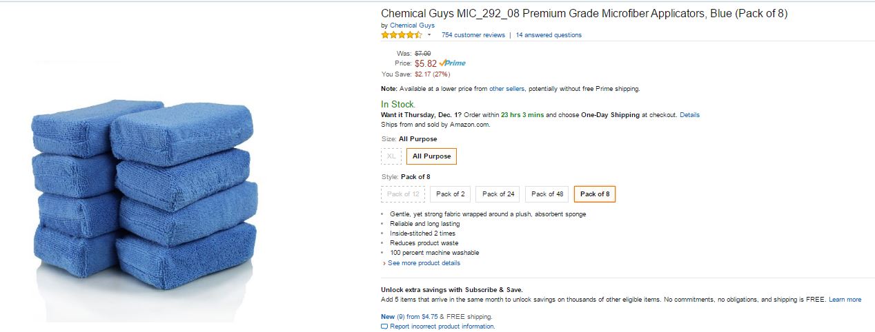

BTW: I apply my Lexol with a microfiber pad. Works great and takes all of 15 minutes to do the entire interior.

Many thanks Richzak for the tip. I will order these for sure. Also, I agree completely on Lexol for leather care. Be sure to use both the cleaner followed by the conditioner for best results. You would be surprised how dirty the sponge gets after using the cleaner prior to the conditioner.

I would suggest that once you apply the Gliptone Cleaner and then Conditioner, let it set in, buff with soft microfiber cloth and come back in another week, and apply a second coat of the conditioner only.
In the meantime, if you can acquire a few of the microfiber applicators, it will make the application of the conditioner so easy and extremely quick. No need to rub it in, just wipe the leather down gently the second time.
