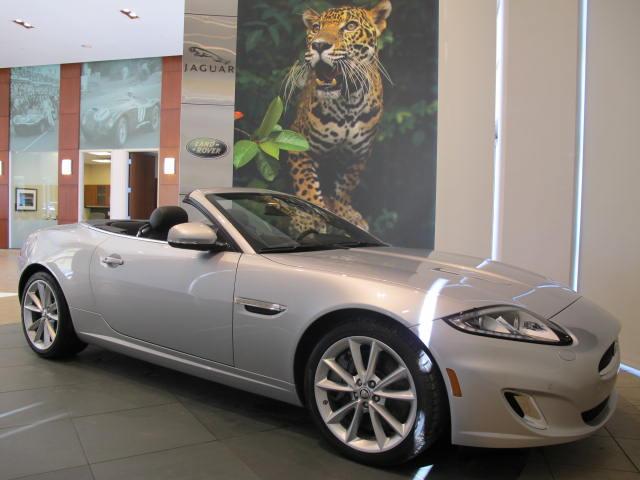

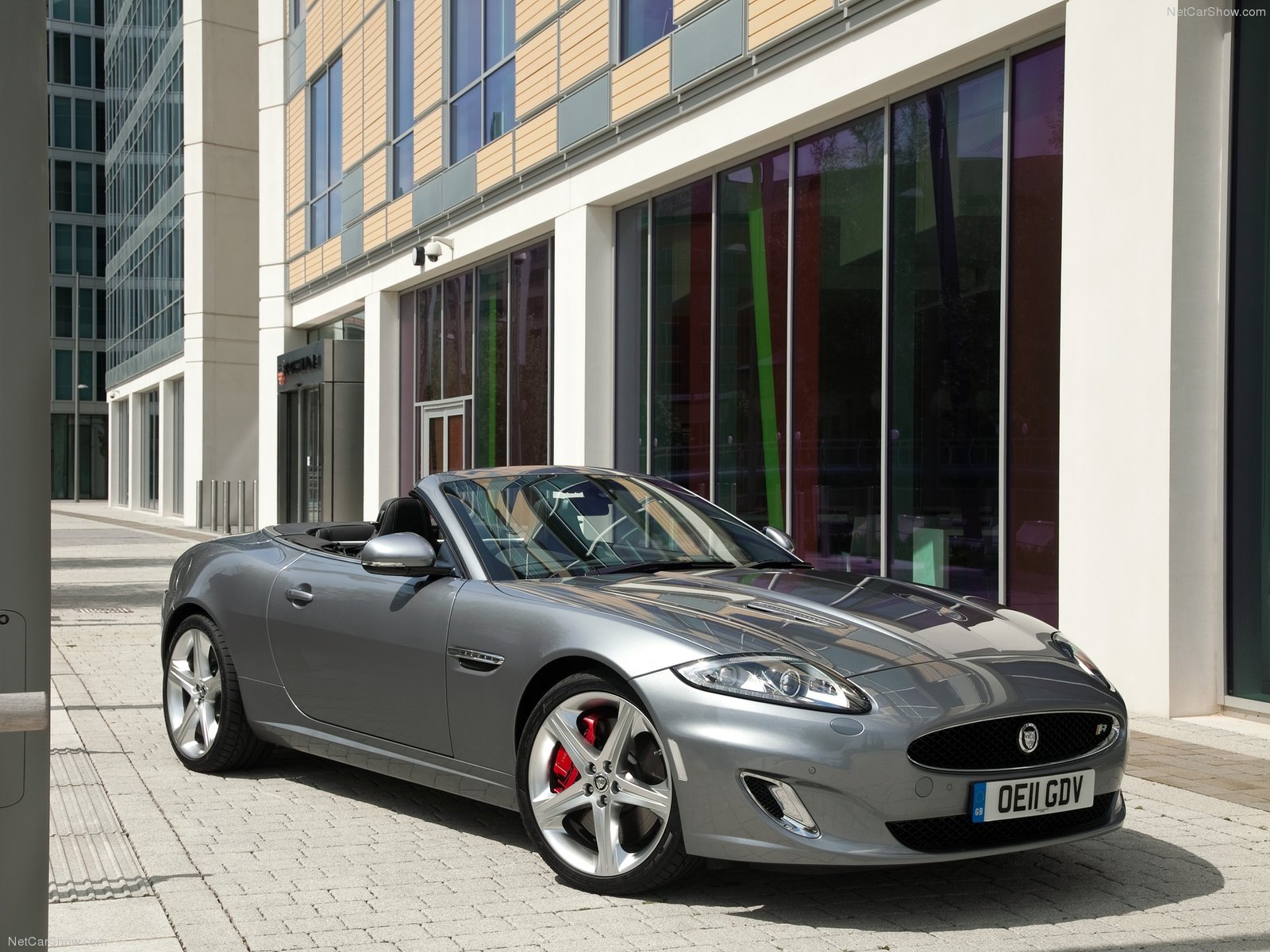

Hey Guys,
Now I know this might be considered pretty minor, but I was wondering if anyone has put clear side markers on their XK's (as they do in Europe see pic on left). I find it's a much cleaner look than the orange ones we are subjected to here in North America. Is it just me? Has anyone on this side of the pond done a conversion? If so, please let me know where you got them.
Cheers,
Attached Thumbnails Clear side markers for 2012 XKR in Canada/US-jaguar-xkr_convertible_2012_1600x1200_wallpaper_04.jpg   Clear side markers for 2012 XKR in Canada/US-1959662846902048046_11.jpg
