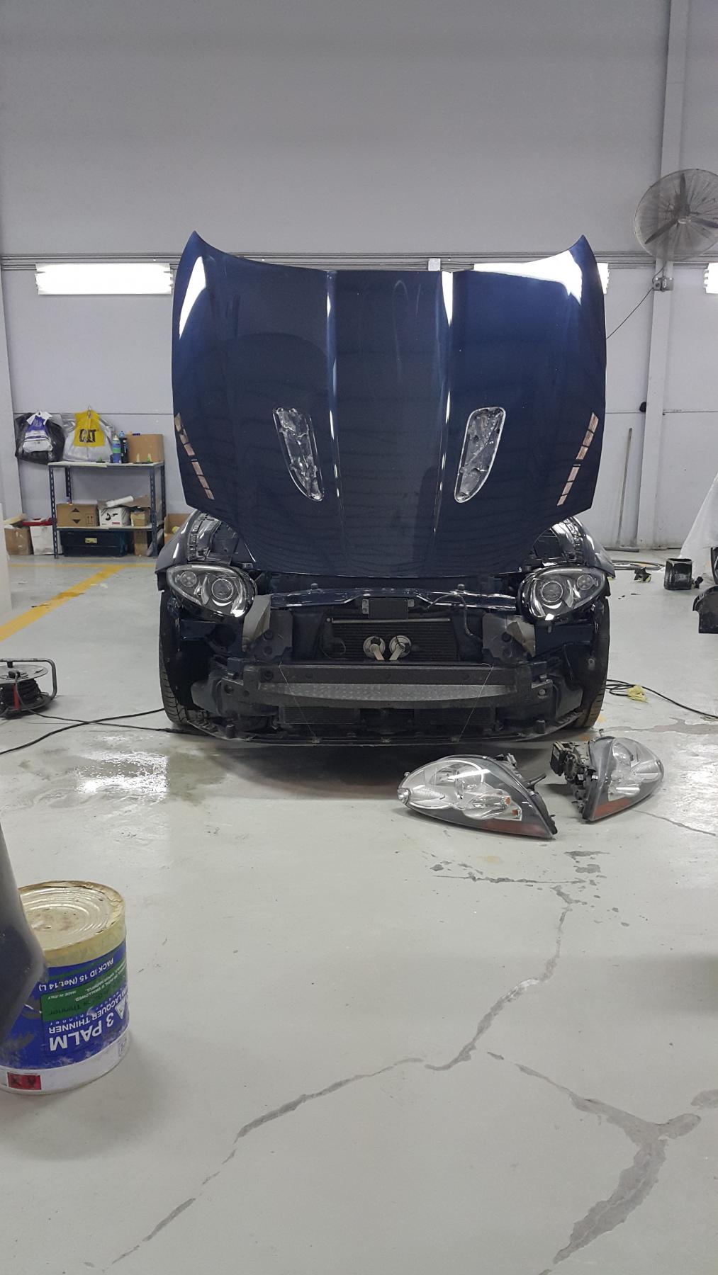

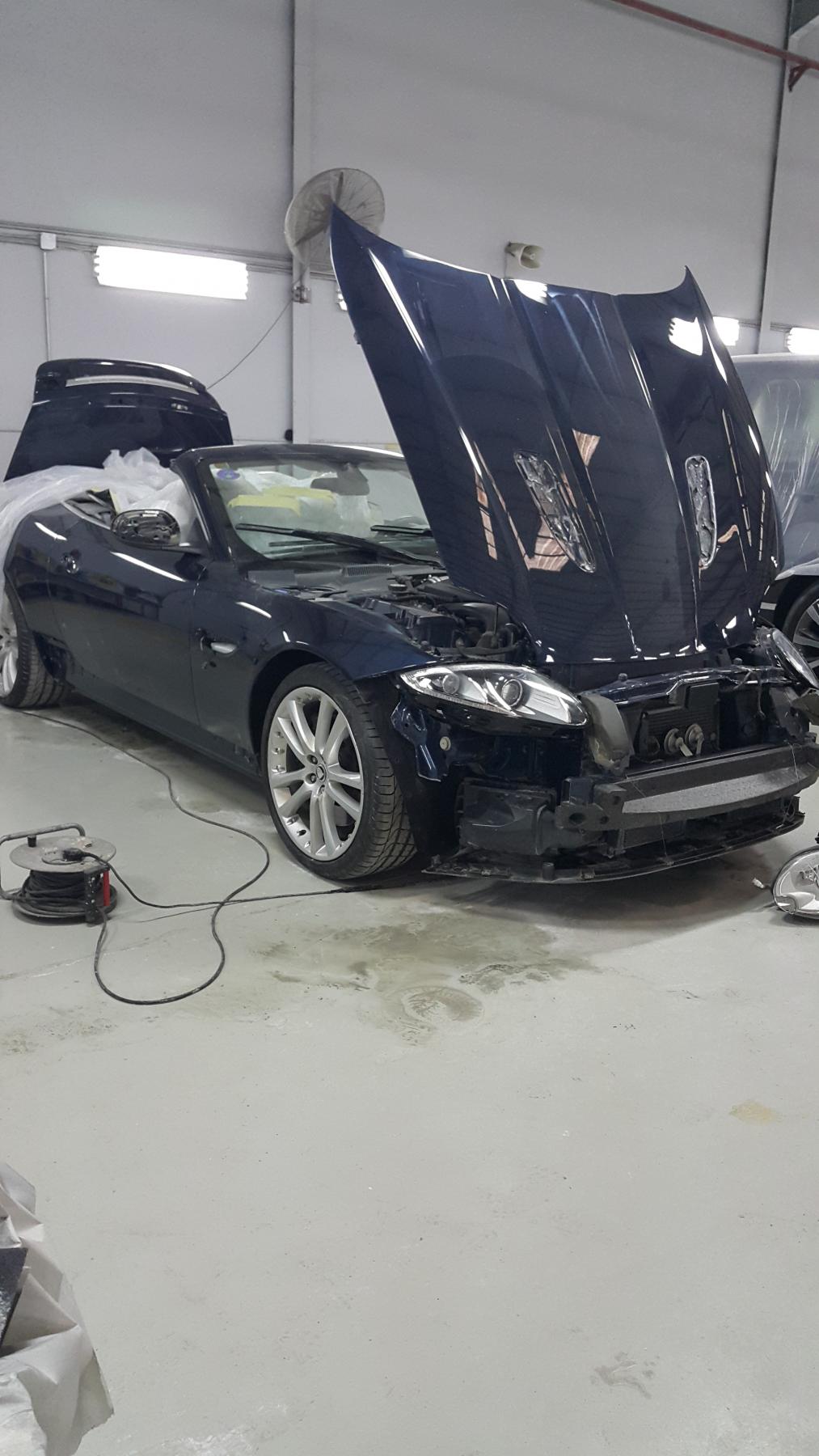

Now iam in the final step ( installation )
for the rear lights I wish I will not facing any problems cuz I will use georgekale instructions from the PDF and I already ordered the mentioned parts
but for the front headlight the electrician told me he need the instructions for installation and I didn't find clear explanation on the internet .
any body can help me with these
Thanks

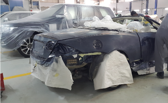

Default Hello !!
Wake upppp and help me Plzzzzzzzz
Attached Thumbnails Conversion for Jaguar 2009-1110.jpg   Conversion for Jaguar 2009-1111.png
Old Feb 18, 2015 | 02:12 PM
Ngarara's Avatar
Posts: 3,425
Likes: 1,140
From: London, UK
Probably it's because there's few people on here who have done this kind of 'nose swap'. I can only suggest you go to JagDocs and download a copy of the workshop manual:
Jaguar XK8 XKR X150 Documentation
There are instructions for removing & installing the headlights in there.
