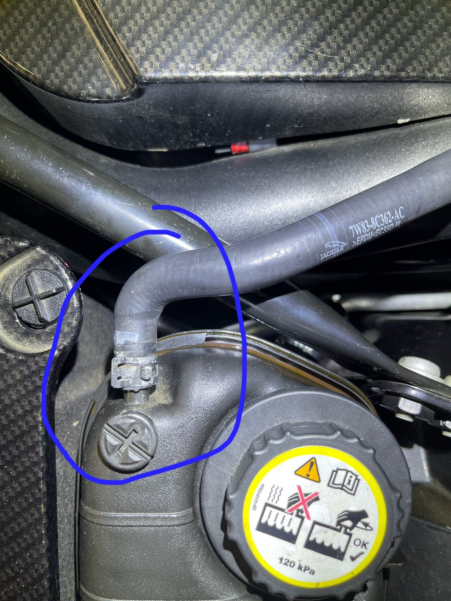

Going back on topic, I found the culprit.
followed the wife to drop off our workhorse suv for her timing belt/water pump combo and test her out.
Parked to wait and thought, eh, I’ll open the bonnet and take a look.
Yep, coolant. Maybe a tablespoon.
( See pic below )
It’s the top nipple now near the bleed screw.
Wiggled it a bit and noticed when I push down on top, there is a small stead stream coming out.
( Attempted to attach a video )
She never went above 201F in a 20m round trip with a lot of idling. Thank goodness.
fun times.

that is where mine cracked also, NA not SC but...
as to you temps, in Hot Texas mine are similar to your posted ones except in the summer I can see 220 in heavy traffic with an ambient of 110(f). It does quickly drop once moving but it is scary. I investigated and it is within the operating range Jag states...CeeJays waterless coolant looks better and better to me.

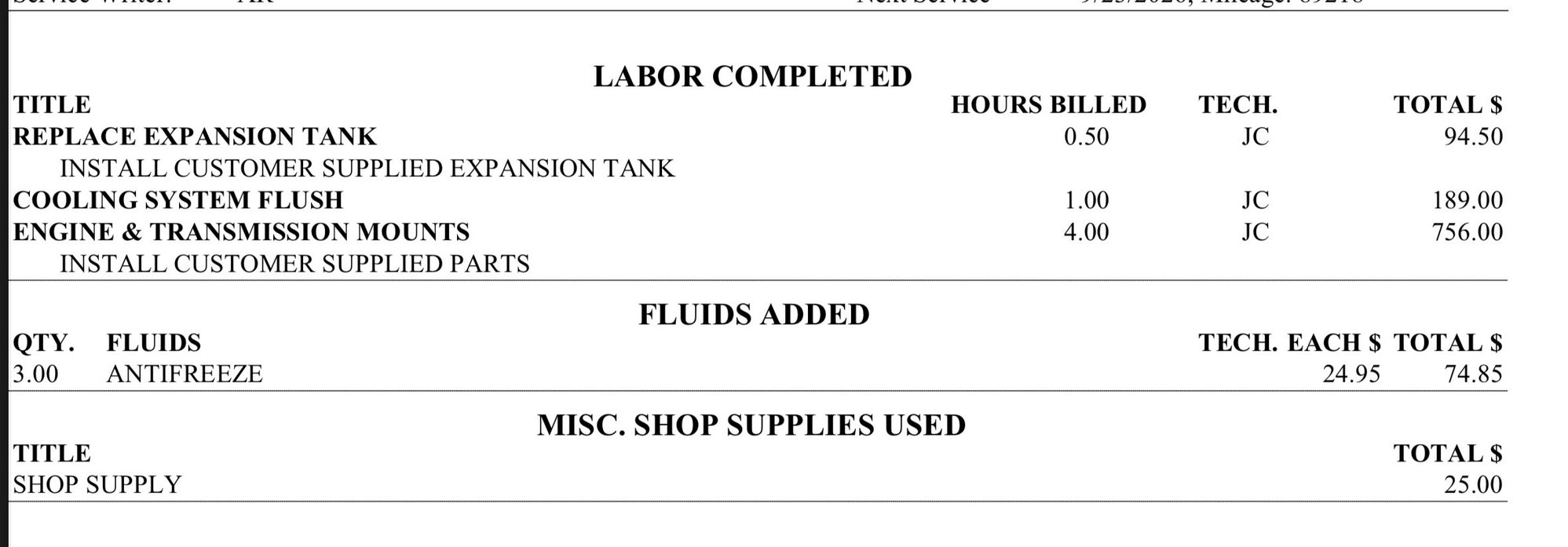

Looks like I’ll just have the shop do it. Only charging 30mins of labor.
Doing the mounts anyway. But almost $200 for a flush and fill? Ouch.

$25 per gallon for prediluted antifreeze also seems incredibly high priced.

Yeah, tempted to bring my own, lol.
But I did find out that is normal for the coolant flush.
Just picked up the old pilot from a diff shop after getting the timing belt and water pump done.
Before I walked out I said “I know it varies, but what’s the range for a coolant flush/fill?”
He said $150-250.
