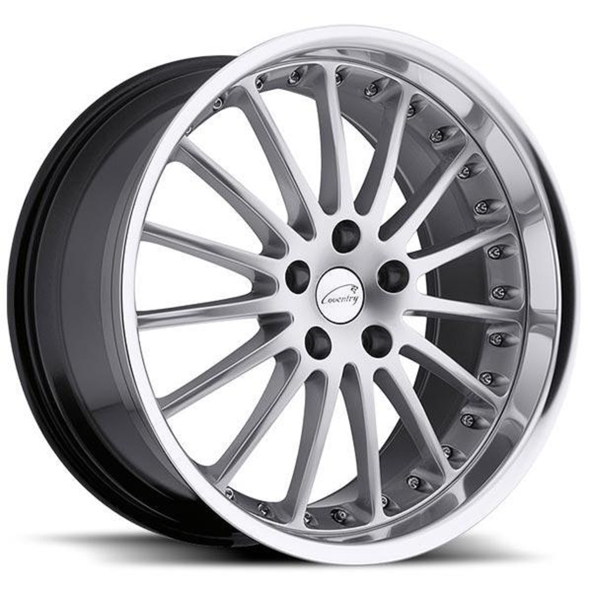

I prefer the Whitley, as shown on the coupe from the Coventry Wheels gallery:
The Hornet just reminds me of the 5-spoke American Racing mag wheels of the '60s, which were very popular on American muscle cars (and still are). Just too boy racer for my taste.
In my opinion, the Whitley is a more sophisticated design that fits with the overal design of the 2009 XKR Portfolio. The above picture doesn't do justice for the Whitley design since you can't see the details of the (fake) rivets or the width of the front and rear wheel lips. It's a one-piece cast wheel, with a 2-piece look. The chrome lip goes well with the other chrome accents on the car.

Whitley Wheel Specifications
SIZE PCD ET BORE LIP SIZE
17x8 5/108 42 63.4 0.75"
18x8.5 5/108 42 63.4 1"
18x9.5 5/108 25 63.4 2.25"
19x8.5 5/108 42 63.4 1"
19x9.5 5/108 25 63.4 2.25"
20x10 5/108 25 63.4 2.75"
20x8.5 5/108 42 63.4 1.25"
20X10 5/108 45 63.4 2.75"
17x8 5/120 25 73.9 0.75"
18x8.5 5/120 20 73.9 1"
18x8.5 5/120 30 73.9 1"
18x9.5 5/120 20 73.9 2.25"
19x8.5 5/120 20 73.9 1"
19x9.5 5/120 20 73.9 2.25"
20x10 5/120 25 73.9 2.75"
20x8.5 5/120 20 73.9 1.25"

Update:
Although Coventry Wheels are specifically made for the Jaguar brand, when the wheels came into the tire dealer (Discount Tire), the rear wheels would not fit over the Alcon brake calipers.
For those 2009 Jaguar XKR Portfolio Edition owners with the Alcon brakes, wheels are extremely difficult to find due to the small offset of the wheel required to fit the Alcon brake calipers.
In most cases wheels have to be custom built for this Jaguar model.
The Coventry Whitley wheels Hyper Silver w/ Chrome lip is one awesome looking wheel. I was extremely disappointed to find out the rear wheels would not fit the car. The offset I needed is not available. Need positive offset +20 or lower.
If you are changing wheels and want a fantastic look, I highly recommend the Coventry Whitley wheels providing you can get proper fitment.
