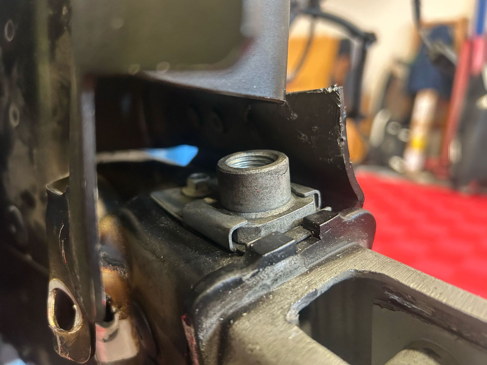

Also, anybody knows where to get this piece? it didnt come with the new chassisleg, and has been ripped out of the donor piece, car only has 1 at the moment, and we need 2 ofcorse to connect the subframe...

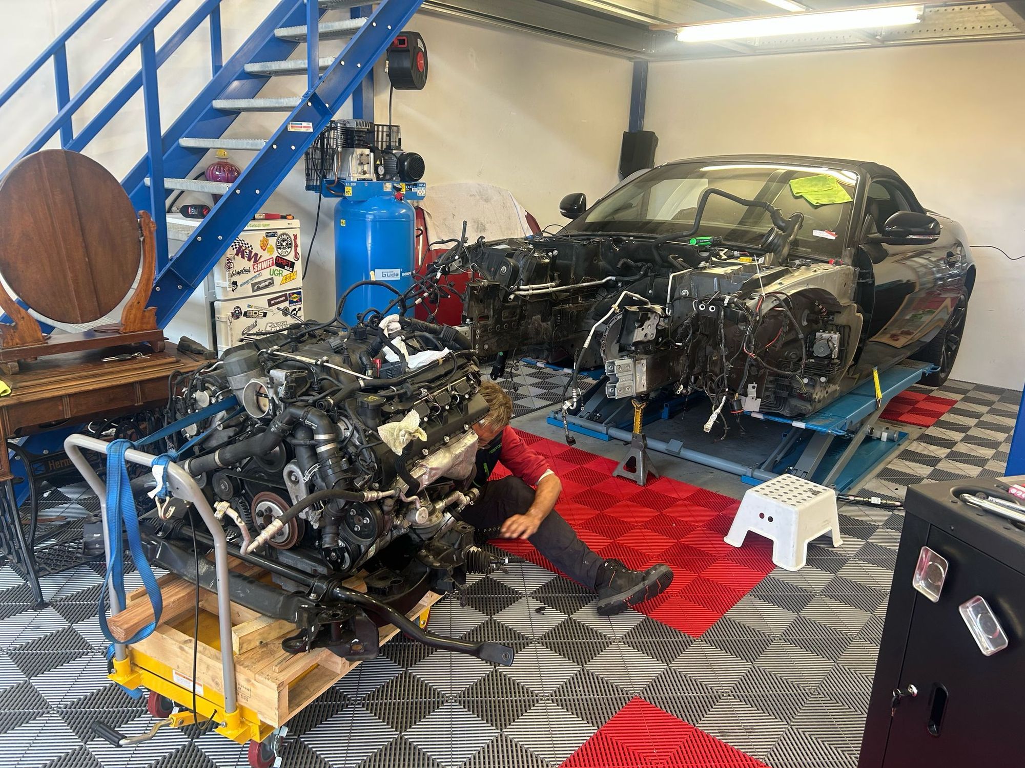

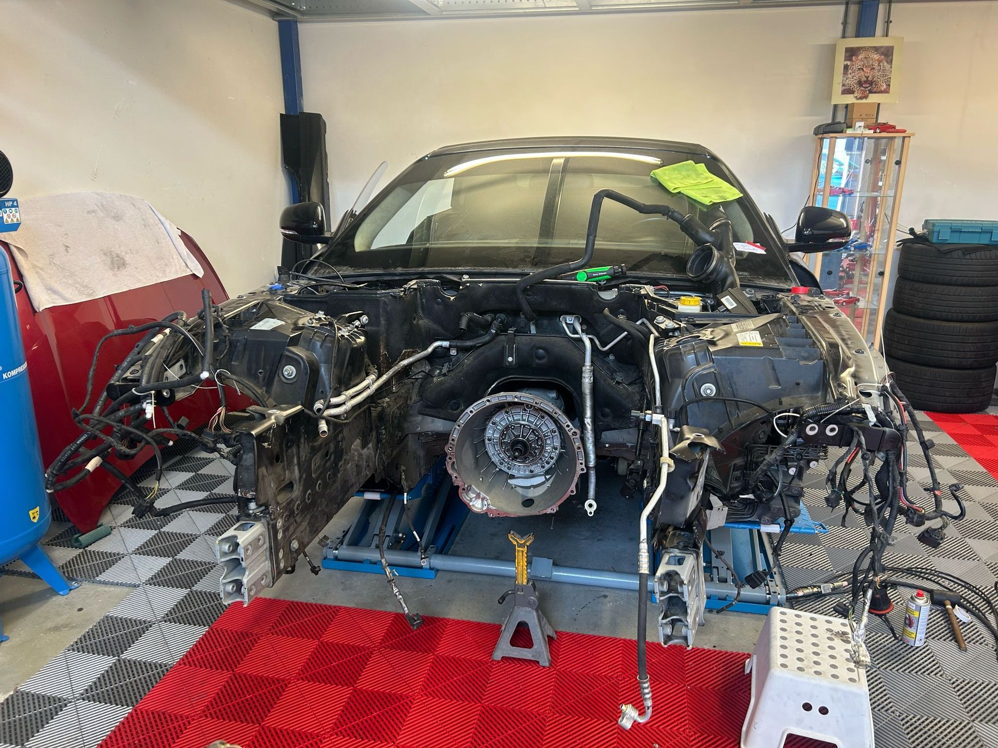

So, little update and backstory
So the backstory to this project, My mother has always dreamt of an XK convertable (in red, with white top and white interior specifically, but thats unicorn spec), she now has her Mini Roadster JCW for 8 years and my dad and i thought it was time to replace said MINI. However as said before we also looked for a project, and while scrolling on marktplaats.nl (local ebay/gumtree/kleinanzeige etc) i found this car for sale and the damage looked minor at first.
tbh, if we were a little more skilled, we would have probably been able to do it quicker and with less work, as we have to replace the chassisleg as we pushed it back wrong, and it tore... (see below picture)
As most might have figured out from these 2 pics, we got the engine out tuesday, now to strip the chassisleg and replace it... itll be a big job, but o so worth it when its finally completed (hopefully somewhere this summer we hope...)
Hopefully we continue next week again
