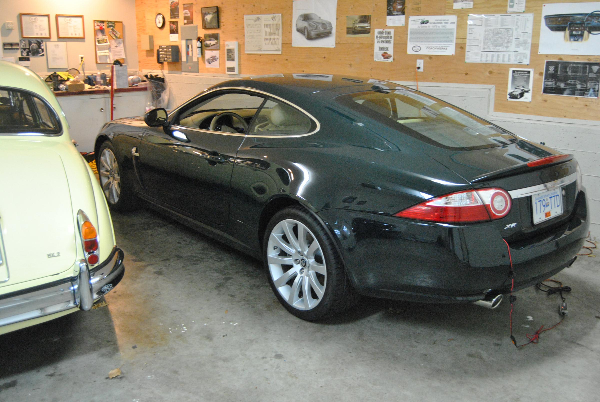

I have used the CTEK charger for years; on my XK it is permanently mounted directly to the battery. The installation did not require ANY special procedure - not even the locking of the car (why? you are simply connecting one lead at a time, with the charger NOT plugged in). My leads are connected to the battery leads at the bolt - not to the battery terminal, so there is not disruption of voltage to the car itself. The CTEK lines are then run under the trunk liner and the snap connector sits outside the car when in use. The CTEK unit is always outside the car - thus allowing constant monitoring by the indicator lights of what is happening. This is not a difficult installation in any way, and it ensures 100% battery function at all times - and that means no mysterious electronic issues on the XK.

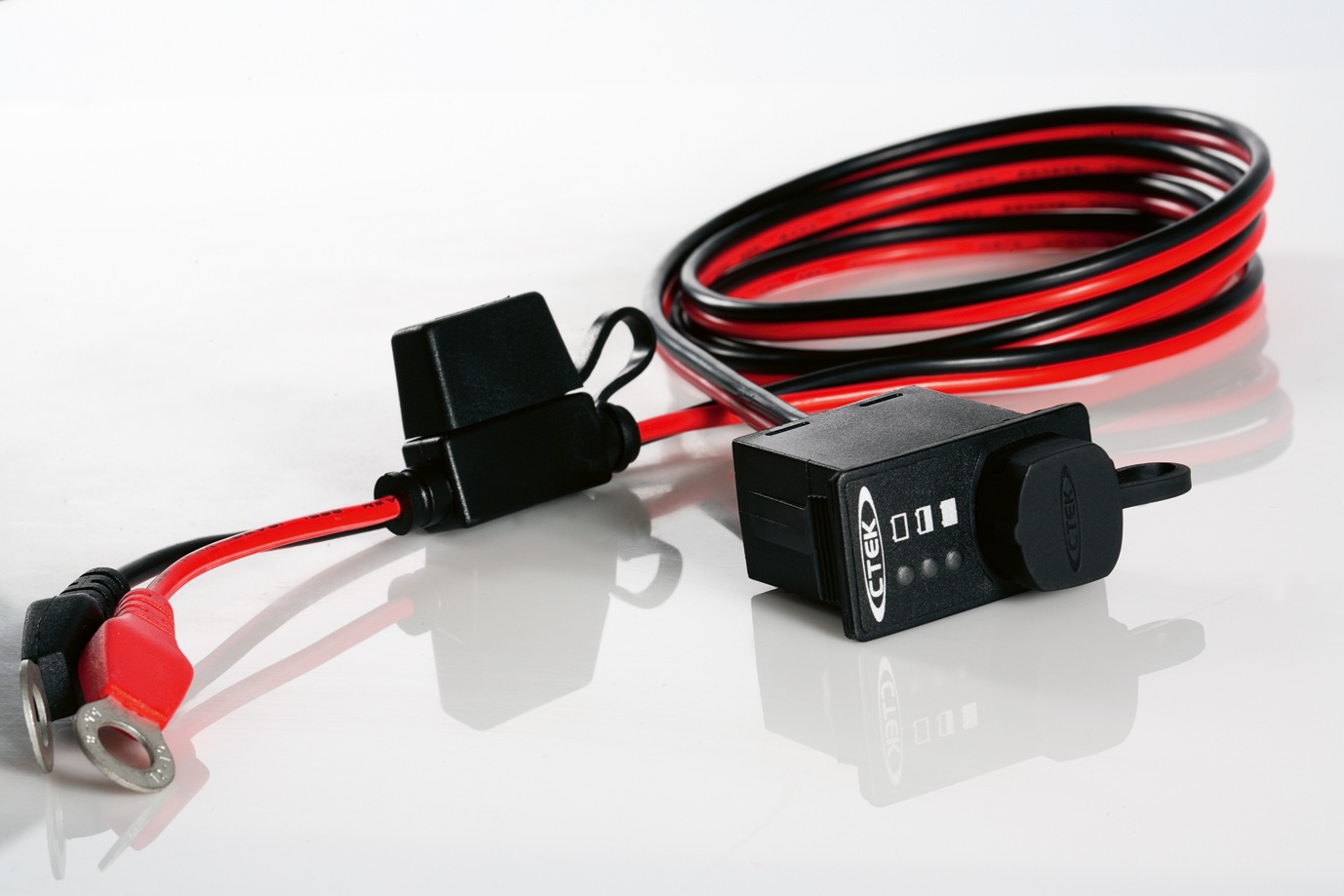

Has anyone done an install using the CTEK 56-380 Comfort Indicator Panel for a finished look in the trunk or perhaps on the underside exterior lip of the trunk lid (a much more complicated install if it's even possible, but would be cool).
Installing the CTEK with the 56-380 will provide a very clean look. The only way I see where to place it is making the cutout in the spare tire cover and mounting from the bottom, or on the side panel within the trunk.
You would have to make sure the indicator panel is secure because you would be connecting and disconnecting the CTEK cord. I am not sure how the 56-380 secures to the panel.
You would not be able to see the indicator lights unless you open the trunk lid. The CTEK 3300 has the indicator lights on the charging unit. I have mine fixed to a cabinet that sits next to the Jaguar at eye level, so I can see the indicator lights at all times from any vantage point in the garage.
