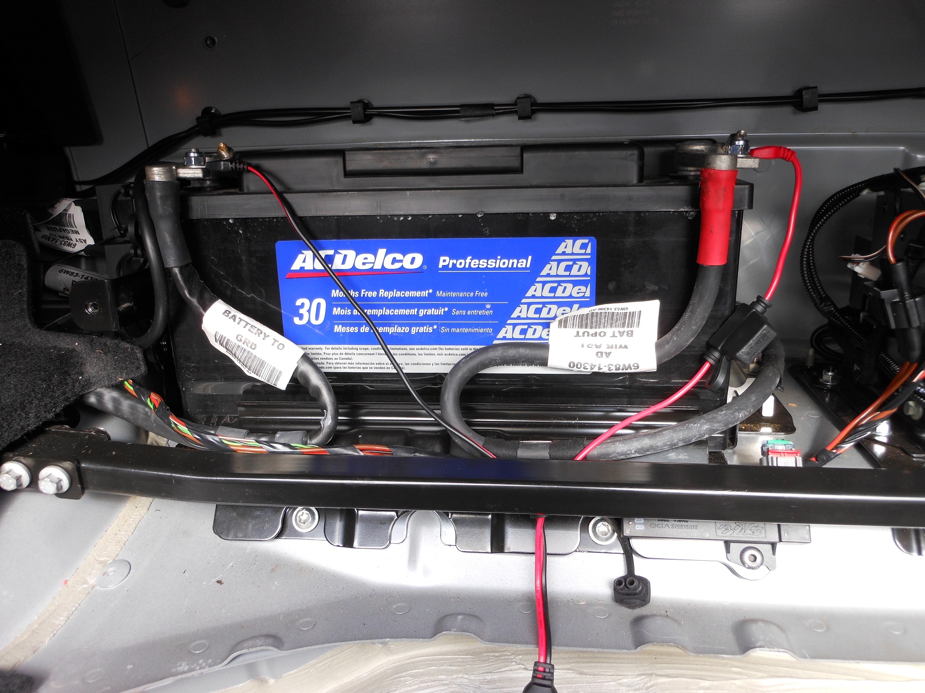

As many of you already know, I am a big fan of the CTEK smart battery chargers especially the CTEK 3300. Many of you have purchased this smart trickle charger on my recommendation. Many have asked how to install the CTEK. So I thought I'd show a step by step process on how I have my CTEK 3300 installed on my 2009 XKR convertible.
It is a simple process that should take no more than 10 to 15 minutes to install. Also, I have suggested that if you buy the CTEK 3300 to also purchase the CTEK 8' Comfort Extension. As you will see from the photos, the length of the CTEK cord that has the terminal round connectors is quite short. You want to attach the CTEK 8' Comfort Extension between the short lead cord and the charger cord. It has a quick connect/disconnect plug. This will provide plenty of extra length to secure your CTEK charger to a wall or cabinet, thus eliminating the need to keep it on the garage floor. With the extension you can place the cord under the spare tire for a nice clean look. In addition, if you keep your car under a car cover such as mine, the car cover will fit over the cord without any problems. There is plenty of room when the trunk is closed that the CTEK cord simply comes out of the tail end, without any damaged to the rubber seal of the trunk.
I strongly feel that anybody that owns a Jaguar should have one of these smart chargers hooked to your car battery. It will eliminate so many problems and electrical gremlins that might effect the electronics of the car. Your battery will always be fully charged. I realize there are other name brand chargers, but in my experience the CTEK charger works great and is highly reliable.
Hope this info helps.

Rich, you can leave the black and red cables on the battery kept in place by the lug nut and the cord in the trunk just like that? You just unplug the extension cord and throw the cord in the trunk and no need to take off the red and black cables at the battery? When u are placing those red and black cable onto those areas of the battery does any power leave the car such that reprogramming of the computer is needed? I am SO IGNORANT when it comes to the workings of a car that I know...that I don't even know...what I don't know!!! What I would love to see is have you unhook everything from scratch and make a YouTube video that we could all follow second by second. I think I am very concerned of being negligent and either requiring a computer reprogramming from power loss or WORSE...frying the whole blasted thing!!!! :O
Old Dec 7, 2013 | 07:08 AM
Stuart S's Avatar
Posts: 10,124
Likes: 7,127
From: Atlanta suburbs
Loth,
You have nothing to be concerned about by leaving the cord (dongle) attached to the battery itself or the remote battery terminals. Just don't get the connector wet or otherwise short it out. Although I don't have a Ctek charger, my BatteryMINDer charger dongle has been attached to my car for years without any issues. I plug that dongle into the lead to the charger every time I park in my garage. My original battery is still in good shape after 5 years.
Stuart
Old Dec 7, 2013 | 09:22 AM
richzak's Avatar
Posts: 3,294
Likes: 1,250
Lothar:
If you go with this installation route as mine, you DO NOT loosen or remove the main battery terminals from the battery. There is no reprogramming necessary. The power from the battery to the cars electrical system never gets disconnected.
On my 2009 when you remove the cover from the trunk to gain access to the battery, you will immediately see a small threaded post on the main battery terminals. One sticking up on the red, and one sticking up on the black. Take at look at yours. Then just take the small round terminal connectors from the CTEK, place them over the small post, and use a nut to secure the connector and you are done. About 10 minutes total time to install.
The CTEK red terminal has an inline fuse, so you know it's the red lead or positive and the wire is clearly marked in red as shown in my photos.
It's easy. I suggest that you simply remove the 4 thumb screws to the rear panel, remove and take a quick look. You will find the tiny posts immediately.
When the installation is done, using the CTEK 8" comfort extension, you simply unplug for the main cord (shown in my photo on the floor outside the trunk) and throw the cord into the trunk. Close trunk lid, jump in drivers seat, press the start button, drive away, and have fun.
It's also nice to see whats behind the panel, like your navigation system disc box.

For what it's worth, it's a 10mm wrench and on my 2010 XKR convertible the negative battery cable did not have the extra attachment point so I had to use the screw that holds the negative cable to the battery. I never took the negative cable off but it becomes very loose so be careful. I also had to cut the attachment spade on the battery tender cable as the cars negative battery cable attachment screw is not designed to easily come of all the way.

I have not yet gotten around to remove the trunk battery cover in my Coupe to view the battery setup. My question is this. Can the eyelet connection to the battery be draped directly into the spare tire area with the battery cover put back and secured without making any additional accommodation for the chord to get through? Does it get pinched anywhere? Is the trunk setup for the Coupe with regards to the battery cover and spare tire cover similar to the convertible?
