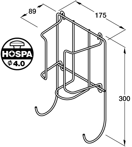

Further, for those of you who have a different kind of charger that isn't as easily wall mounted as the CTEK looks to be, here was my solution. My charger is basically a 3"x4" box, with no hardware to wall mount. Leaving it on the garage floor or sitting loose on a bench didn't satisfy me, so here's how I mounted mine. I purchased an iron wall mount as pictured below. The charger simply slides in between the metal brackets and sits on the mount shelf. I then pushed the bracket arms together for a snug fit. The hooks at the bottom are perfect for wrapping the cord when not in use. Mounted on the wall, it is much easier to check charging status and I don't have to worry about moisture issues.
