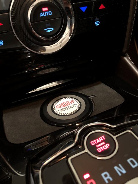

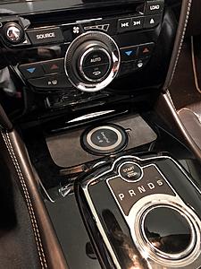

After noticing that my XK's ashtray area is an *exact* fit for my iPhone X, I came up with this 5-minute project that creates a secure, non-slip cradle that also takes advantage of the phone's wireless charging feature. Biggest challenge was finding a small enough charging pad, but once I found one, I just used some of my daughter's craft foam to create an insert that fits perfectly in the ashtray area. With a little tweaking, I think it should be possible to make it so that the sliding cover can still close when there is no phone in place. Don't know if the dimensions work for any other phone, but it is an absolute perfect fit for an iPhone X

As one of those finicky owners myself, I can tell you the beauty of this literally 5-minute "mod" is that it's not really a mod, since reversing it simply involves lifting the foam insert out of the ashtray and unplugging the usb port from the lighter. As a non-smoker, the only downside for me is my loose change is harder to get to.
It shouldn't be hard to make it where the ashtray cover can slide over it when there's no phone, but I'll need to get a 90-degree USB adapter that would allow the pad to sit lower and flusher. Once I find one, I can tweak the foam cut-out so that it has slots to fit in between the dividers and sits flush enough to allow the cover to close. In the meantime, I found this cool Jag logo and printed a decal to go over the charge pad which I think doesn't look half bad "Custom" Clutter-Free Wireless Charging Pad-kyrnrjul.jpg

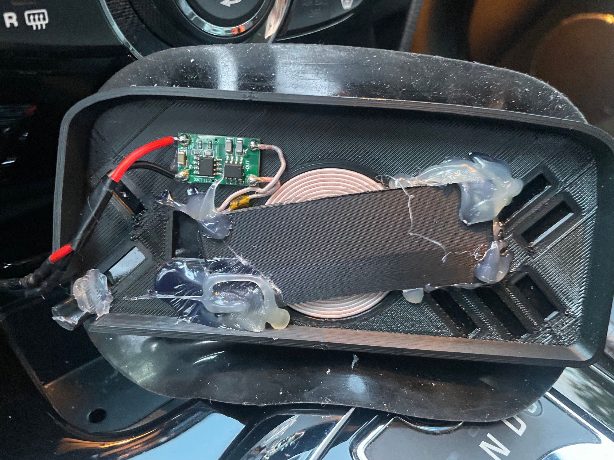

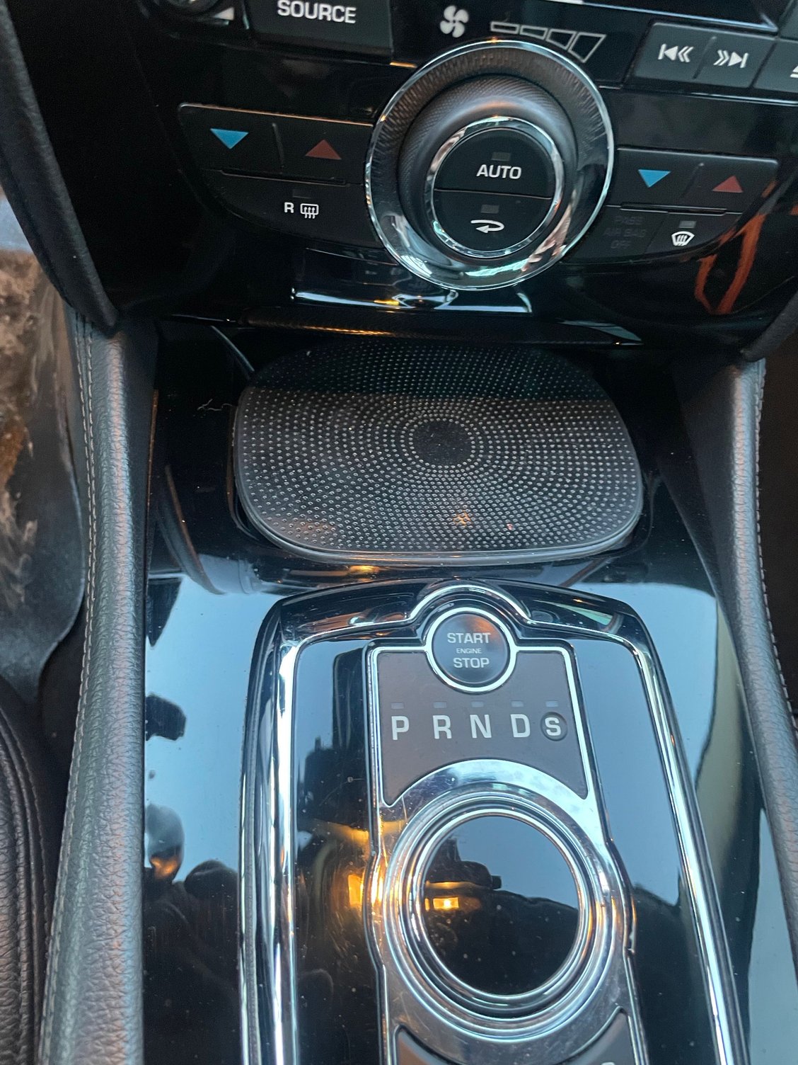

My version, with a non slip pad since my wife’s phone is larger than the tray opening, a 12v-5v converter, induction coil and a drop-in 3d printed tray. I power it from a fuse bc my cigar (per Jag lingo) is not working and is a pita to disassemble the console.
