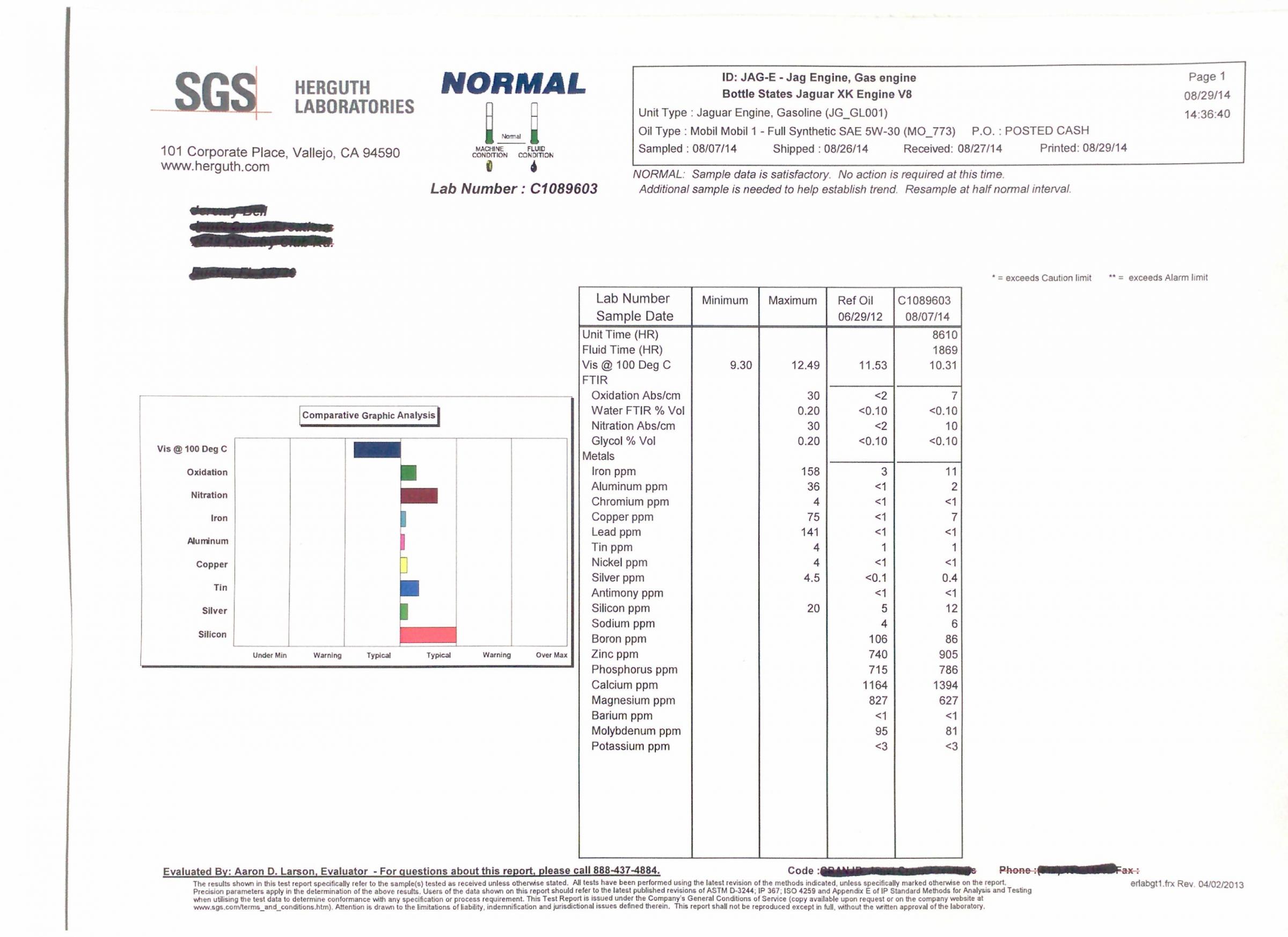

Default Oil Analysis Data
OK, I got the results on the sample I sent to the Laboratory, and I'm following-up, as promised...
The Car:
2008 XK, 8610 miles at the time of the sample.
The Oil:
Mobol One 5W-30, changed 1869 miles and 17 months ago.
The Results:
The main data is in 4 columns, with pretty self-evident Minimum and Maximum values.
The "ref Oil" is a new sample of the same weight oil (but not necessarily the same brand).
The last column, dated 08/07/14 is the results for my sample. (This is the first sample - when I submit subsequent samples, they will be listed as well, and the graph will show cumulative values to catch any Trends).
The analysis shows the viscosity and water and anti-freeze contamination of the sample, followed by the various metals found.
Its important to look at the reference column here, because you want low values of some metals (Aluminum, Copper etc) that are created by engine wear
and high values of others (Boron, Zinc etc) that are present as anti-wear additives.
I'm certainly no Tribologist (the people who study lubrication) but I'm pretty sure that this oil is in good shape, and I'm not planning to change it.
It looks like the engine is doing fine too, but I'll need to do additional sampling to plot the trend, and determine what 'normal wear' is.
As an additional benefit, when I eventually sell my car (and we all do, eventually) I have a data-driven answer to the question "Why didn't you change the oil for xx miles/months"...
