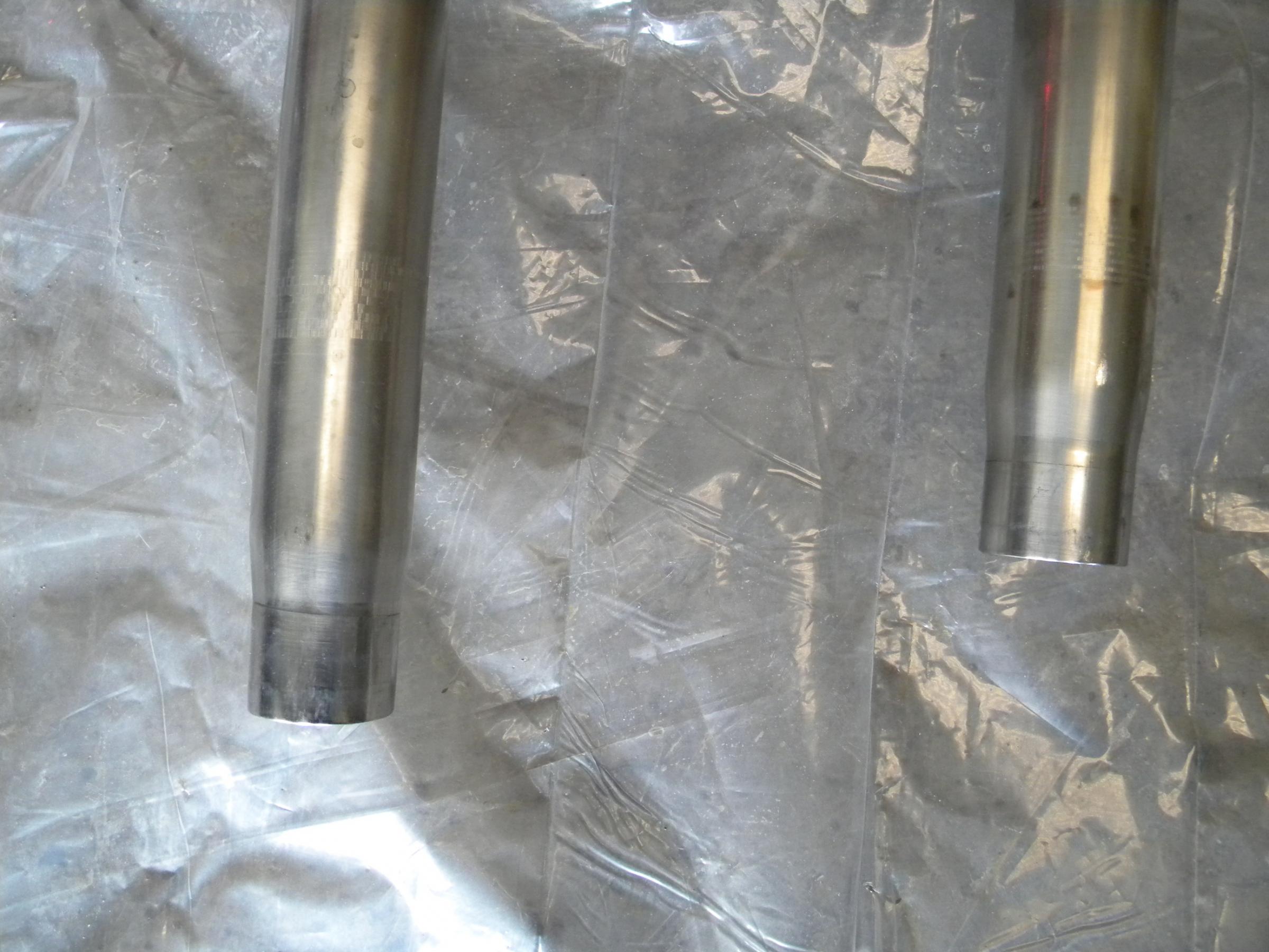

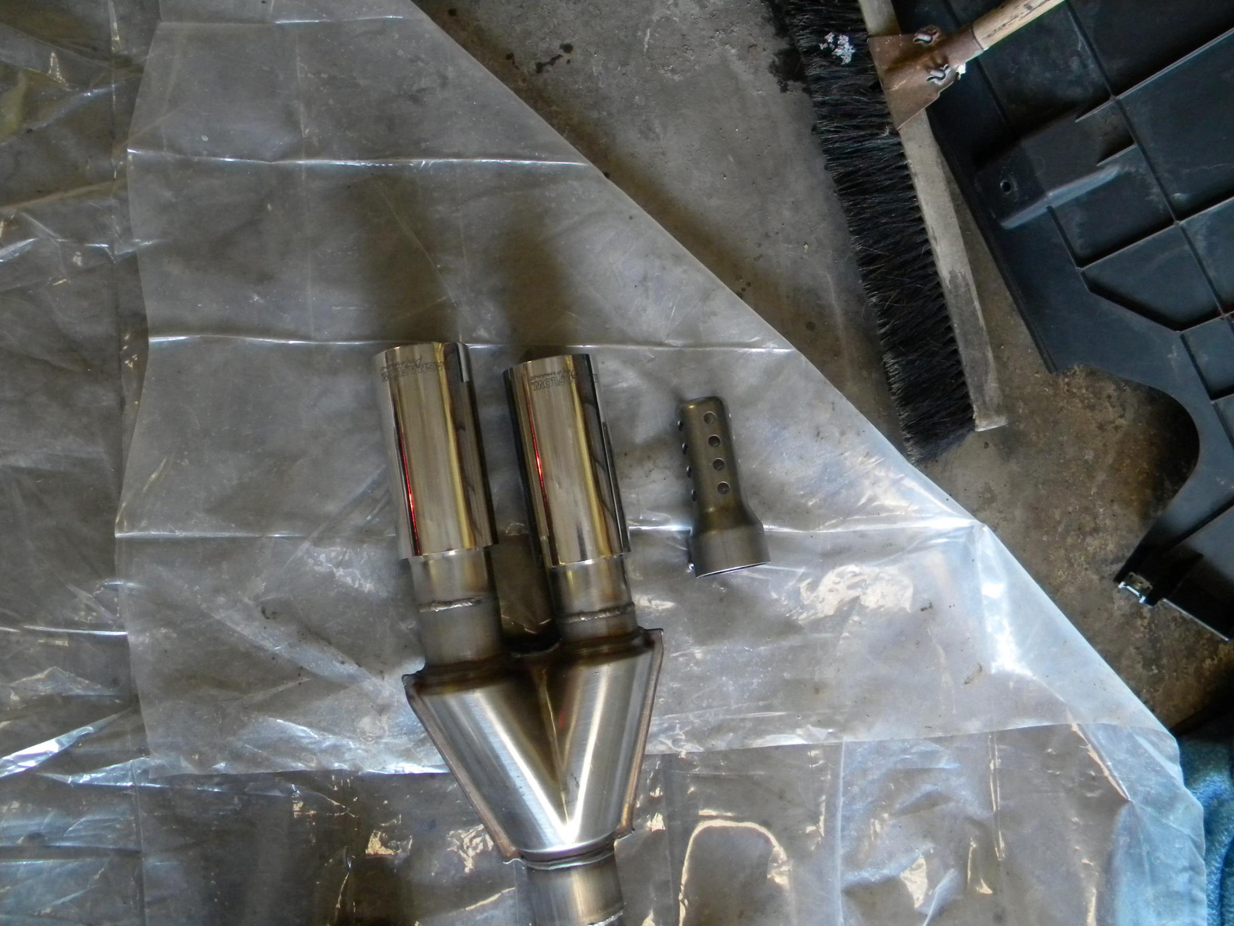

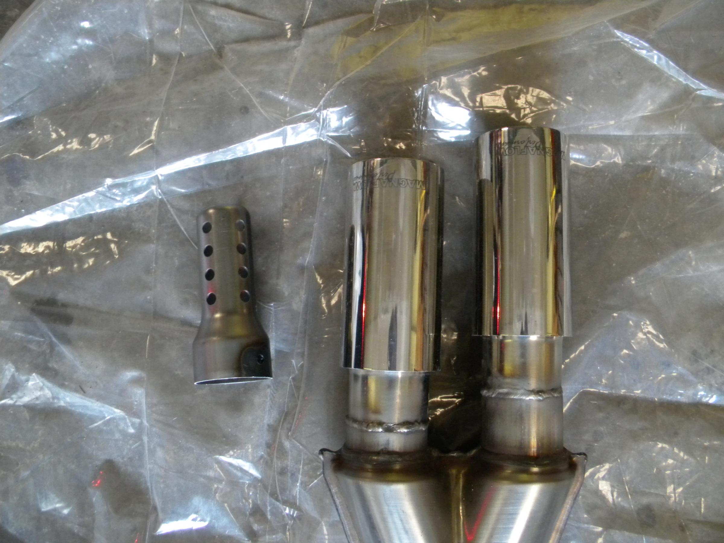

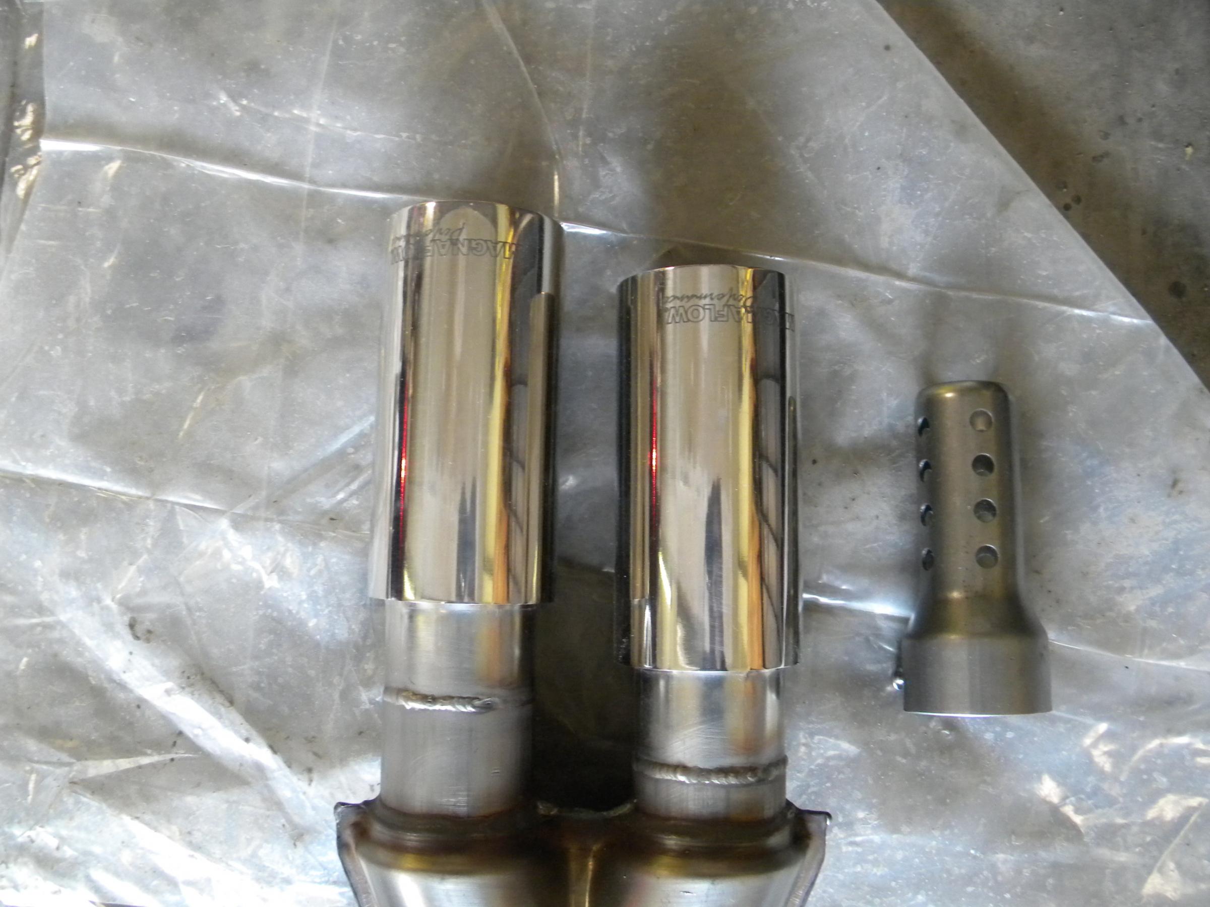

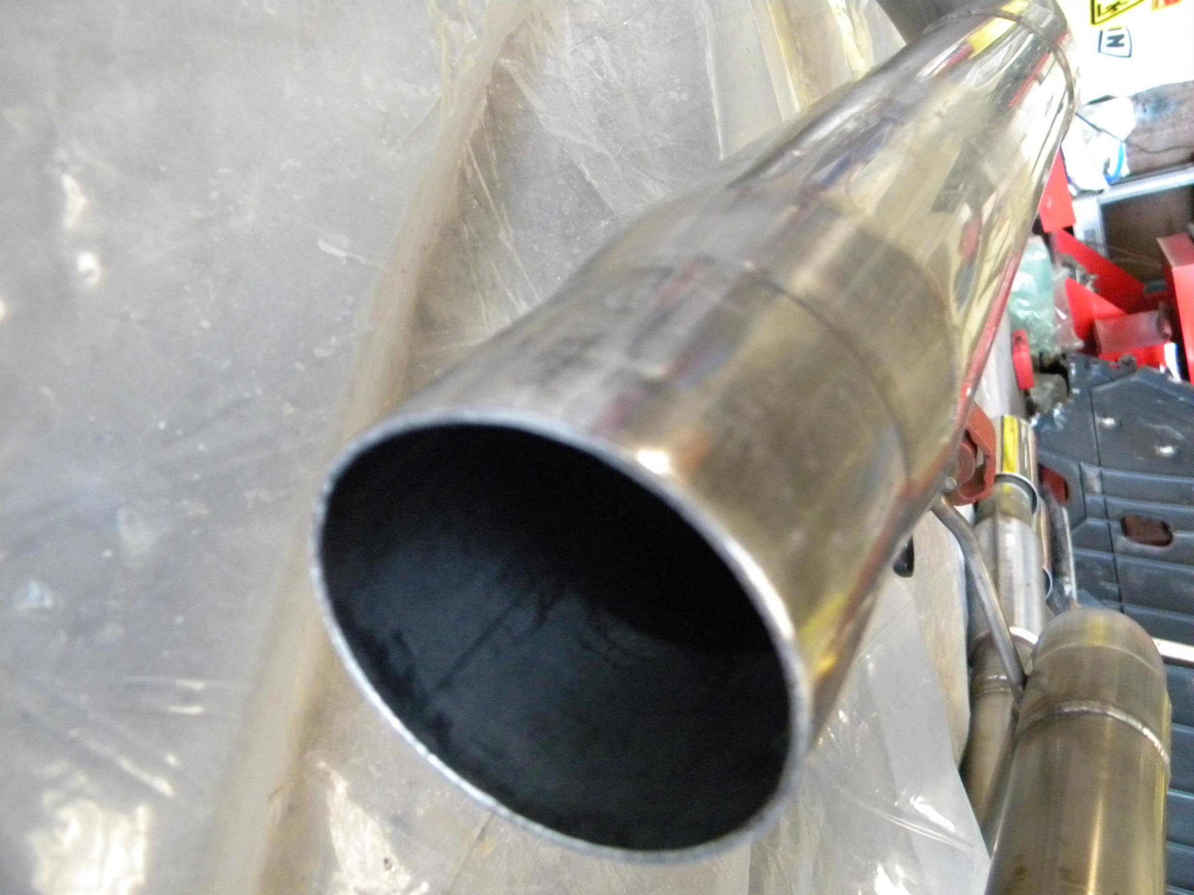

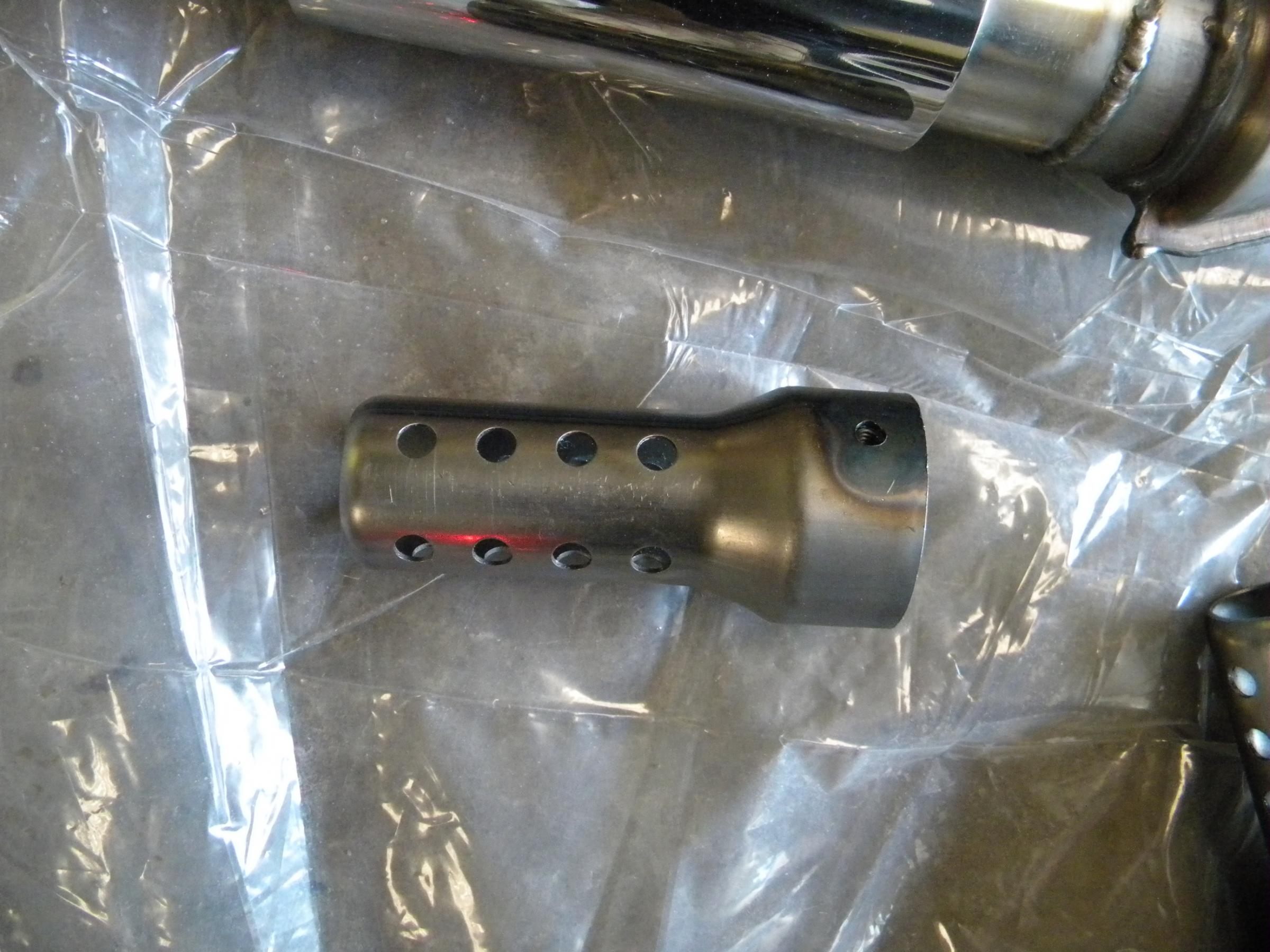

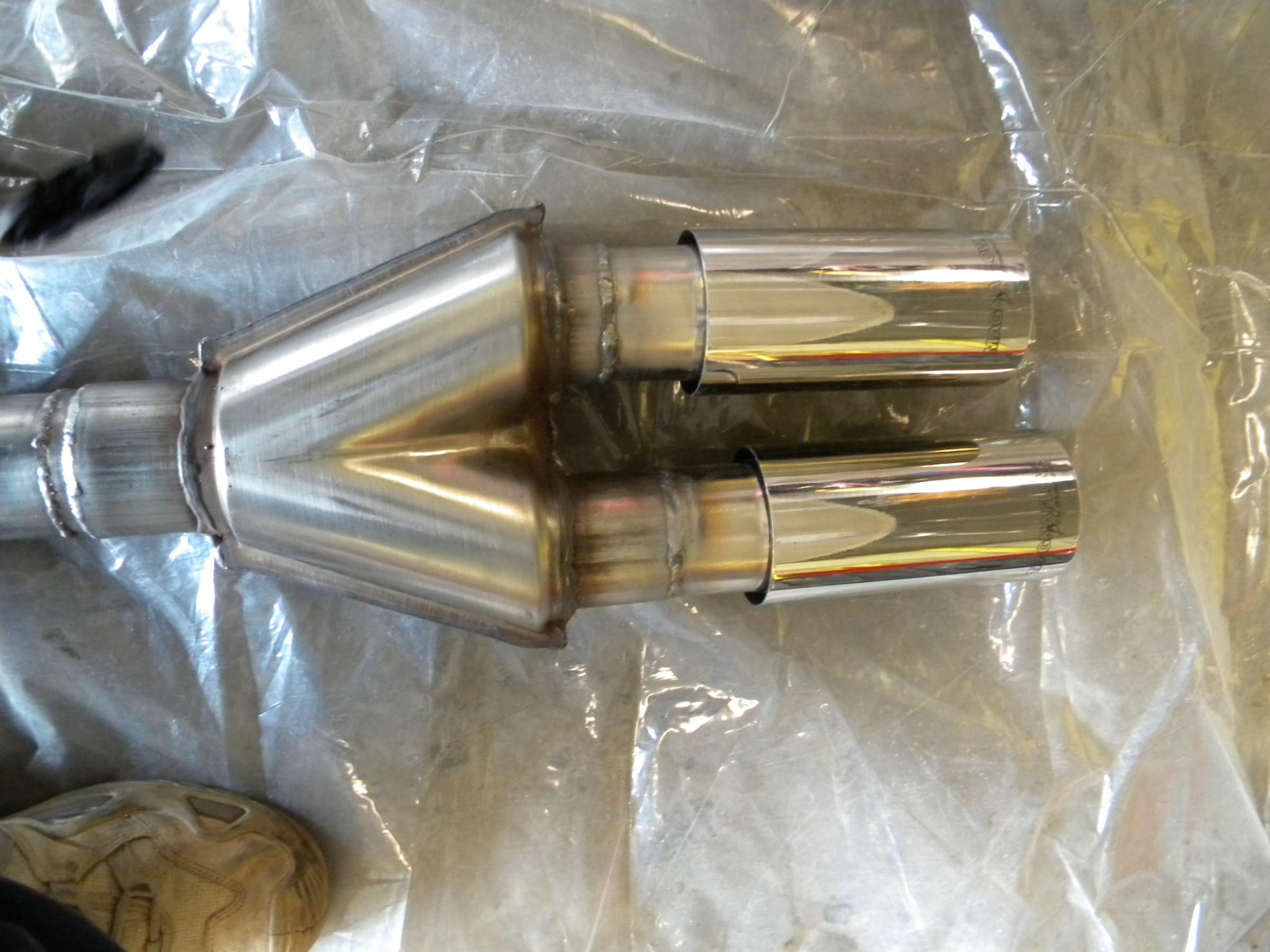

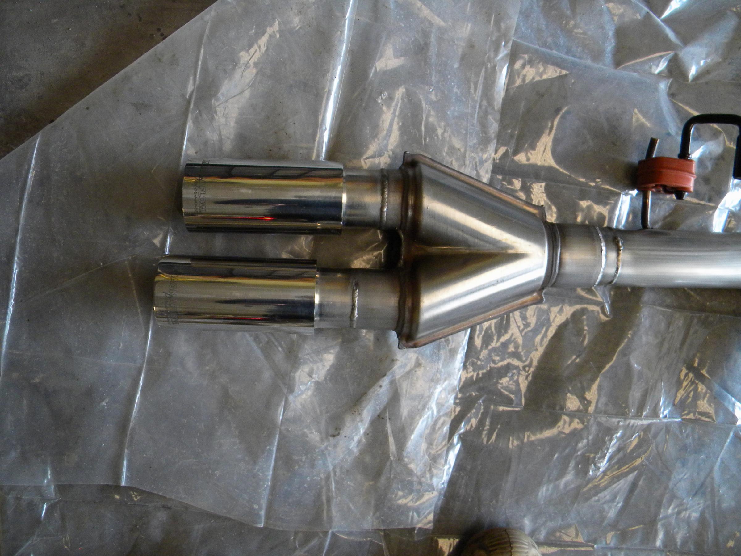

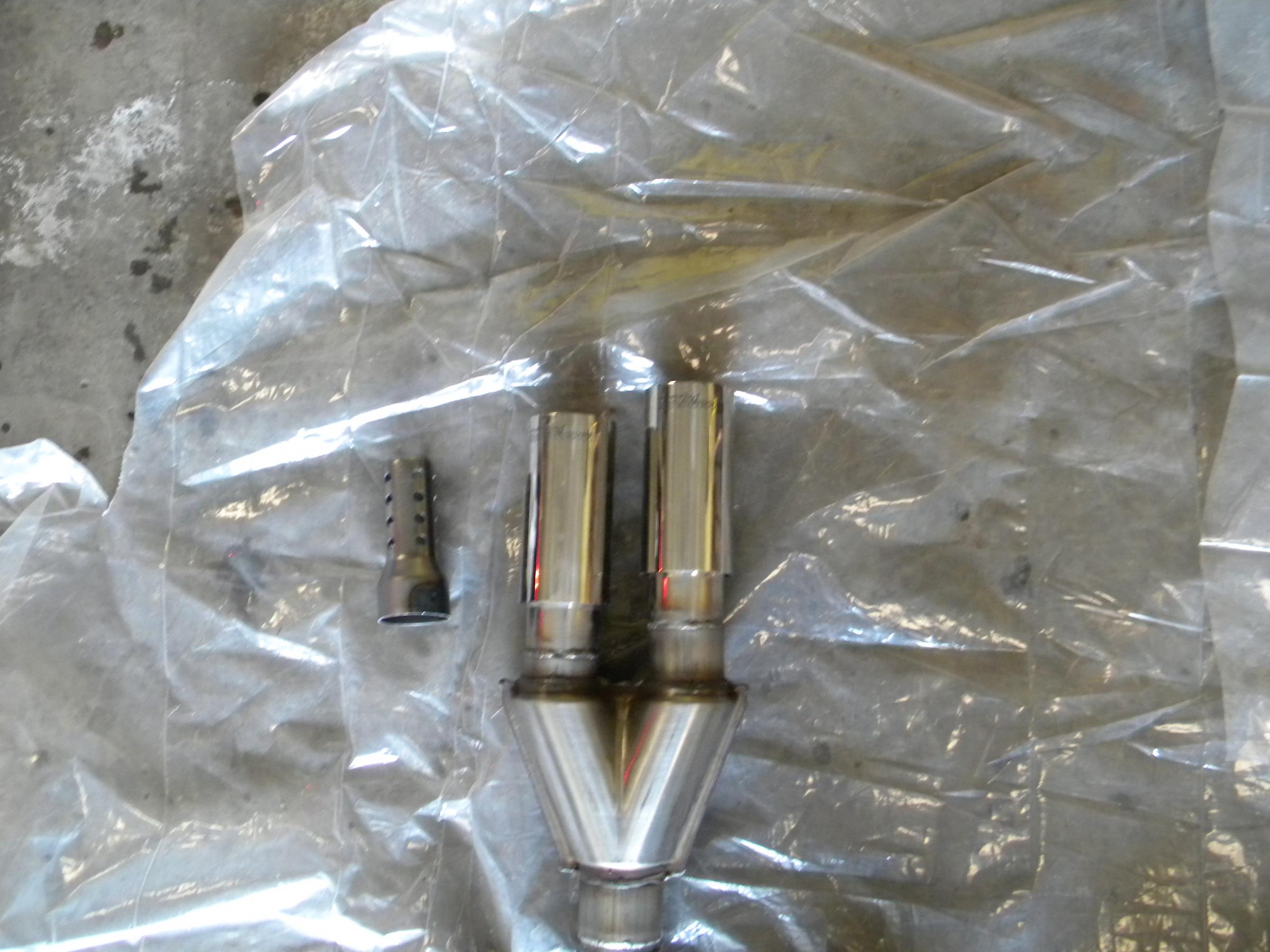

This is a new system that I designed in order to get more of a deeper growl out of the xkr. If you notice in one of the pics you can see that I went from the stock size pipe up to pipes that are 2.5 o.d. This was great for gettign me maniac mid-range and hi end but it really sucked when I was coming off the line. If you notice there arent any mufflers or resonators here, there by providing scant back pressure. Cause I had little back pressure this is why, I believe I lost a lot coming off the line. both of the tips on each side go into a magnaflow collector. 2.5 in and dual 2.5 out. I didnt want to junk this set up so I went and got 2 Vance and Hines motorcycle baffles to weld into the inboard side of the tips. The baffles are2.5 o.d. and go down to 1.75 with a perforated sleeve. I know it will work cause I stuffed both baffles in the pipes backwards from the back and held them in place with wadded up fireplace wrap. All I wanted to do was test them a couple times and it worked.!! Both gave me enough backpressure coming off the line 2 times until I blew them out the back end . The sound was also unconcious with these in there. My boyfriend helped get me someone to weld this system for me that was more than patient. Only downside to this was I had to keep on taking the system apart in order to get correct measurement befor everything was welded together.
Attached Thumbnails Designer exhaust system with cachet-dscn1409.jpg   Designer exhaust system with cachet-dscn1411.jpg   Designer exhaust system with cachet-dscn1412.jpg   Designer exhaust system with cachet-dscn1413.jpg   Designer exhaust system with cachet-dscn1414.jpg
Designer exhaust system with cachet-dscn1406.jpg   Designer exhaust system with cachet-dscn1408.jpg

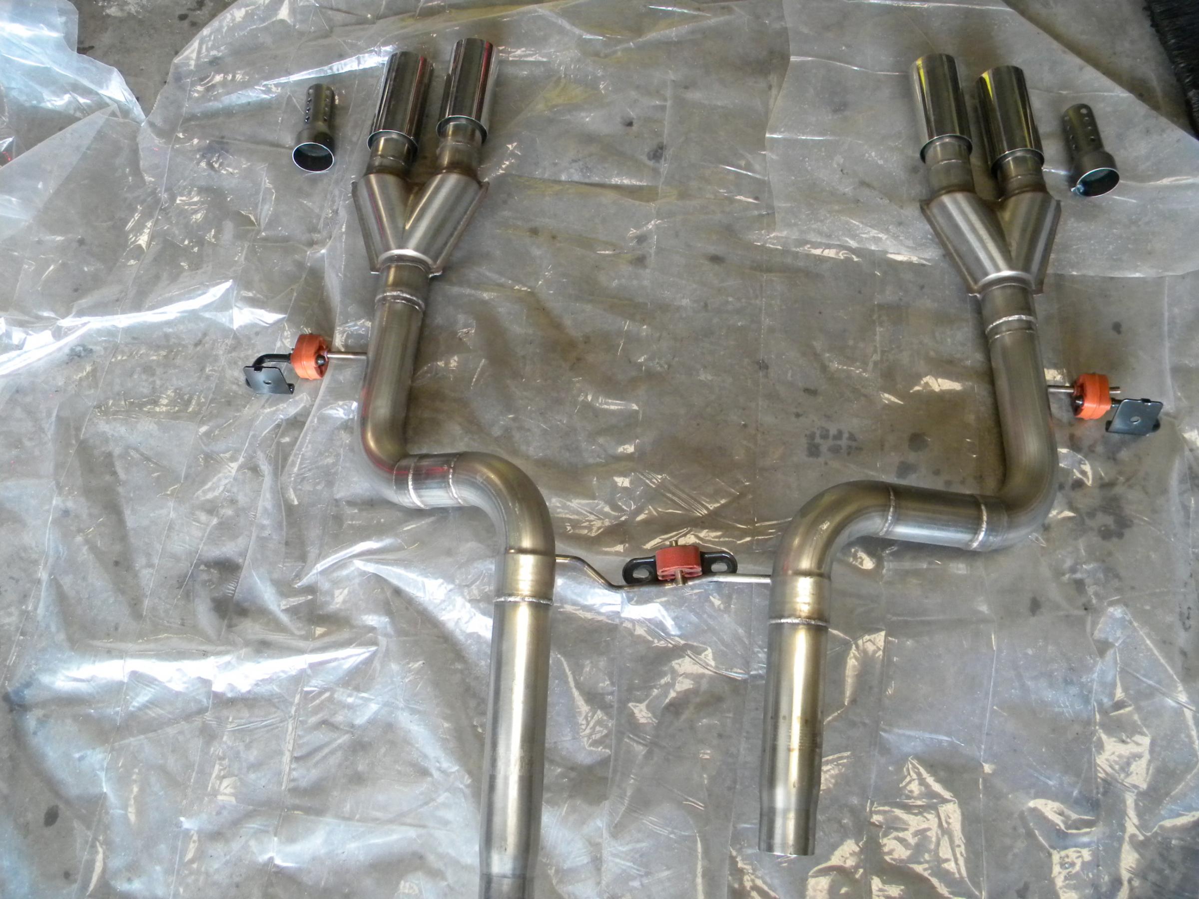

These pics are also part of that system
Attached Thumbnails Designer exhaust system with cachet-dscn1416.jpg   Designer exhaust system with cachet-dscn1415.jpg   Designer exhaust system with cachet-dscn1417.jpg

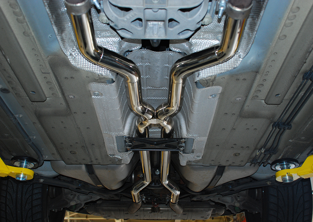

Looks to be a cool setup. Can you take pictures of your car from behind and kind of undernearth?
I'd like to put an X pipe and remove the resonator on my XK. Are there any pre-fabricated available on the market?

I looked at the Fabspeed one, it's $1500, essentially what I did, just as functional just not as "pretty".
