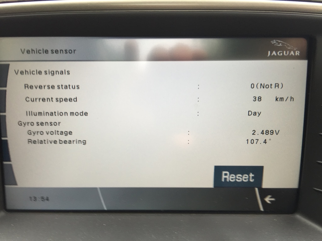

I know it isn't really what you are after but for the record you can display the speed digitally on the dash display as well as the touch screen
Attached Thumbnails Digital speedometer-speedo.jpg   Digital speedometer-touch.jpg

Many thanks to everyone on this. I'll see if I can find the Vehicle Sensor page hidden in the touch screen options. It seems amazing to me that the car can work out and display average speed fine digitally between the main clocks, but it can't show the actual speed. It's a great car though, so I guess a few quirks I can expect!

Just realised u102768 that in your left photo you are displaying the speedometer digitally between the clocks, which is what I was after doing. How did you get this up there?? Thanks.

It isn't something you would want to do every day but it is done by putting the instrument cluster in to diagnostic mode.
It is a bit fiddly but you press the trip button in for more than 5 seconds but less than 8 then momentarily press the start button. It took me 4 or 5 attempts to get it to work but when successful the message ENGINEERING TEST MODE appears. You can then cycle through the various tests available.
You can see the various things displayed and tests done here:
The Vehicle Sensor page is on the touch screen diagnostics. You can get in to that by selecting the sat nav then pressing and holding at the top middle of the screen until a numeric keypad appears. There are three different screens available:
660 - Diagnostic Menu
661 - System Check Screen
662 - GPS Information Screen
The screen shot I posted earlier is in the first one. Don't select 'Loading' because it tells the sat nav unit to try and load new firmware!
