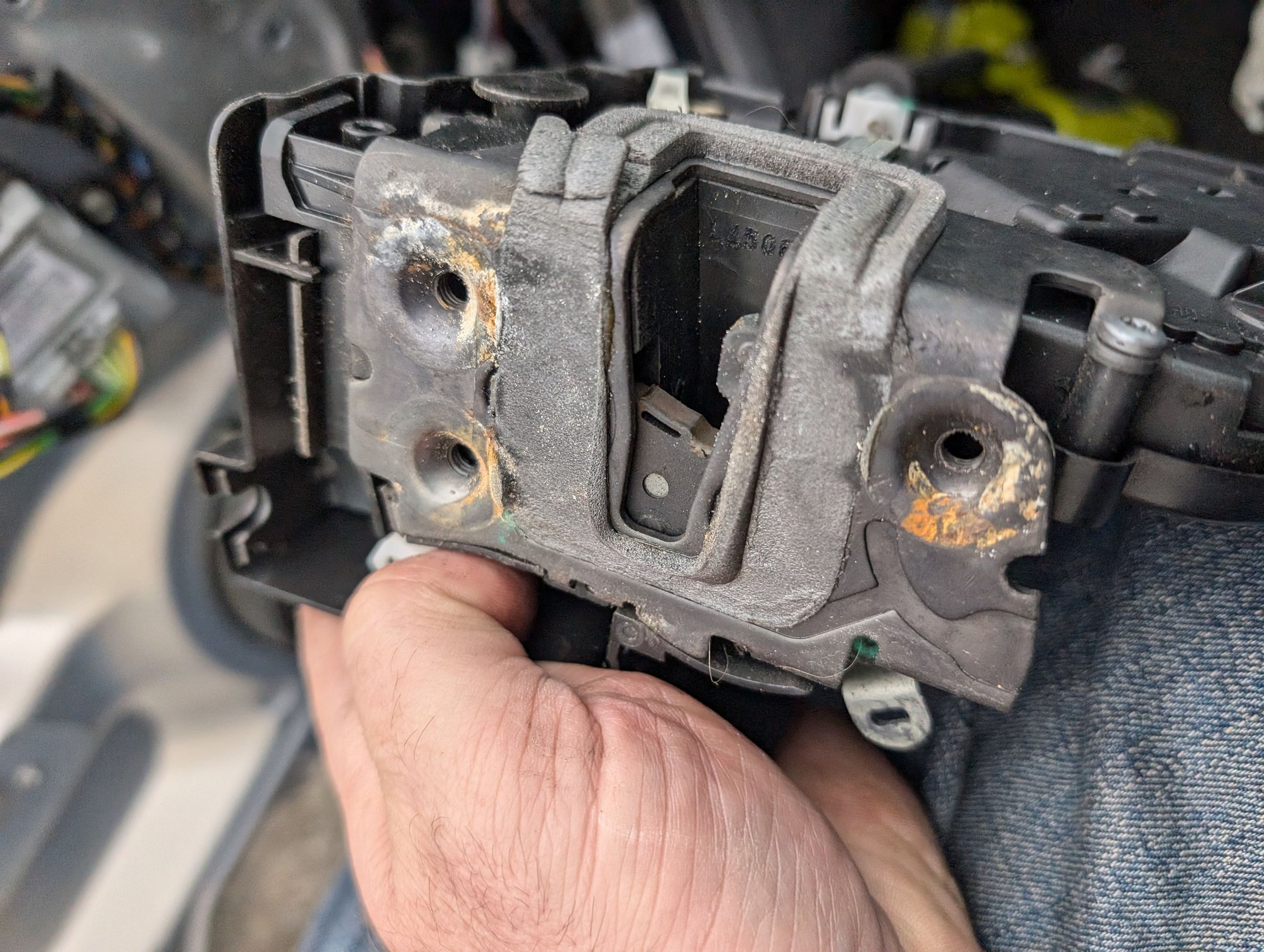

complete old door lock assembly

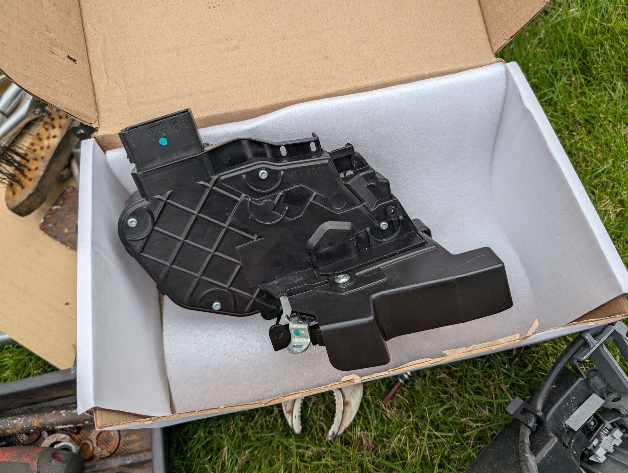

new door lock module

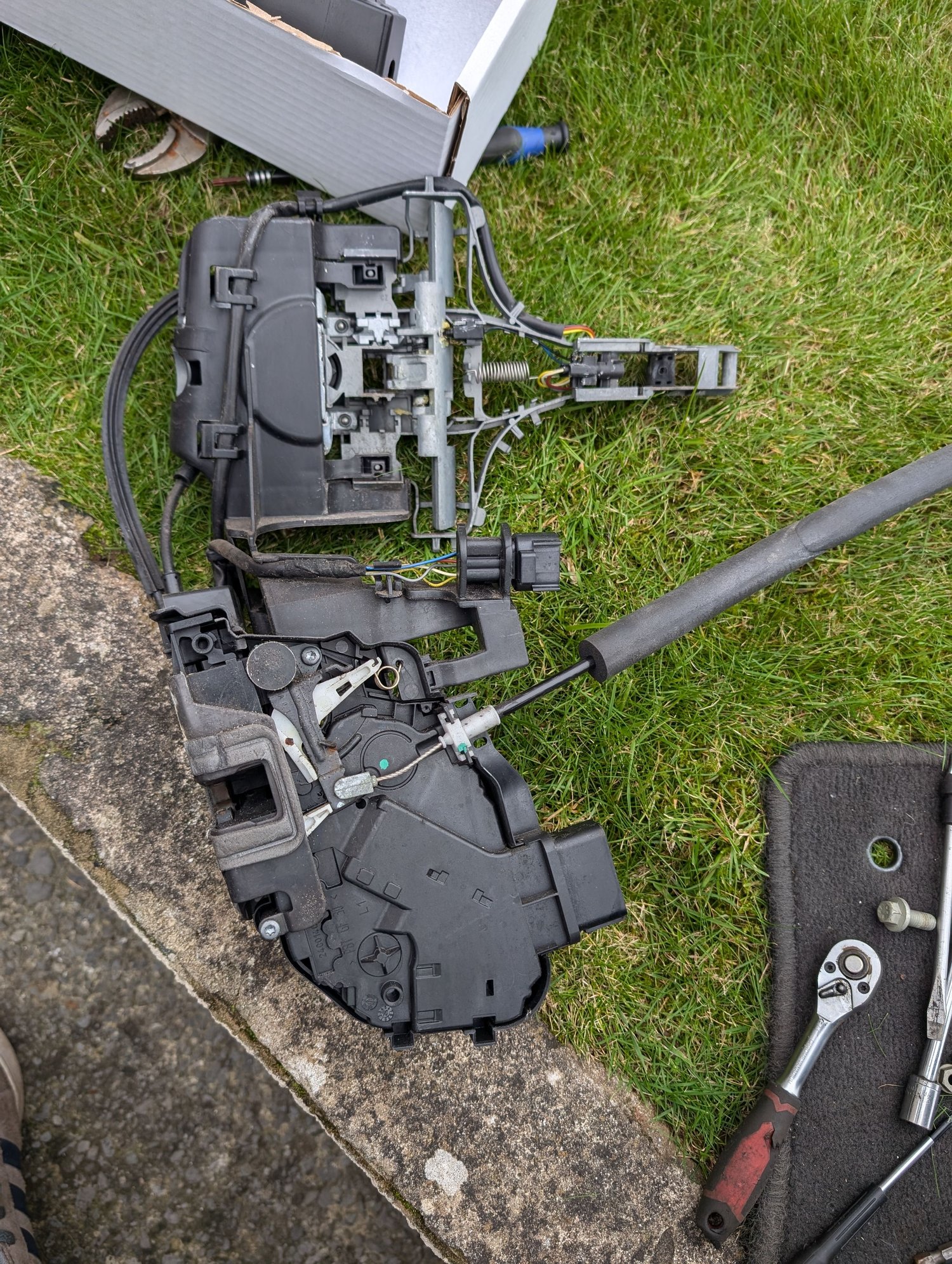

old door lock module

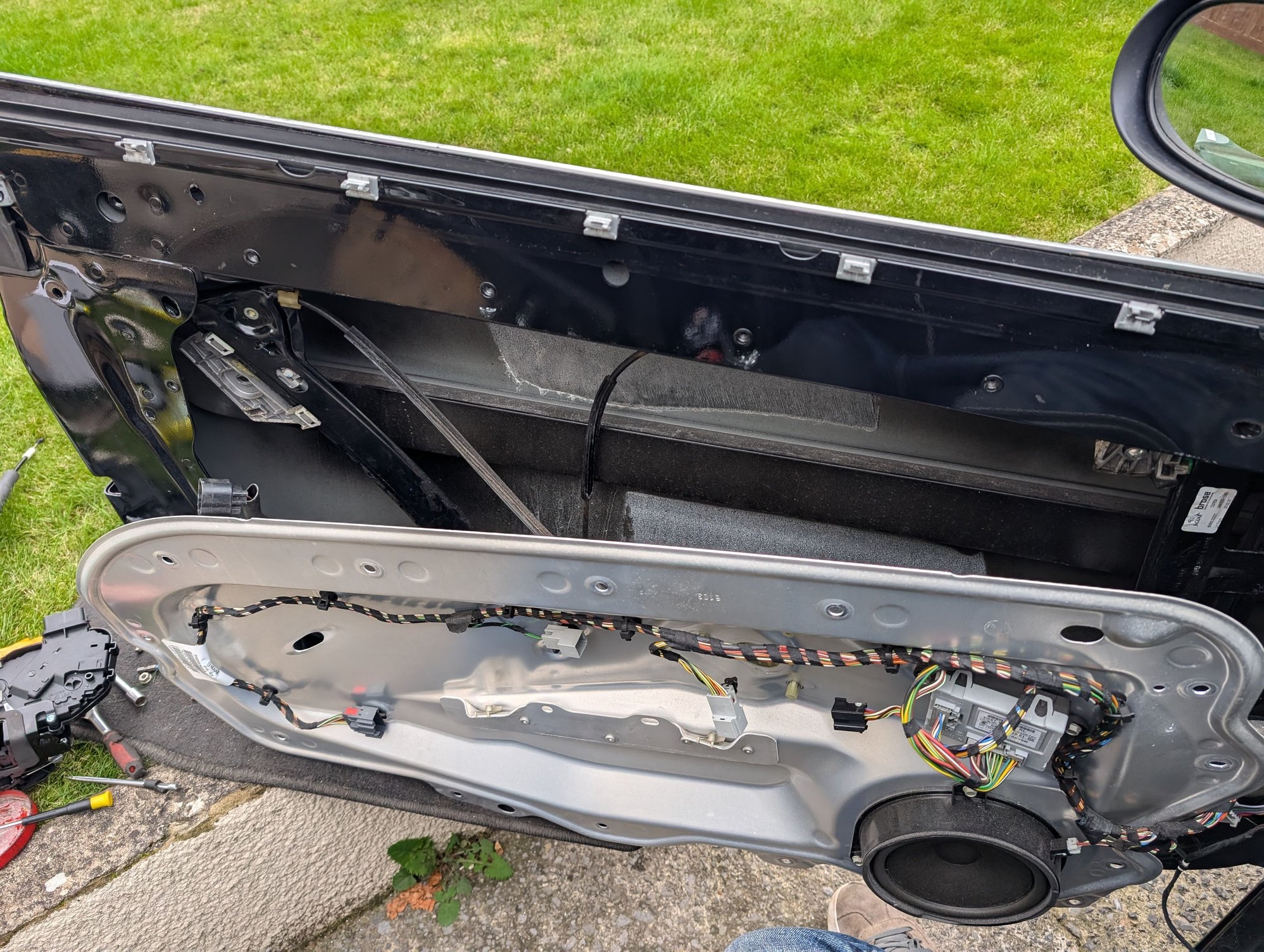

door panels speerated and the glass lift rail on the one side unbolted and the door glass removed for removal, not mentioned in the manual!!
the glass in a safe place away from me!!
