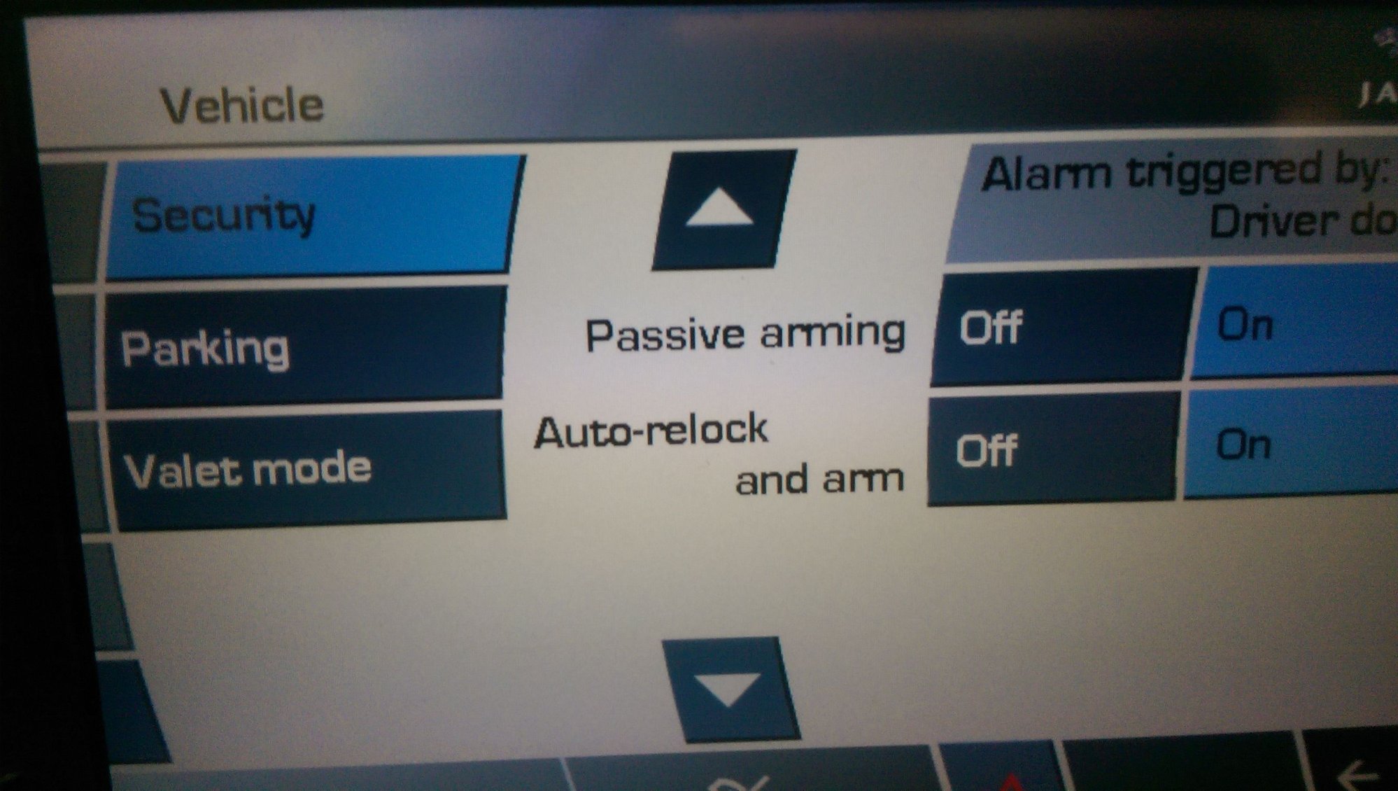

I don't know about you guys, but here's mine, second page of Security under Veh, Settings... When ON, my doors lock and alarm on after about 5-8 minutes. OFF, nothing happens.

Cee Jay -
What car do you have - make model, and year.
That picture you sent is NOT on my Security panel as an option.
Thanks for the heads up though.
Then I think there's something wrong. Passive arming applies to the alarm only, and occurs within a few seconds after you exit the vehicle, independent of whether it's locked.
Auto relock controls the feature that relocks the car after 20 seconds only if you do not open the door after you unlock the car. This feature is common on many cars now, including both my VWs.
If you open the door or mess with the car in any way it should NOT re-lock automatically, and certainly not after 5-8 minutes. If your car does that I think that's not right.
But anyway, all this is moot for you, Portman if (as Clevername says) it was not a feature on the 2007. I have the 2010 and I believe Cee Jay does also.

So maybe I have the same "problem" that portman has, but I consider it a feature. It works OK for me. Mine does the same, will relock if the door isn't opened after 20-30 seconds. BUT, mine ALSO locks about five minutes after the door HAS been opened and closed again if the START button has not been pressed. It has caused me to go get the SmartKey after I put it away, but I'd rather have it Lock by itself than UN-lock by itself.
Yes, mine's the 2010 XKR, pretty much optioned-up.
