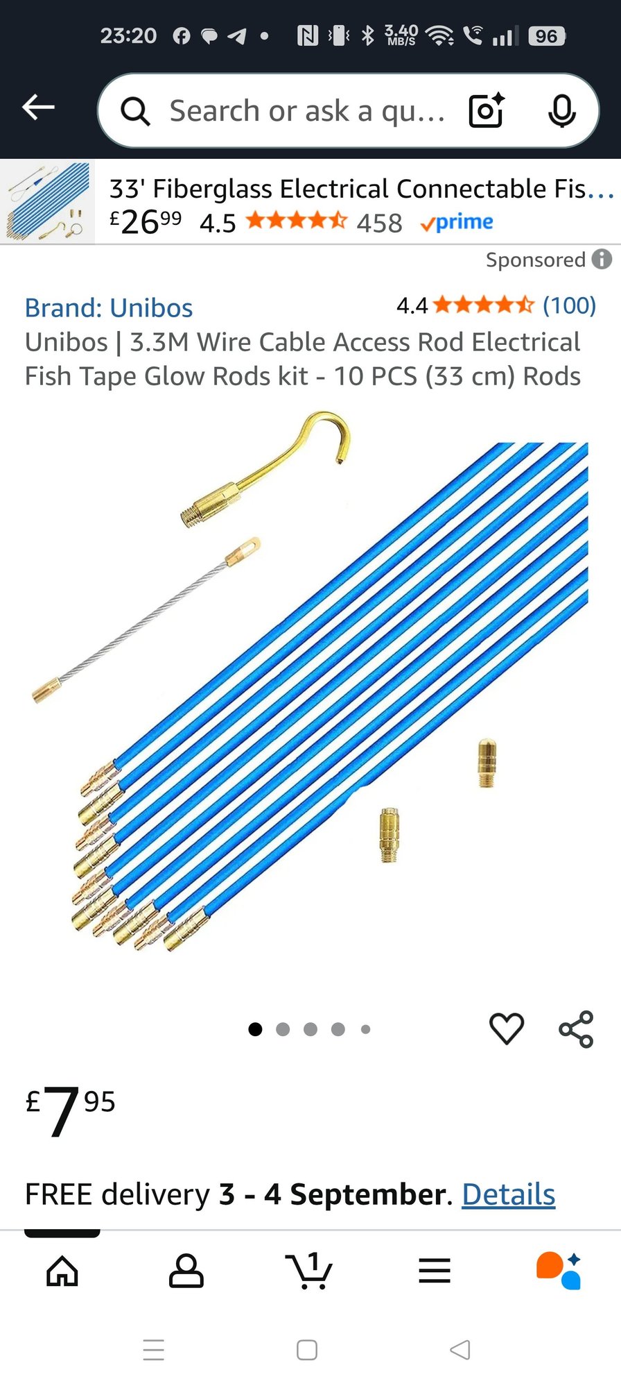

I'm trying to get my head around this pipe...
Can you use these to pull a new pipe through the old one? Cut out the end near the SC / bonnet side and jab these rods into the old pipe until they exit at the other end? They are flexible..
Tigrezy, 33cm x 10pcs Electric Wire Puller Set of Fiberglass Rods, Retractable Installation Kit for Cable in Plastic Housing

Yes I guess you can. I do have a set of these rods that I use for electrical work.
I did not try them, but I suspect they may be tough negotiating the tighter pends in the pipe.
I could try to feed mine through my old pipe and let you know ;-)
