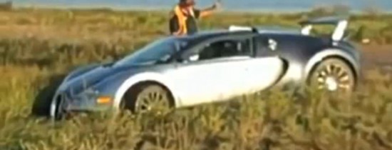

[small %, I bet the guy that drove his million $$$ Bugatti Veyron into galveston Texas shallow bay waters didnt read that it wasnt ok to drive into water either
Cheers[/quote]
Just proves again, that money doesn't buy common sense
